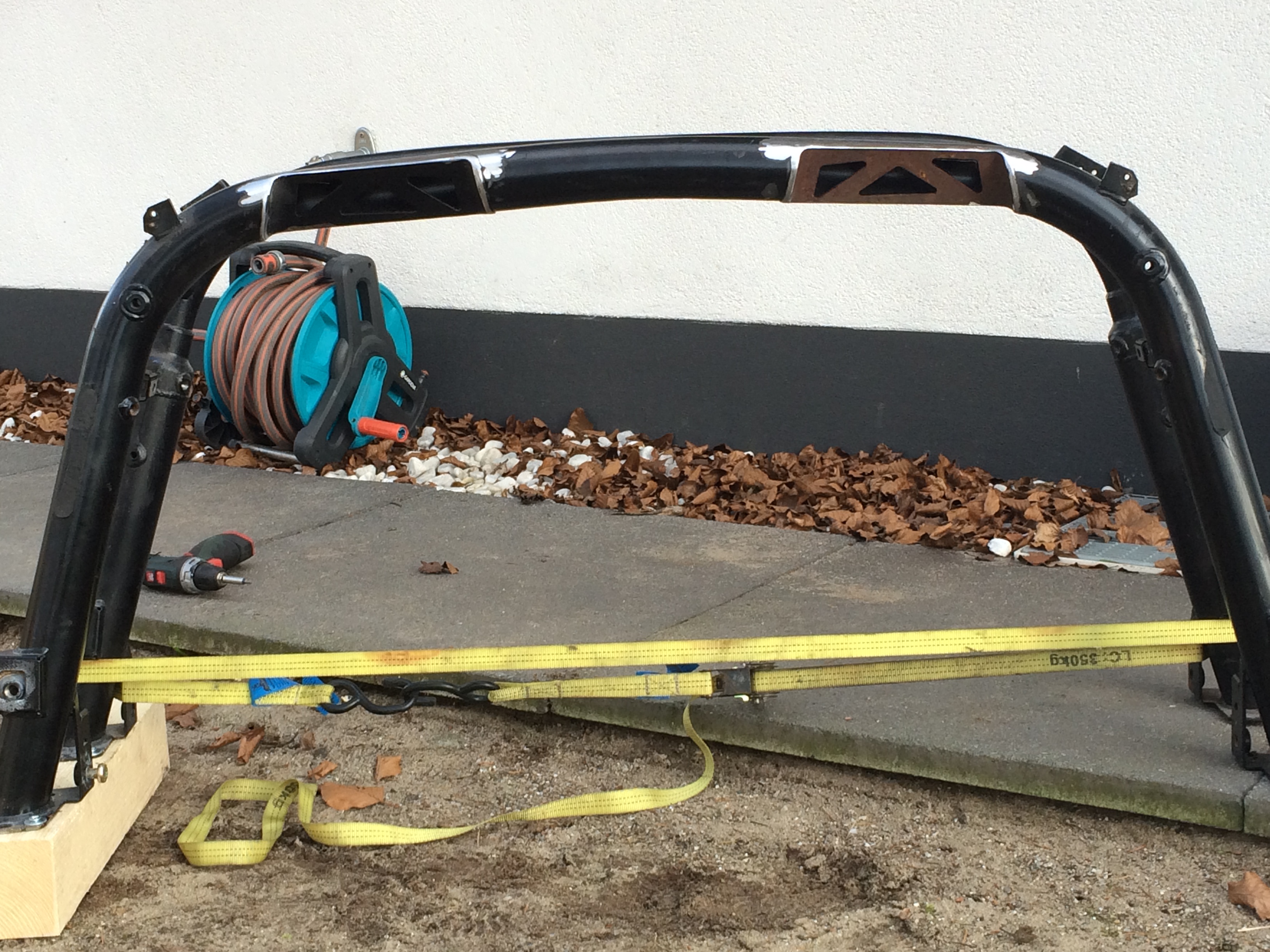

lol and behold... S2 roll bar doesn't fit. Mounting feet of the one I just received are about 20mm wider than the vx bar On the upside, the S2 bar does look like a good steel donor so I can beef-up the vx bar, add a harness bar etc
Do you mean that the plates/holes at the bottom are differently shaped and don't match with the holes in the chassis or that the hoop is too wide?
In the last case.. Umm.. Yeah.. That's often kinda normal.. People do have to sometimes put some ratchet-straps on these hoops to 'squeeze' them together at the bottom a little, then get all the bolts fitted and torqued down and then release the strap.
The main ali chassis is not sized any differently width-wise between the VX and the Elise(s).
Bye, Arno.

hoop is too wide. 20mm too wide :huh:
ill see if i can compress it a little, but im also looking at the rear support bolt flanges, and they seem to be a slightly different position too.
anyway, thanks for the tip, i hadnt imagined that an OEM piece would require that amount of man-handling, so assumed it must just be different

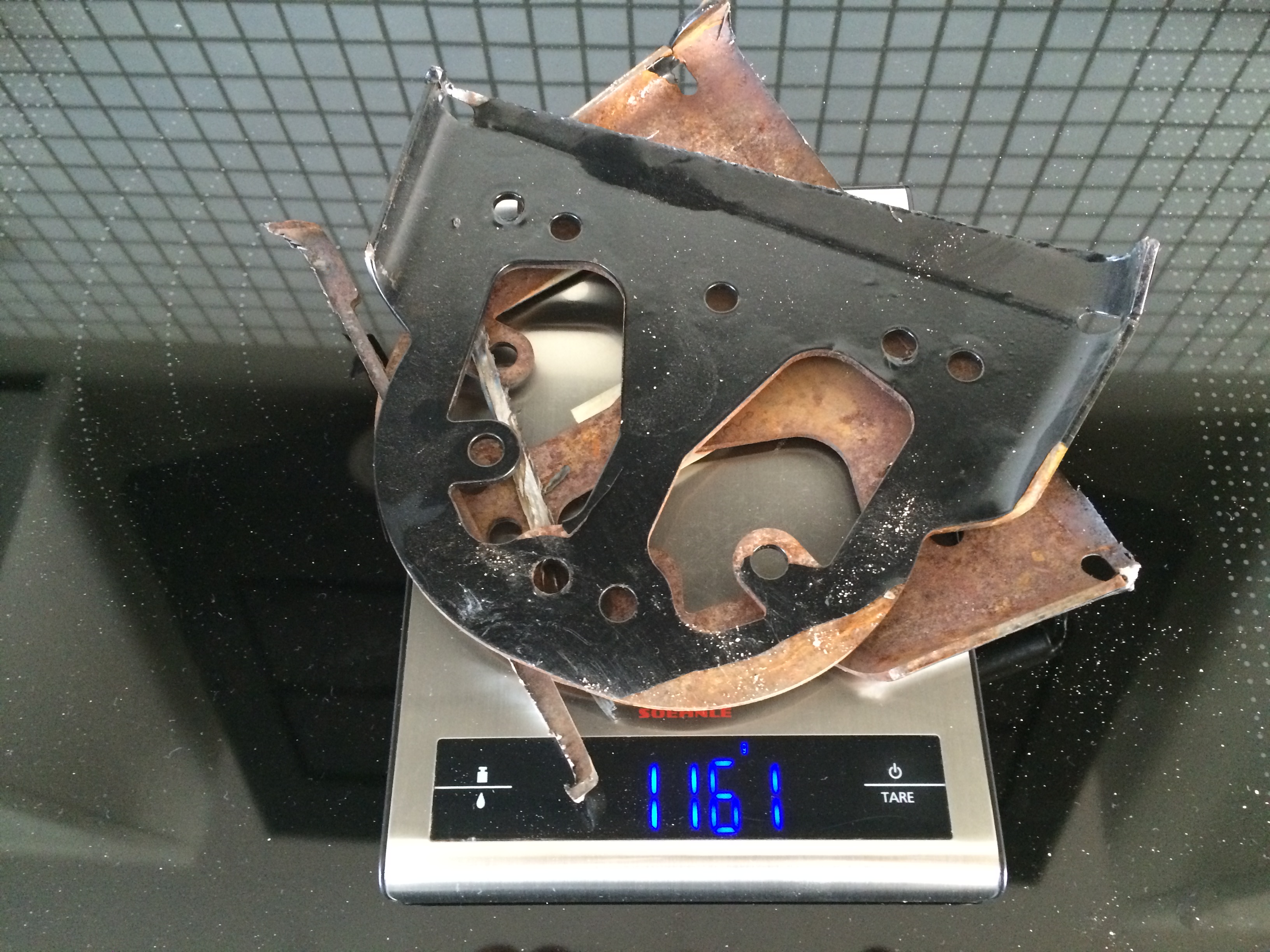

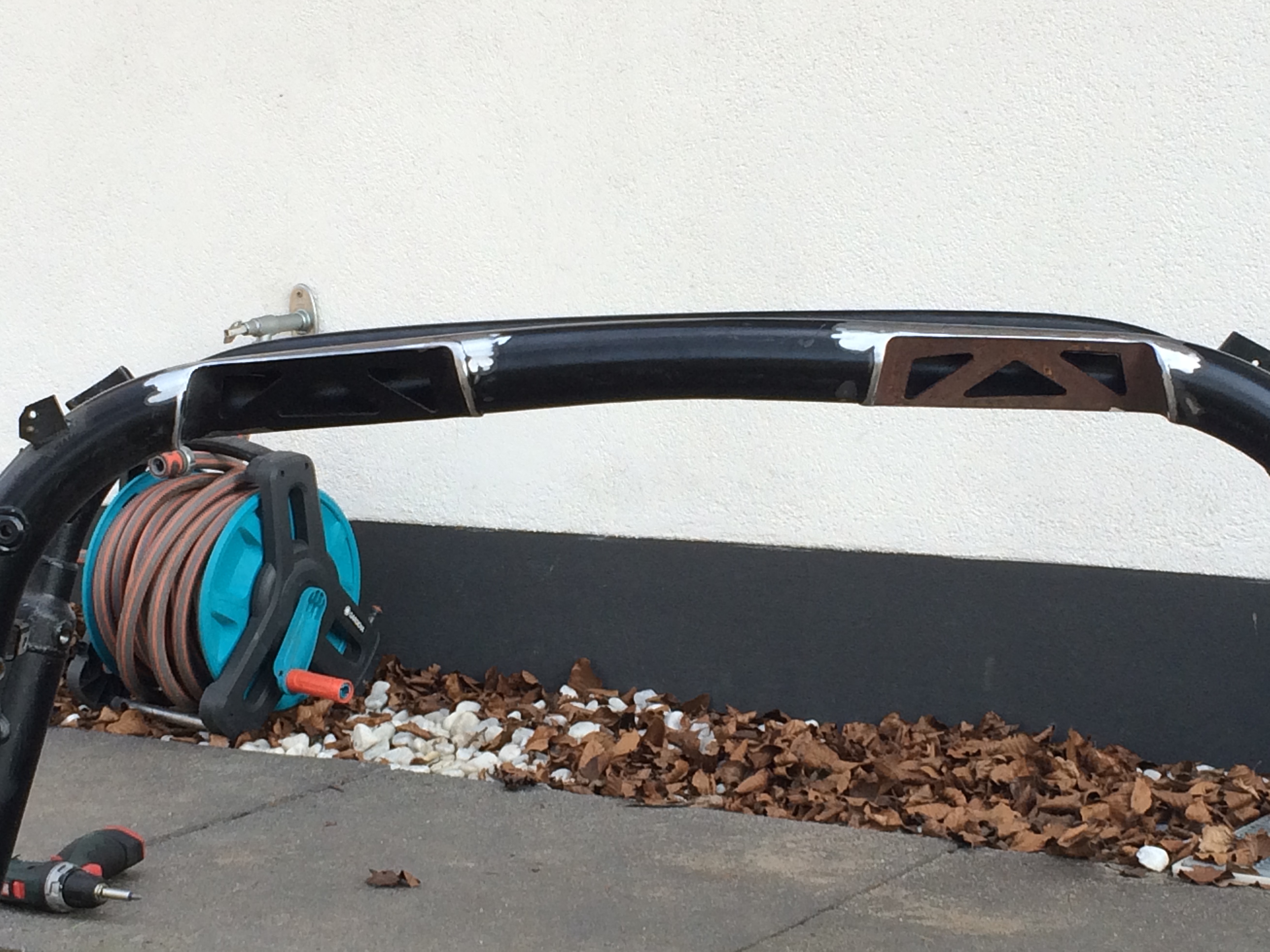

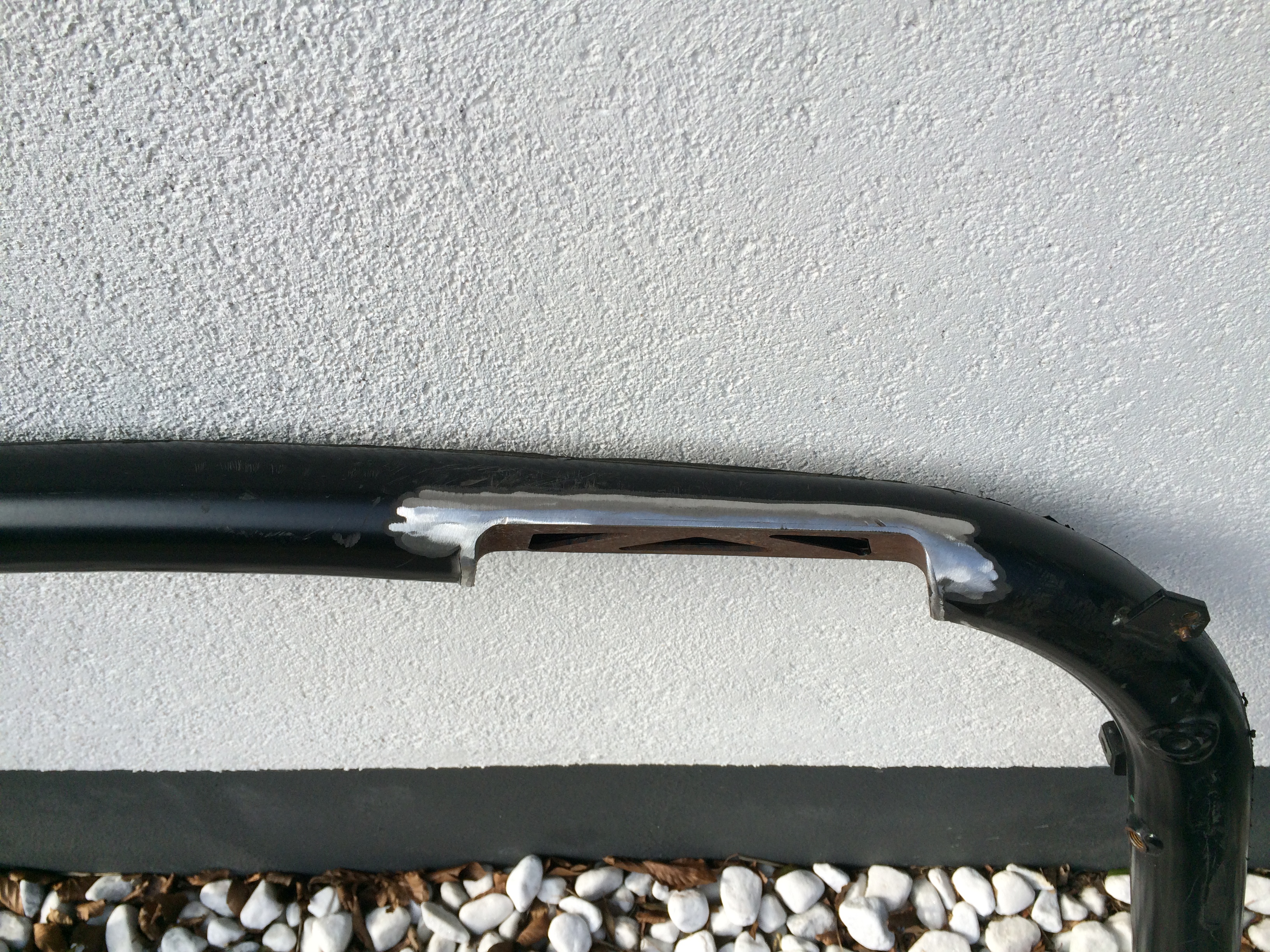

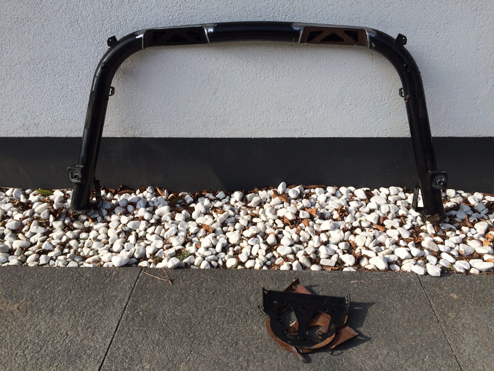

so a quick comparison...  :happy:
first up weights:
vx220: 7.9kg (including headrests)
S2 Elise: 6.1kg (complete)
(remember the headrests alone weigh 1.2kg)
and some pics of them semi fixed to a chunk of wood, and the S2 compressed with a ratchet strap (which after about 10mm of over compression, sprung back to the right width unassisted)
