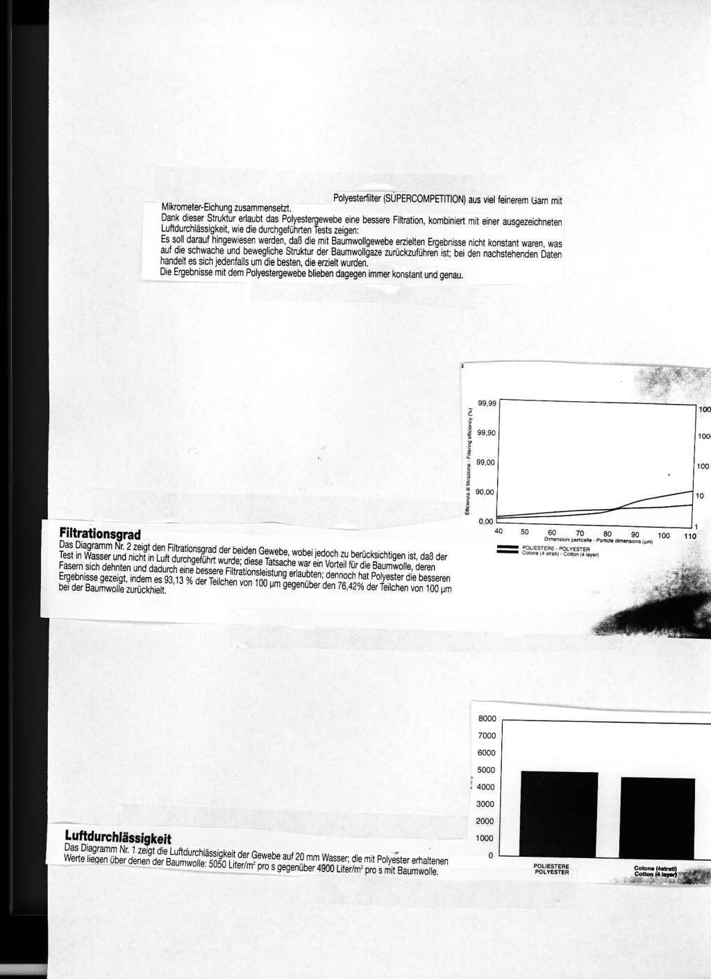

Hope you have more info with this link http://www.ts85.de/a...ion_(klein).jpg

Posted 29 January 2016 - 07:50 PM
Hope you have more info with this link http://www.ts85.de/a...ion_(klein).jpg My charger is only rated for MAX 420hp, so with 396 pushing out of it (still with an oem leh exhaust manifold) i think this is acceptable. For me, this filters flows enough for MY set up. Suppose for a Nipper set up , i also trow this one in the bin. Also, i clean it every half year (about every 2500 km) Intake tube is clean and not oily and that's what i want. Vmax Germany had also his doubt about this filter due to small. But i gained power with some simple add ons (rs4 lmm and 62 tb) and gained extra 20hp and +30nm). Same mapper,same rolling road, same time of the year. Think when this filter was restrictive, it showed less or none gains... But , the best filtering possible, is like yours or indeed the hardwick set up... I had this filter on my car when i bougth it in it's 324hp set up. Just upgraded it to an dry type for my 396 set up because i was happy with it. grtz

Nice to see some actual flow/particle figures (even though I can't understand the language). At least it shows the filter company paid some attention to the critical matter of what can get into your cylidners :)

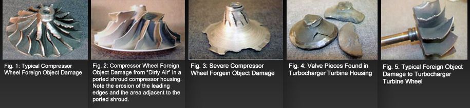

It's more the erosion damage to the compressor wheel. Race engines do not have filters and some do big mileages
#18 Nev
Posted 30 January 2016 - 10:38 AM
Thats dead true :(

I know, when putting performance filters on your car, the air sucked in, never will be as good like oem filtered air. I also understand this can happen to the compressorwheel ....
When my turbo's letting down, i upgrade to a better one. Probably duall scroll type's.
