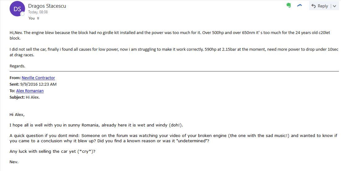

Sheesh, you can't look at a few still shots in video and draw a conclusion about an engine failure you know nothing about !
I was intrigued myself what might have caused it so I emailed him last night, here is his response:
So it seems you are quite wrong. :rolleyes:

Making incorrect snap presumptions like that with barely any info, hardly a scientific analysis was it?! Even though he is shown to be wrong he just brings up flack and never admits it.
I have no idea how that engine even survived to 300 BHP without a girdle. Now that I know that it didn't even have one, it is pretty damn obvious that would cause a problem, nothing to do with a seized piston.
