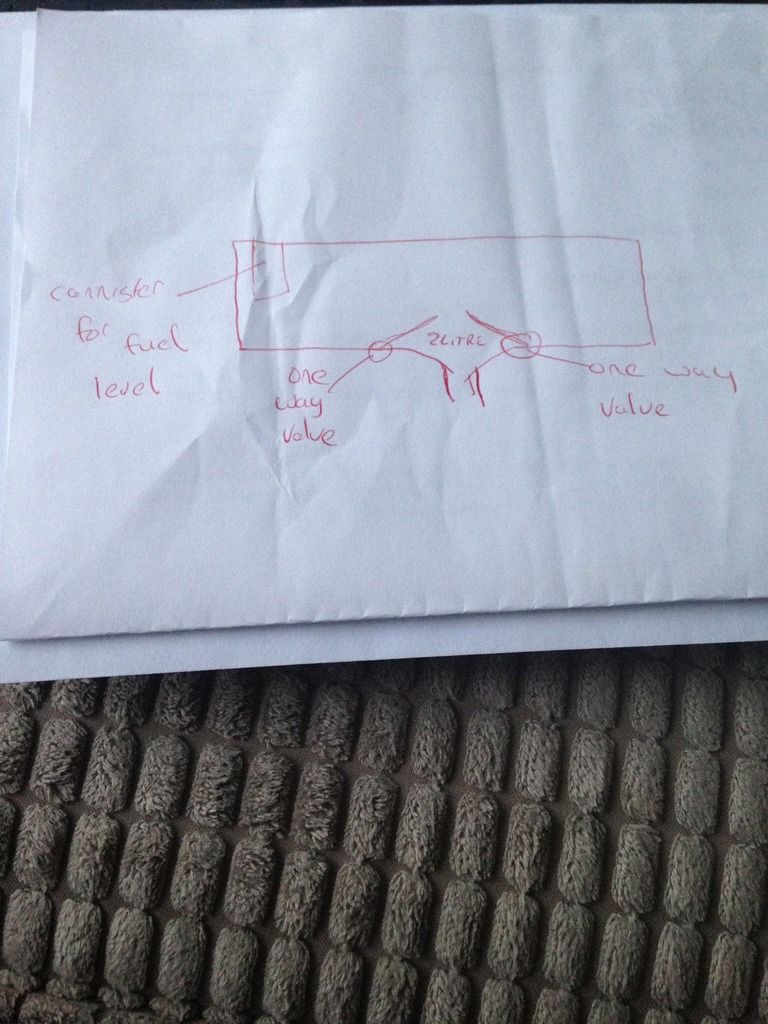

The original vx baffle allows fuel to come round either side (like pro alloy) along with a big hole in the top half of the section and smaller holes in the bottom Which is why I'm struggling to see why a half angled baffle plate would work better
I'm not familiar with the OEM fuel tank baffle or even the Pro-Alloy baffled tanks so can't comment.
I'm just saying that a plate baffle is a viable solution, though I have no idea if is better or worse than the OEM or current Pro-Alloy solution.

If I was designing a tank I would want a centre bottom coll croft like this
With external pump

A ramped baffle as above can work very well.  I did a similar thing in my old Formula 4 car.  Used a ramp in a bit of an internal pot where the fuel pick up was.  put a few small holes at the bottom of the ramp (one way valve would be even better).  It captured fuel so well that when I ran out it just stopped completely.
I think the primary issue with our tank is its long and skinny and the pump pickup is on one side.
I'm going to send a note to Holley to ask about the connection fitting to the pump and see if they have any options.  Also to see if they can do a different shape.  If a hydra mat was shaped like the bottom of our tank it should pick up every last drop.  Does anyone know how long our tank is internally from end to end?  or from pickup to end?

They don't do custom sizes, but will be producing more sizes in the future, but they don't have dates when. I was thinking for our tanks a long thin version that fits directly to the pump would be great.  The fittings cannot be specified, they only make whats on the website.  So there is only one version that would attach directly to a normal in tank pump, but that's not really the right shape (not long enough to go to the other end of the tank).  But he did say you can put adapters on the mats and create different configurations and fittings......
Thinking about that type of solution....  might be two of the 8x3" mats ($139x2), one on each end of the tank, with some associated tubing and couplings (maybe $50?) to link the two mats to the bottom of the pump.  Something like the following video at about 45 seconds in.
https://www.youtube....h?v=xuAlS3W90LI
As I see lots of pictures of modified tanks out there... I'm not sure what our tanks start with.  There must be some basic baffles in the OE tank I would hope?  Does anyone know what the OE internals look like?   To do something like the above might work effectively but would have to get around any stock baffles.  In the end, I'm not sure its worth it for a $400 US ~£300 solution which would end up a bit of an assembly any way.  If I was running an eternal pump, or they had a mat that fit out tank better, this might be a great solution however... decisions, decisions.

The oem tank is just a square box.
They are cheaply available, as lot's converted to a pro alloy one.
Maybe take a whack at one putting in your own baffeled system?
#58 The Batman
Posted 31 January 2017 - 09:50 PM
Oem tank has a similar baffle to the one I posted photos off There is a big hole towards the top, 2 smaller holes at the bottom and fuel can flow down the sides of the baffle aswell (From memory!)
