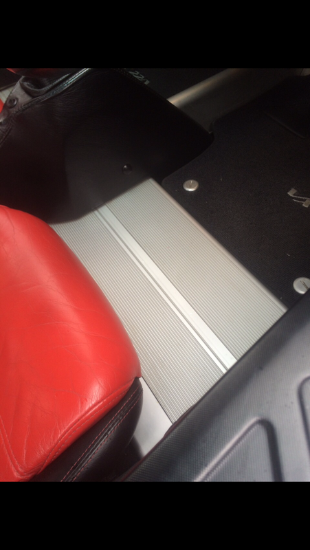

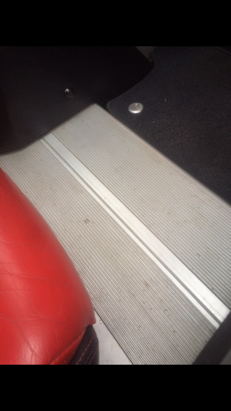

Posted 07 February 2017 - 06:27 PM
It comes up well with Bilt Hamber Surfex HD which is a really good degreaser
Great, thanks. Do you use an electric polisher or something?
Nope, just a microfibre cloth to wipe it off with.
For the grooves on the chassis next to where your seat is I use a brush attachment from a vacuum cleaner (attached to the switched on vacuum cleaner!)
Here's a before and after:
