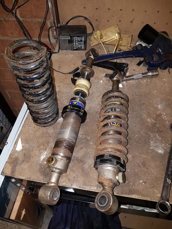

bought a second hand set of gaz coilovers. there is corrosion on the springs and a bit on the struts themselves.
anyone repainted these? do the springs come apart from the struts without much hassle?

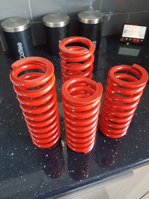

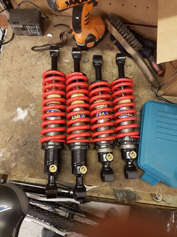

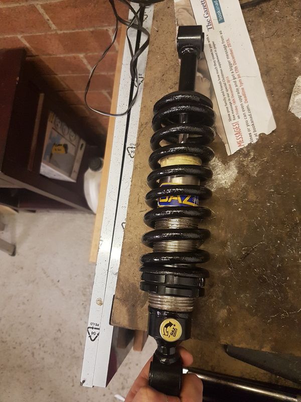

right thought id follow this up with an end result!
attacked the top and bottom of coilover units with black plastikote, the myth you read online that coke cleans all the rust away is bollocks, made no difference. i was initially tempted to do it all including the threads but decided against except for the lower part of the larger one which you could see had took a bit of weathering below the adjuster
springs i tried with the same paint at first, the result was better than current state but you could see visable marks of the rusting underneath
i found a local powder coaters who did the springs for £40. results are perfect and like new
just need to get them fitted now!!
