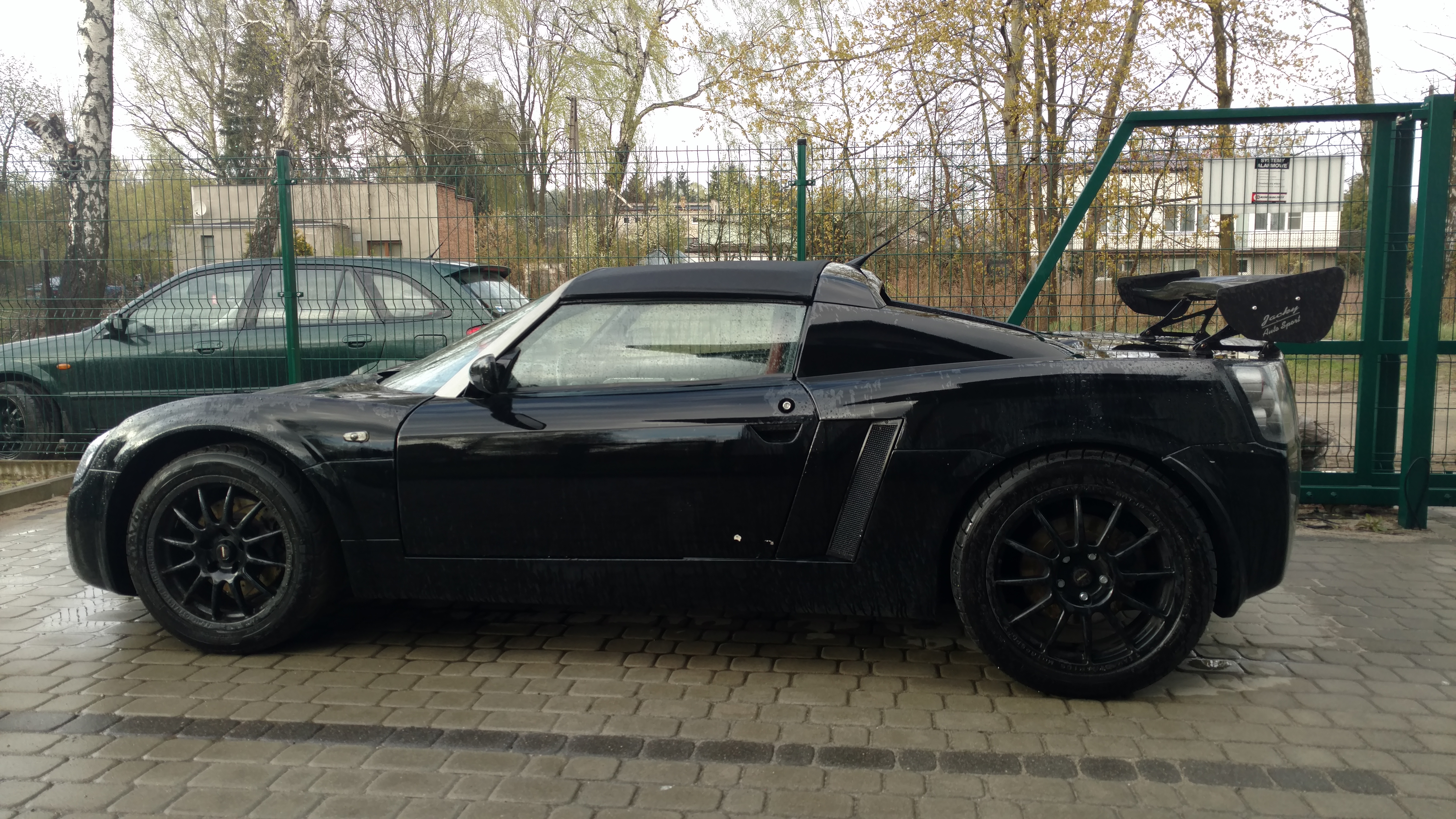

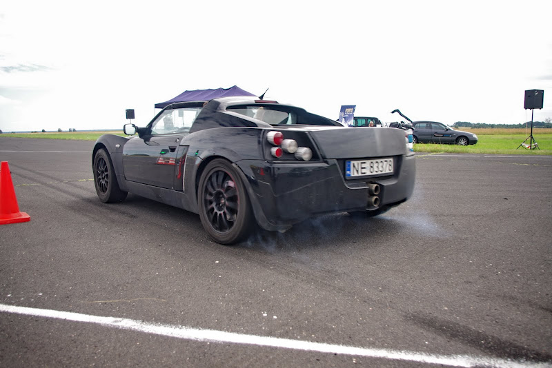

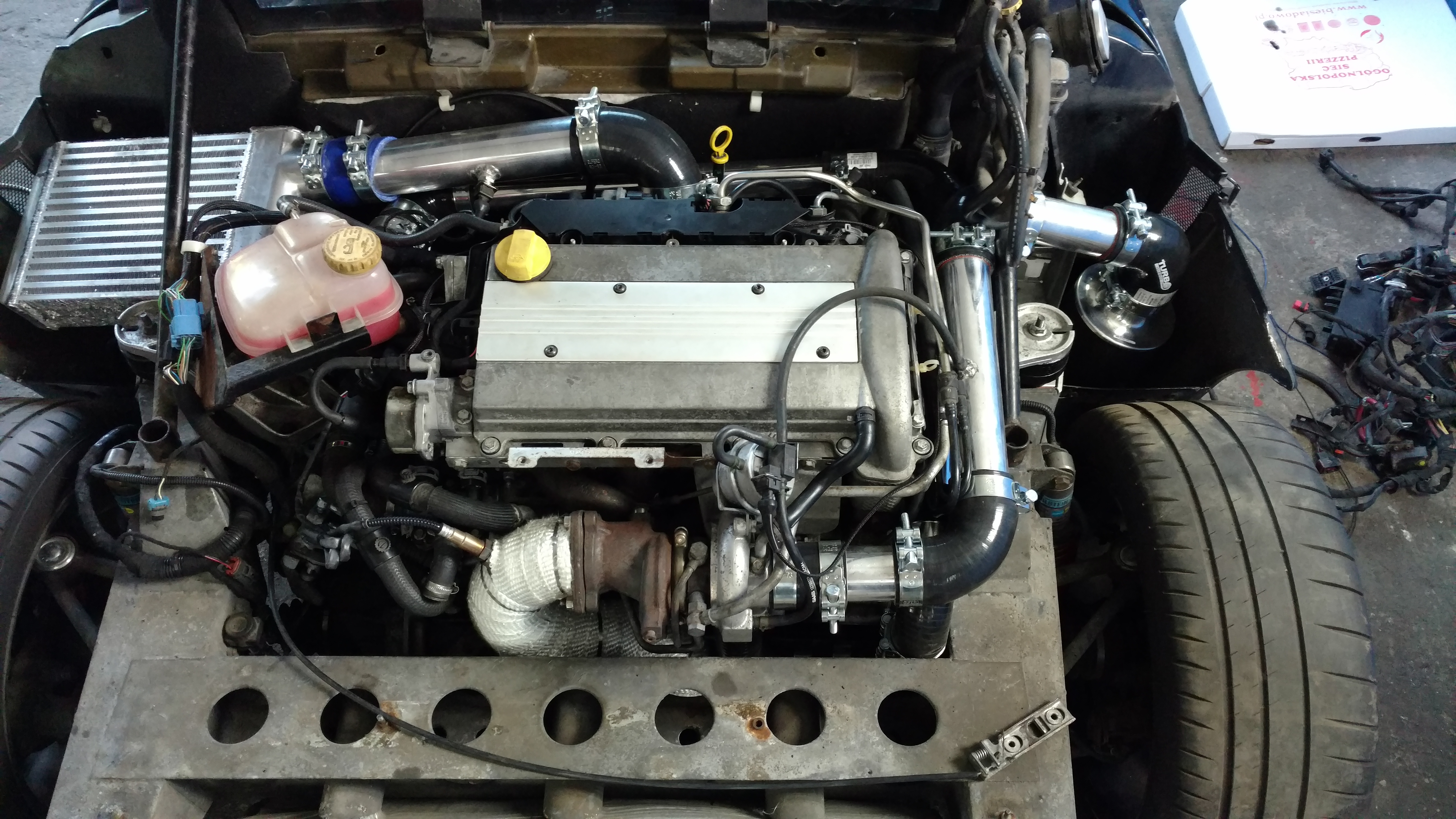

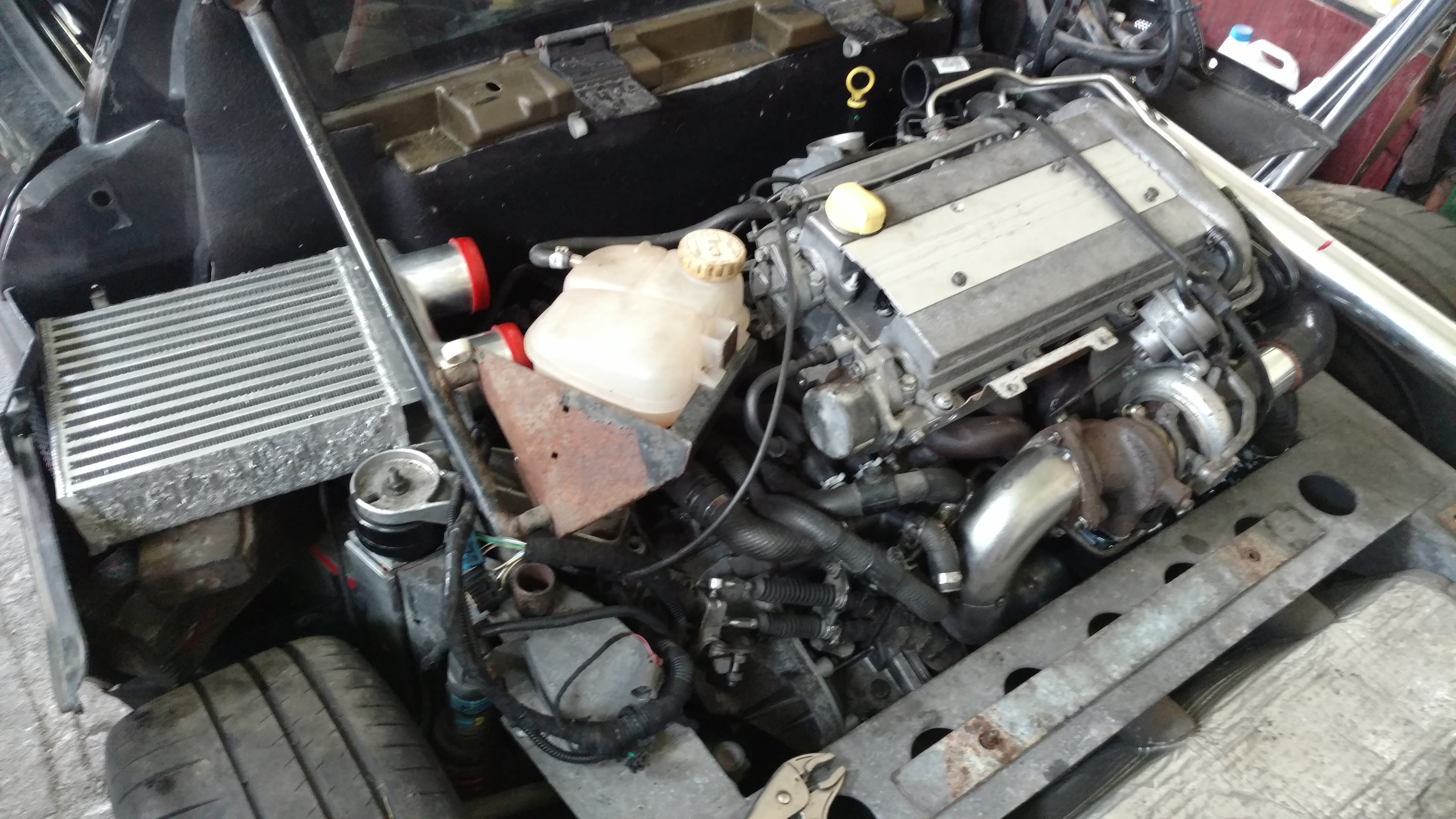

Hello
I wanted to introduce my car
photos:
on the track:
1. http://www.mazdaspee...43720&mode=view
2. http://www.mazdaspee...38002&mode=view
3. https://lh3.googleus...0465-MOTION.gif
4. https://lh4.googleus...0393-MOTION.gif
5. https://youtu.be/ZhyGC3jSvik
in progress:
6. http://www.mazdaspee...00306&mode=view
7. http://www.mazdaspee...42591&mode=view
8. http://www.mazdaspee...42592&mode=view
9. http://www.mazdaspee...42650&mode=view
10. http://www.mazdaspee...42652&mode=view
11. http://www.mazdaspee...42653&mode=view
12. http://www.mazdaspee...42654&mode=view
13. http://www.mazdaspee...42657&mode=view
14. http://www.mazdaspee...42658&mode=view
15. http://www.mazdaspee...42988&mode=view

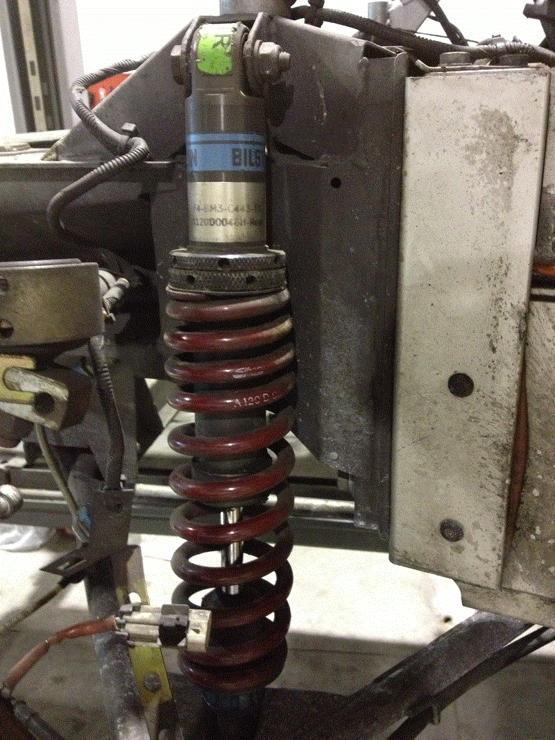

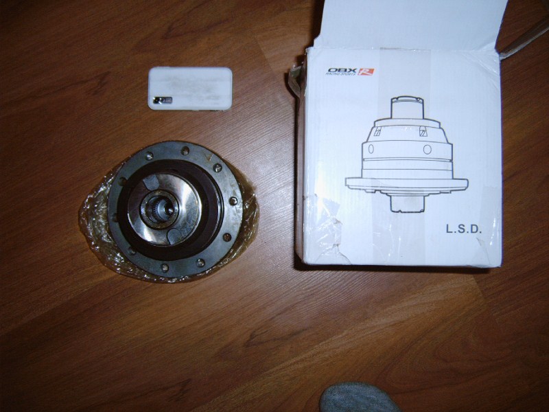

-rear suspension: lotus cup 255 bilstein A120D0046H; 371 lbs/in  (serial 268 lbs/in)
16. http://www.mazdaspee...13843&mode=view
-front stiffer serial bilstein with serial springs

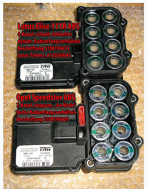

- lotus 4 channel abs
17. http://www.mazdaspee...12322&mode=view

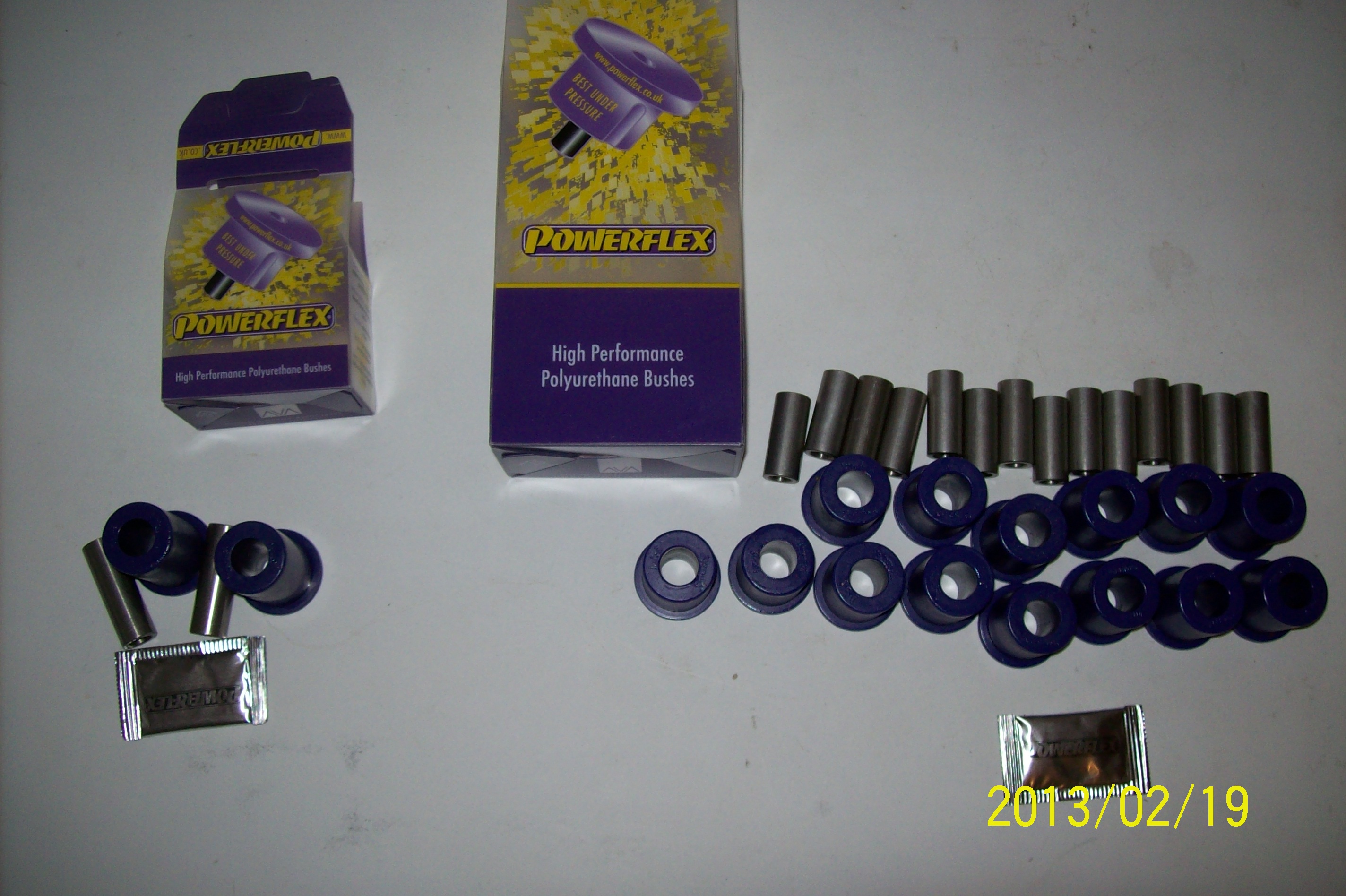

-powerflex in wishbones
-obx torsen
two wheels spin
-Team Dynamics wheels:

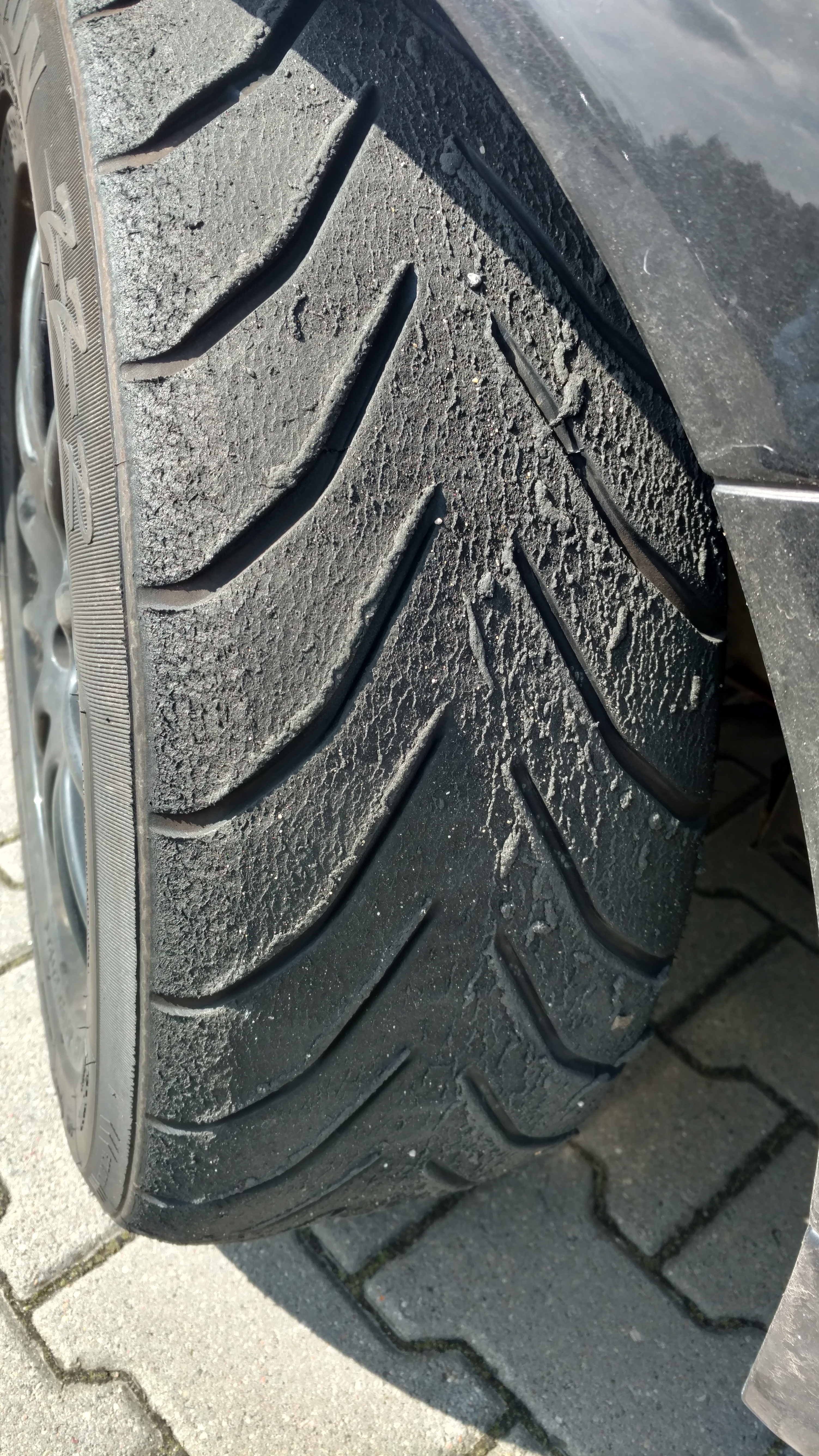

- sport cup 2 rear tires and avon zzr a24 front tores
-mikoda brakes discs
-engine b207r
-turbo td04HL-20T
-DV forge
-injectors Simens deka630

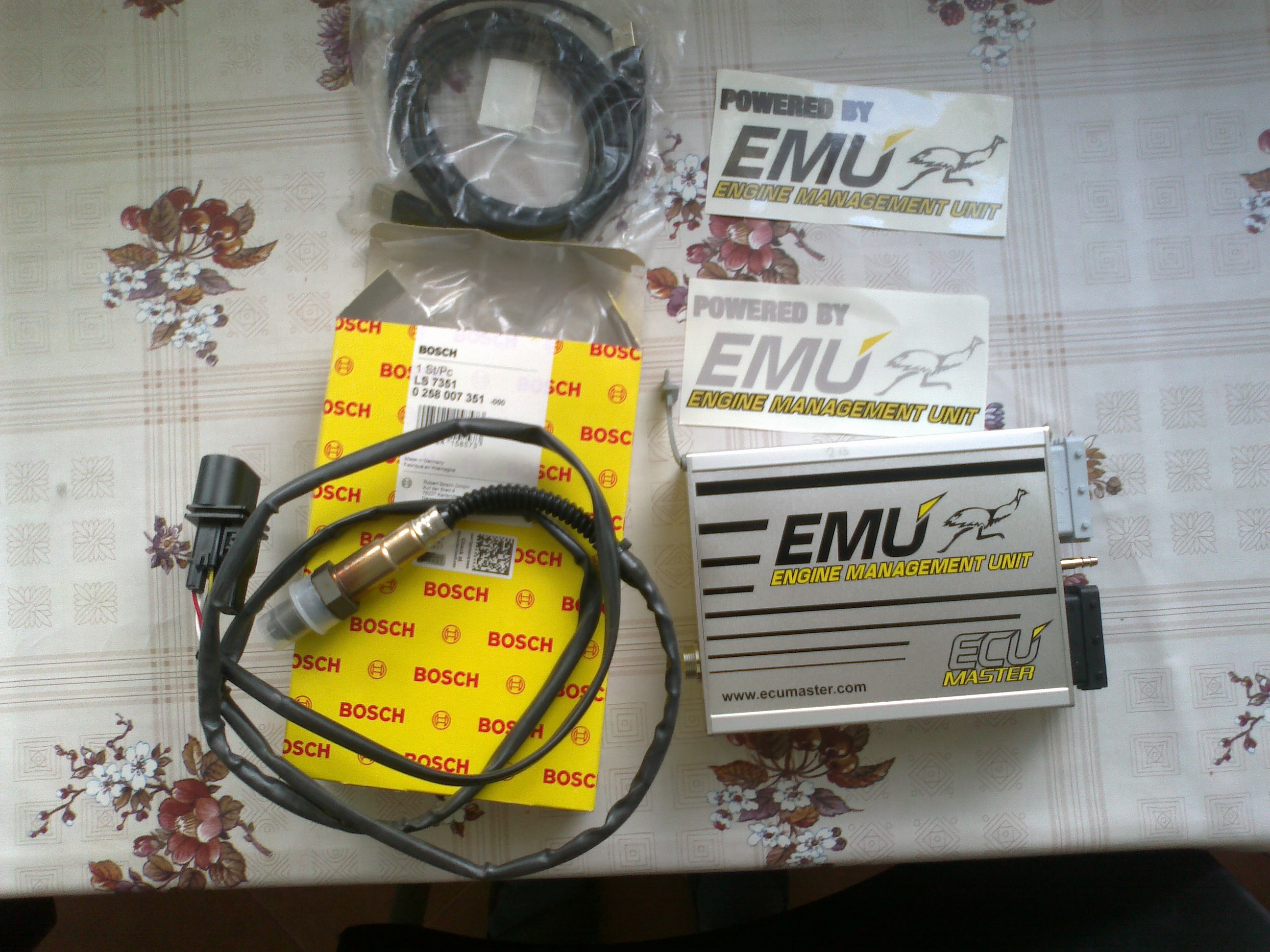

- Emu Stand Alone
-Home Made TCS

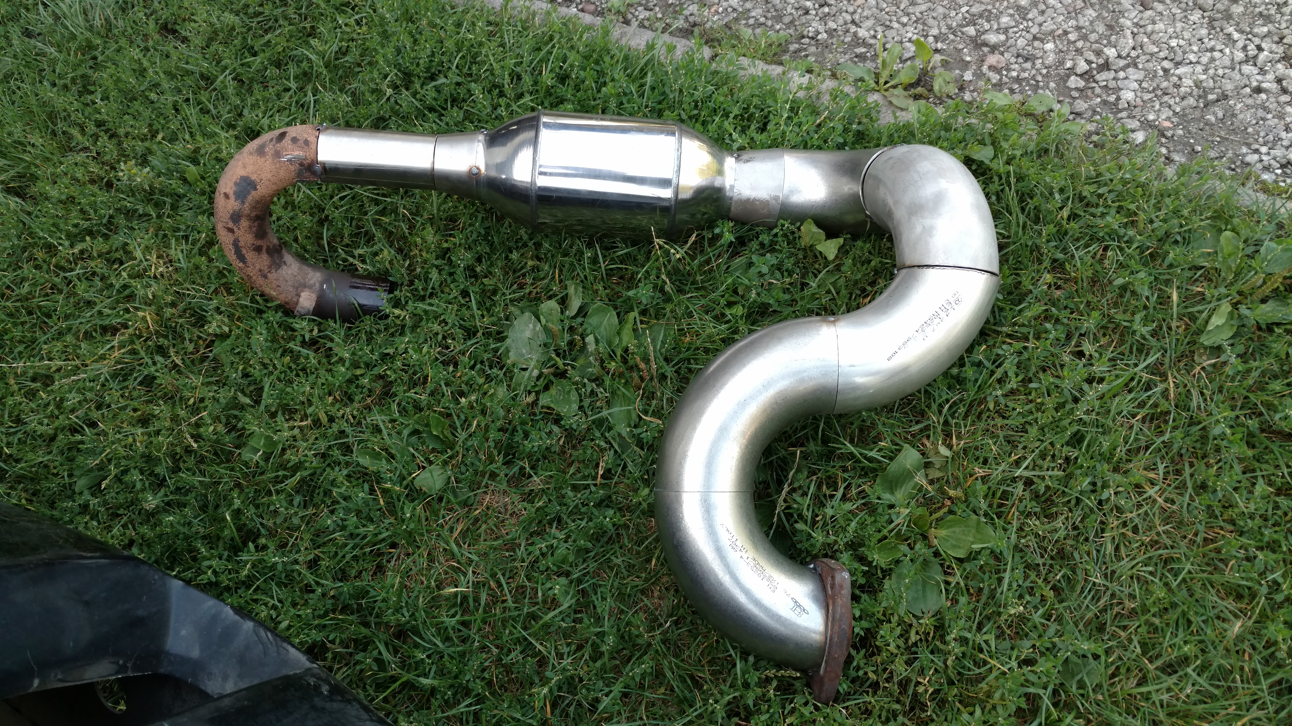

-el-tek exhaust
36. http://www.mazdaspee...49924&mode=view

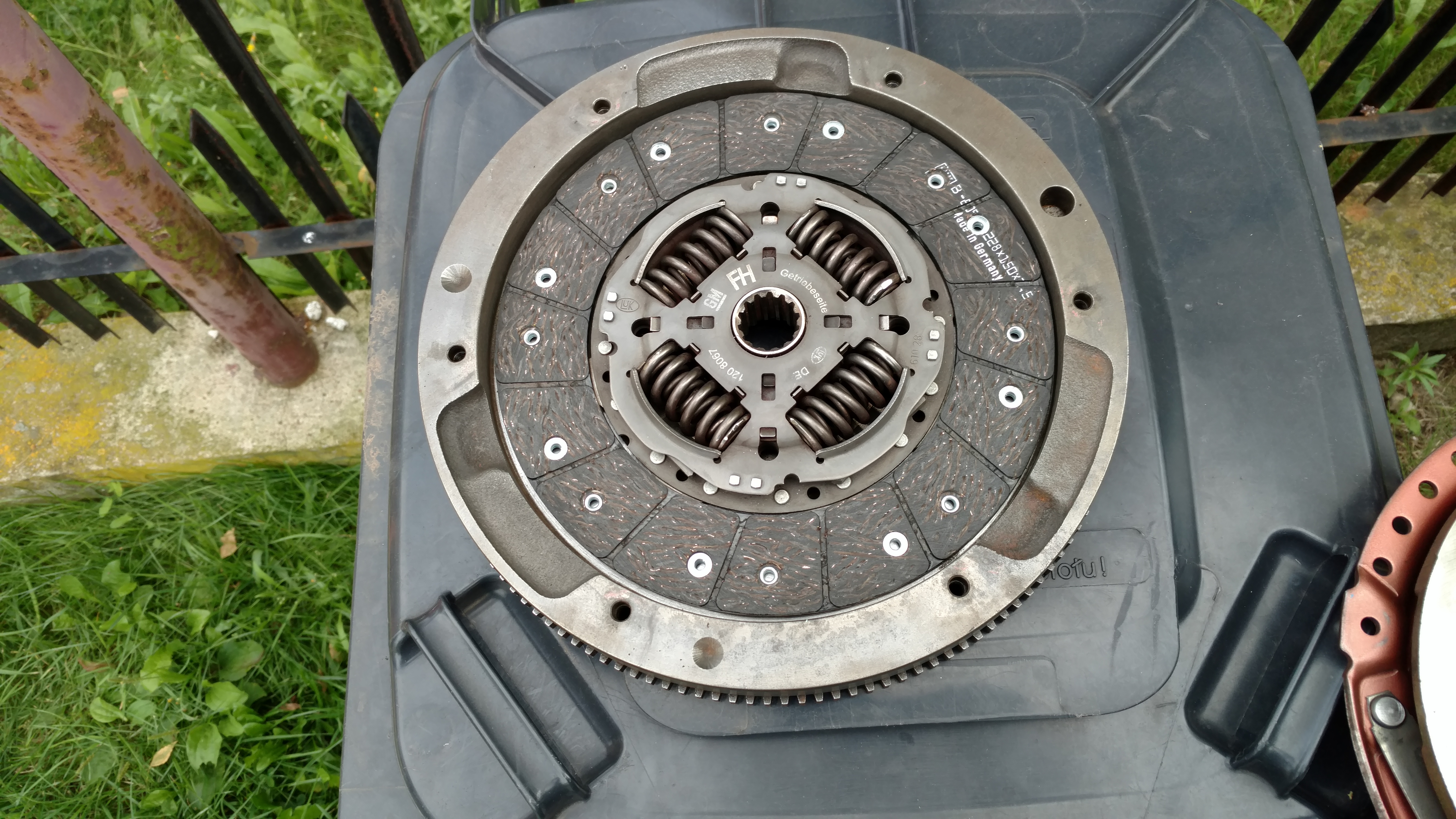

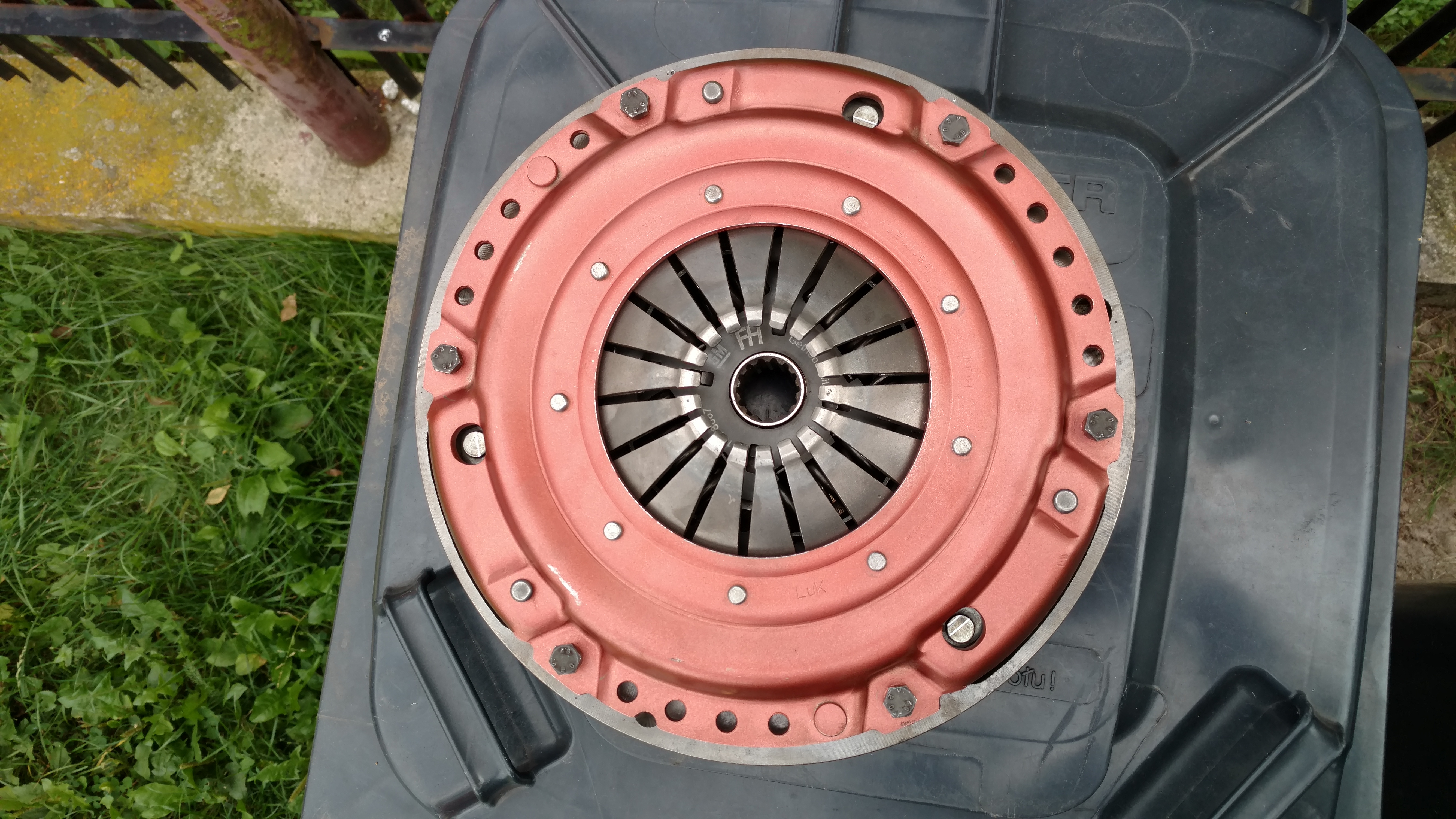

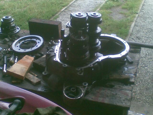

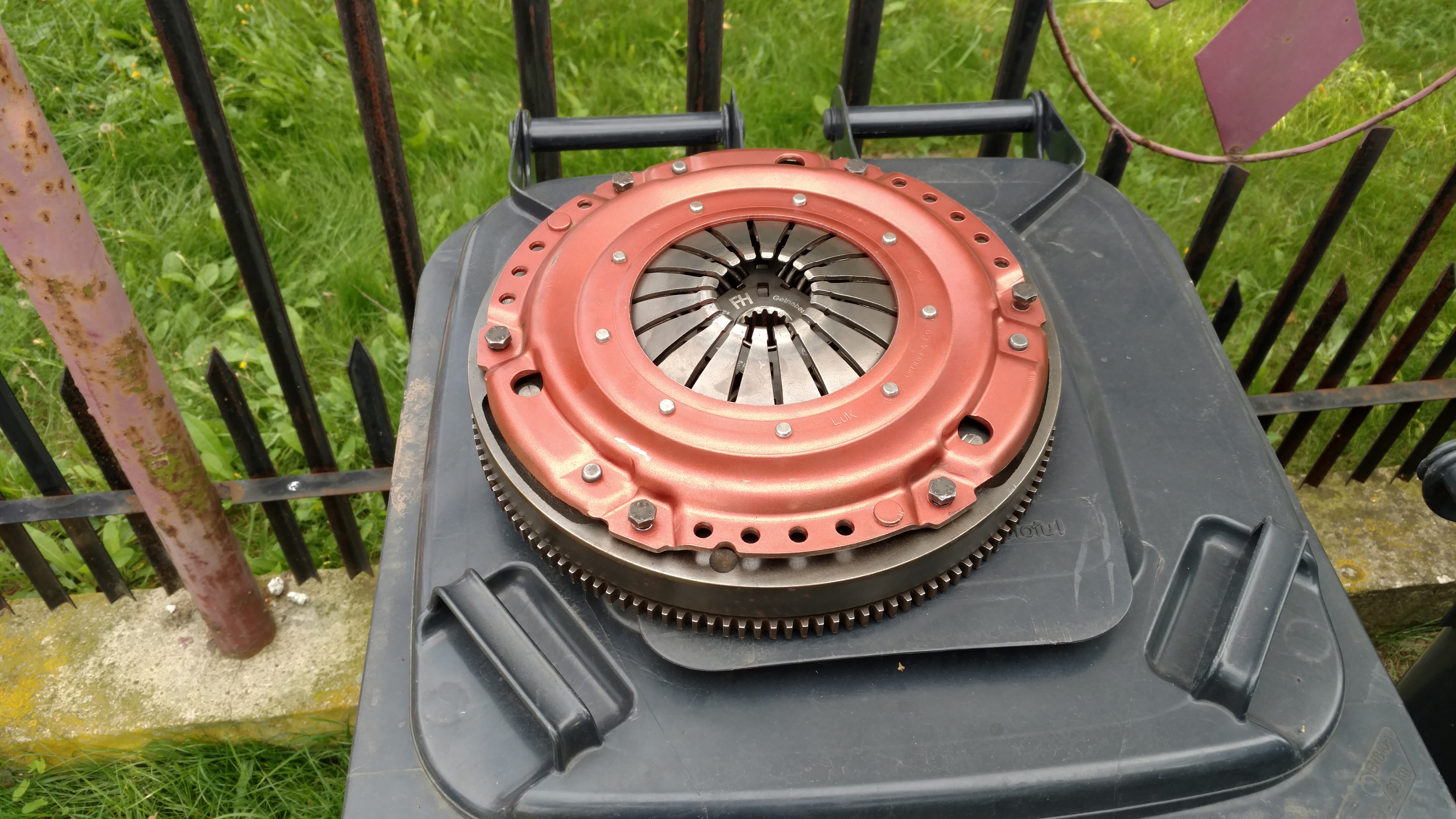

-c20let flywheel:with reinforced clutch
37. http://www.mazdaspee...42409&mode=view
38. http://www.mazdaspee...42410&mode=view
39. http://www.mazdaspee...42411&mode=view
40. http://www.mazdaspee...42412&mode=view
- F23 4.17 GearBox
- carbon wing
41. http://www.mazdaspee...33217&mode=view
Edited by piwo, 14 January 2018 - 06:00 PM.

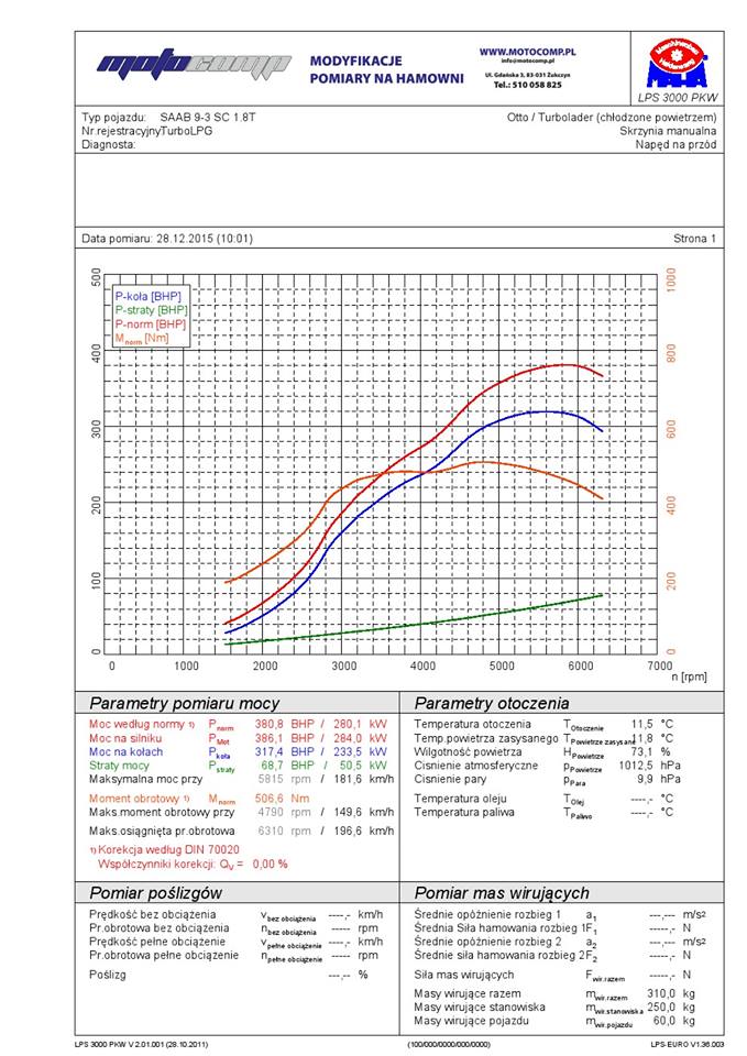

#4 piwo
piwo
  • 184 posts
Posted 14 January 2018 - 06:30 PM
Thanks.

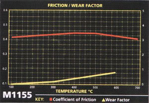

I will fight for such a chart:
http://www.mazdaspee...50537&mode=view
or just like that
https://scontent-waw...6e3&oe=5AF4DA9B
Now I don't know how much it is because the last tuning was on the street (there is 1 bar in 3000RPM and 1,1 bar when cutting in 6800RPM)

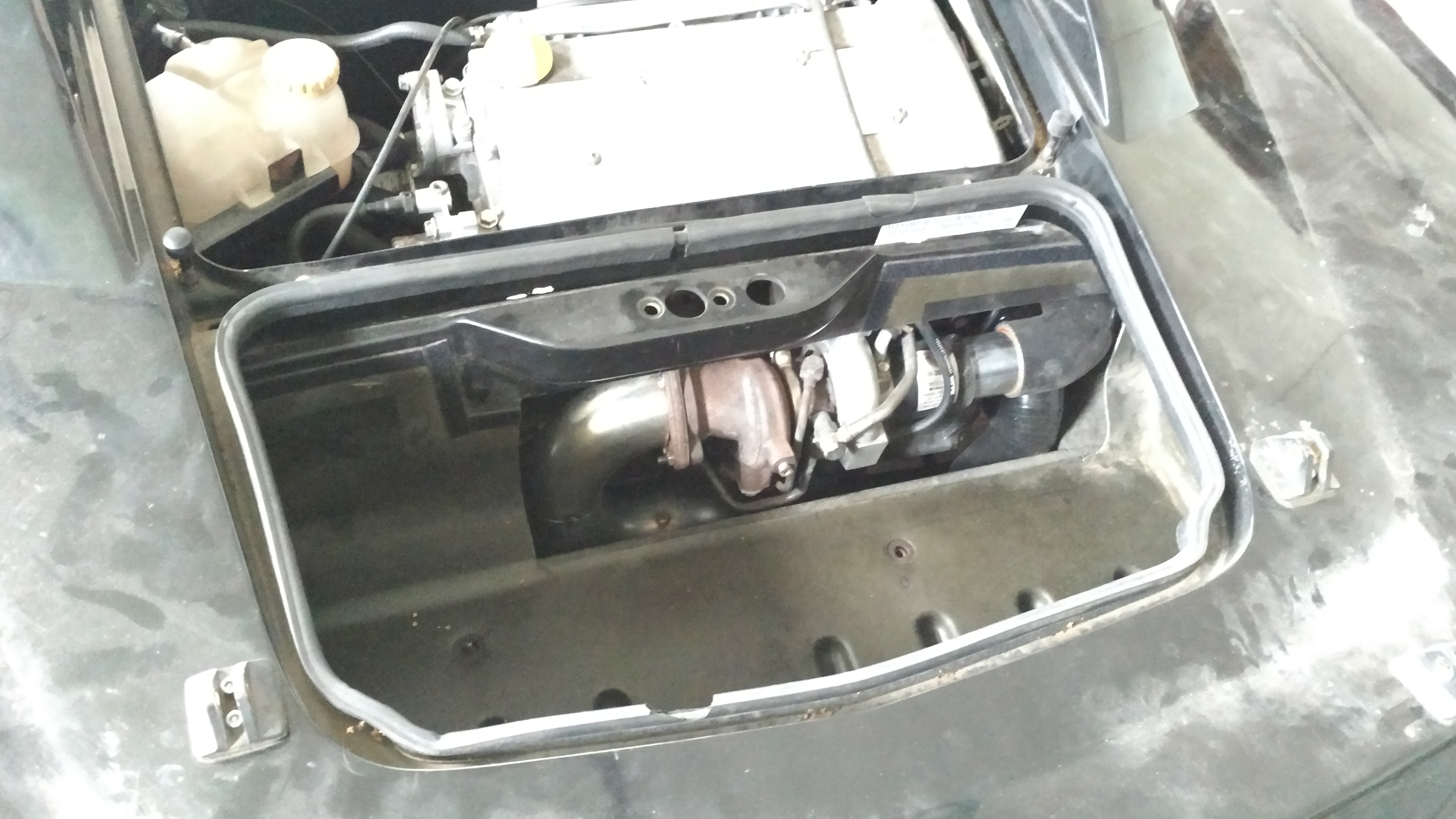

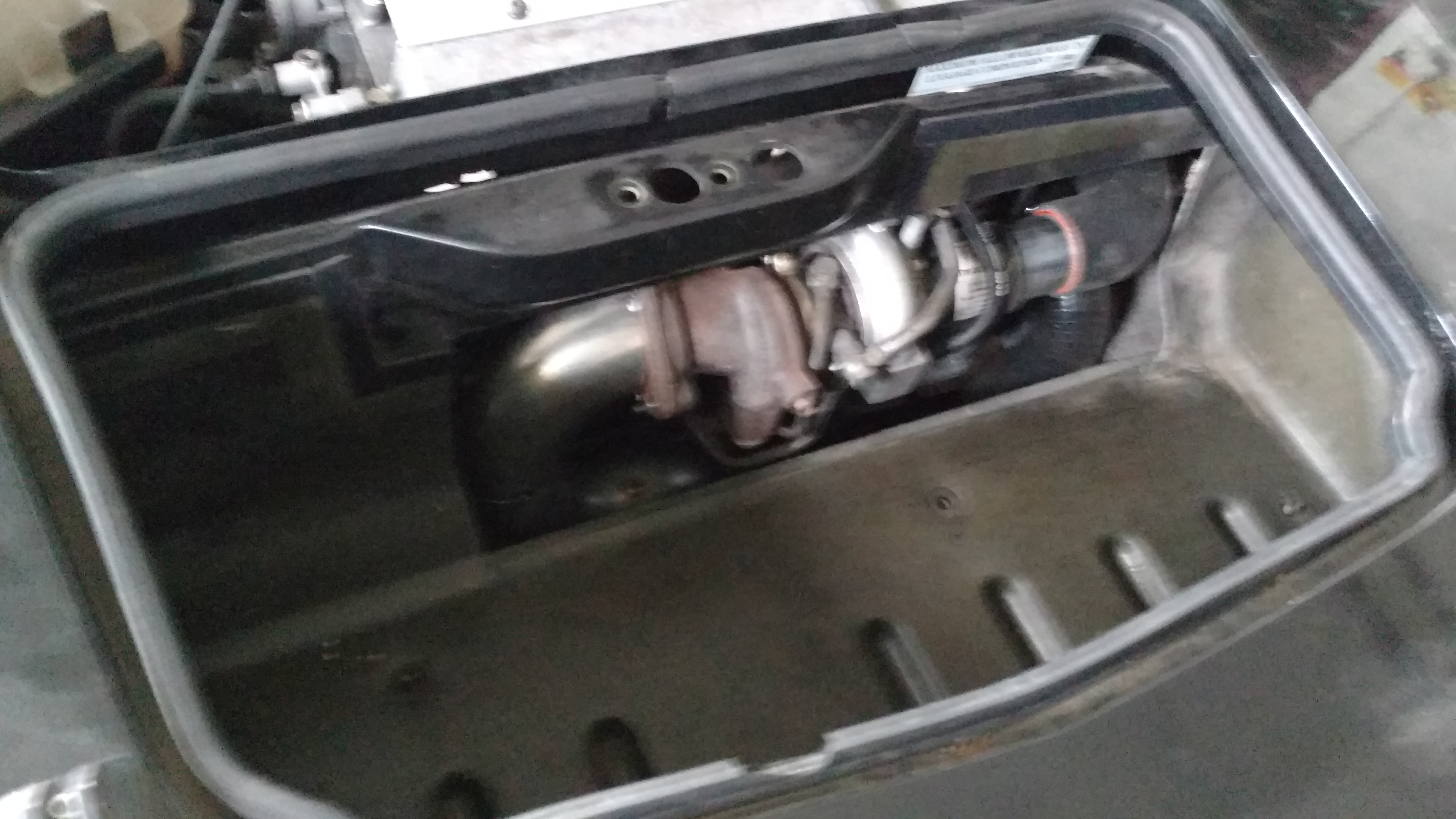

Nope, looks like OEM from a B207R (TD04 - A20 has a K04)
#7 piwo
piwo
  • 184 posts
Posted 15 January 2018 - 11:34 AM
b207r has td04-14t. td04-20t it is td04-14t  with cnc turbo impeller
http://www.ardideas....22T_p_2256.html
https://www.google.p...w=1920&bih=1007
Edited by piwo, 15 January 2018 - 11:39 AM.
#8 piwo
piwo
  • 184 posts
Posted 15 January 2018 - 12:05 PM

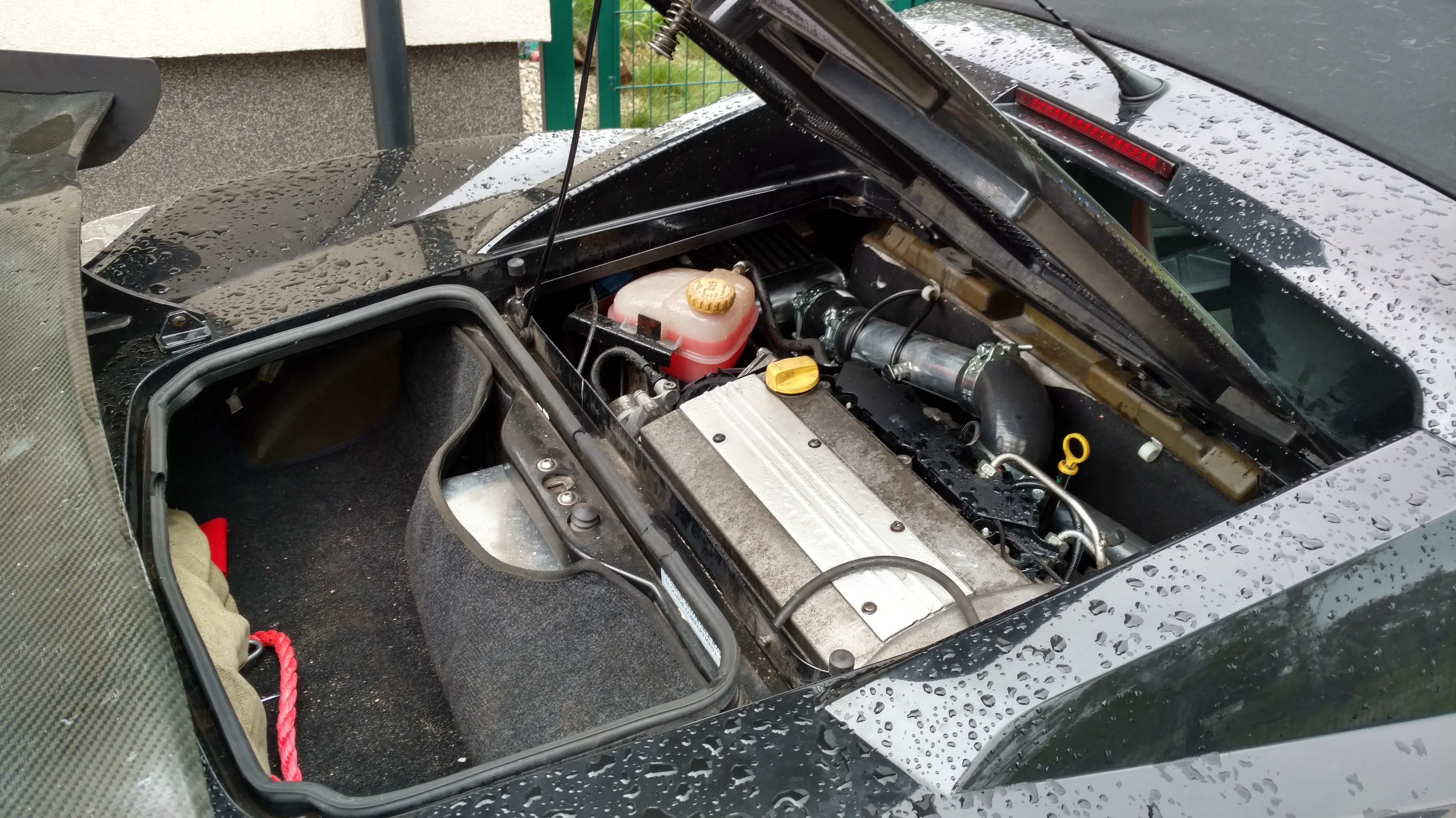

all engine is orginal.only one conversion required it was thermostat cut.
complete engine with turbo, manifolds, etc. i have bought for 600 pounds. and swap from NA to b207R turbo with td04-20t, siemens deka630 injections,orginal reinforced clutch and c20let flywheel, EMu Stand Alone it was about 2500 pounds.
Home Made TCS it's about 150 pounds

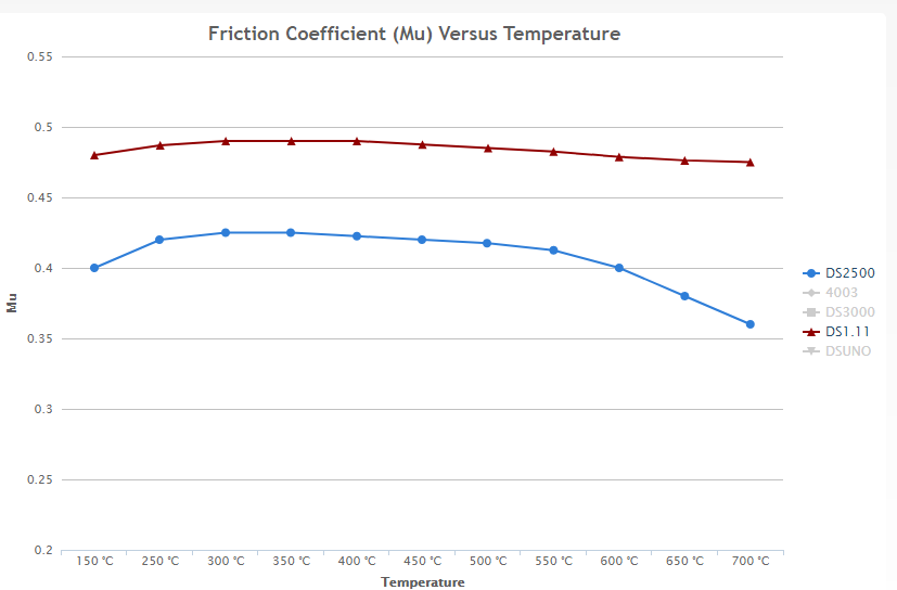

Posted 20 February 2018 - 04:32 PM

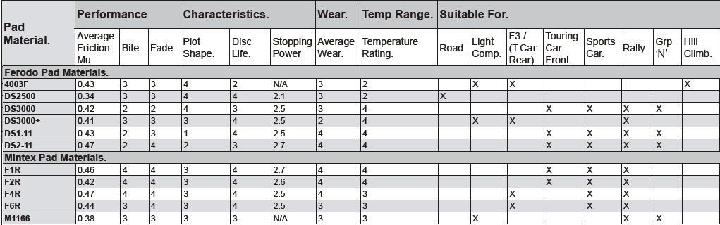

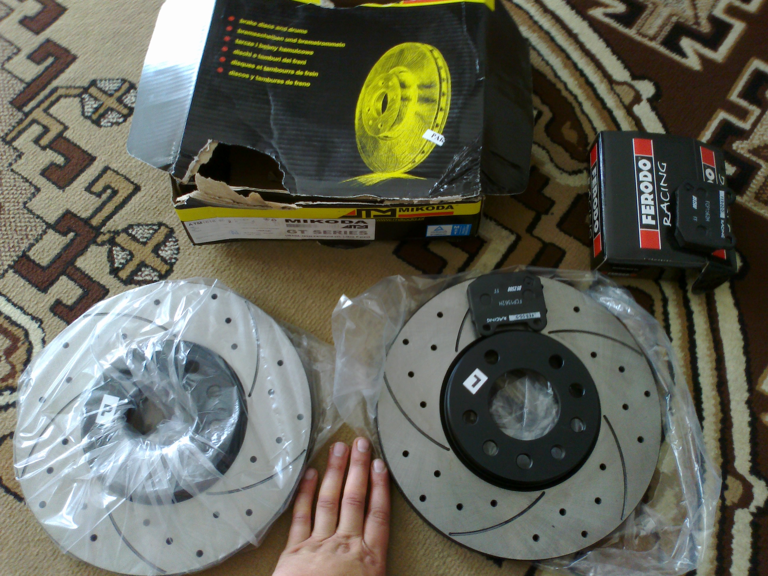

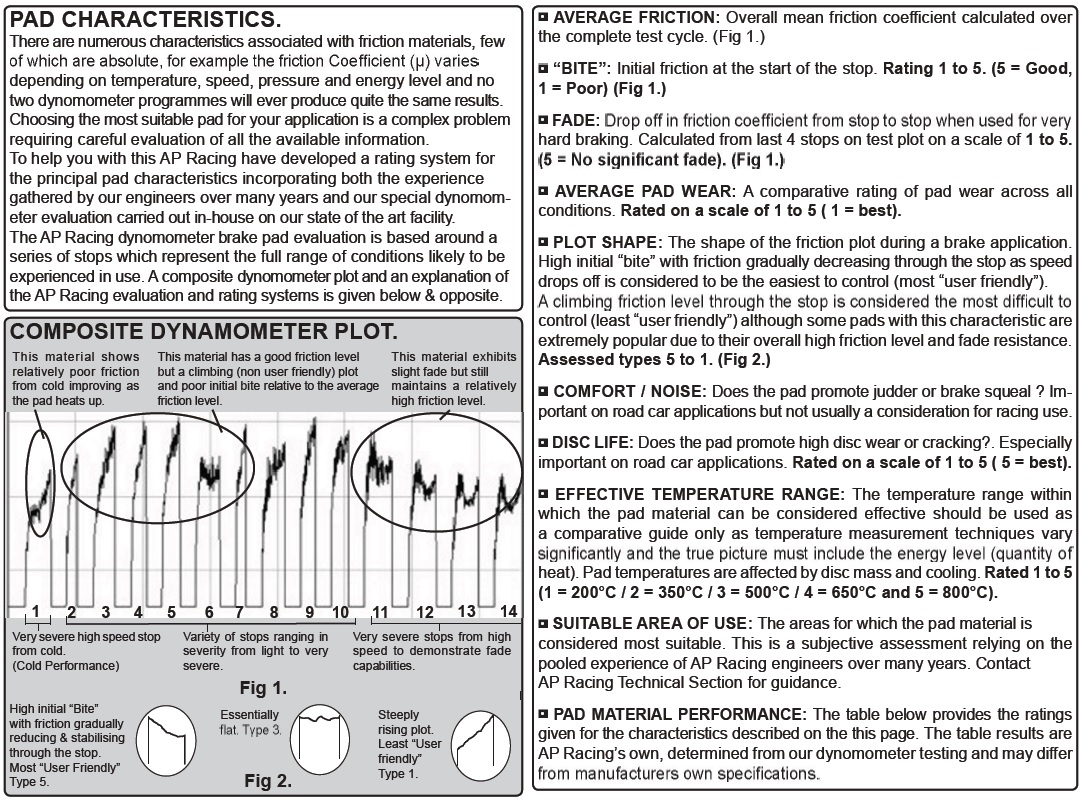

Hello. I have such a dilemma. I have ds2500 pads on the front and serial pads on the back. I would like to relieve the blocking front especially in its initial phase(bit rate). I am thinking about ds2500, ds 1.11 or mintex 1155. maybe someone has a comparison?

#15 piwo
piwo
  • 184 posts

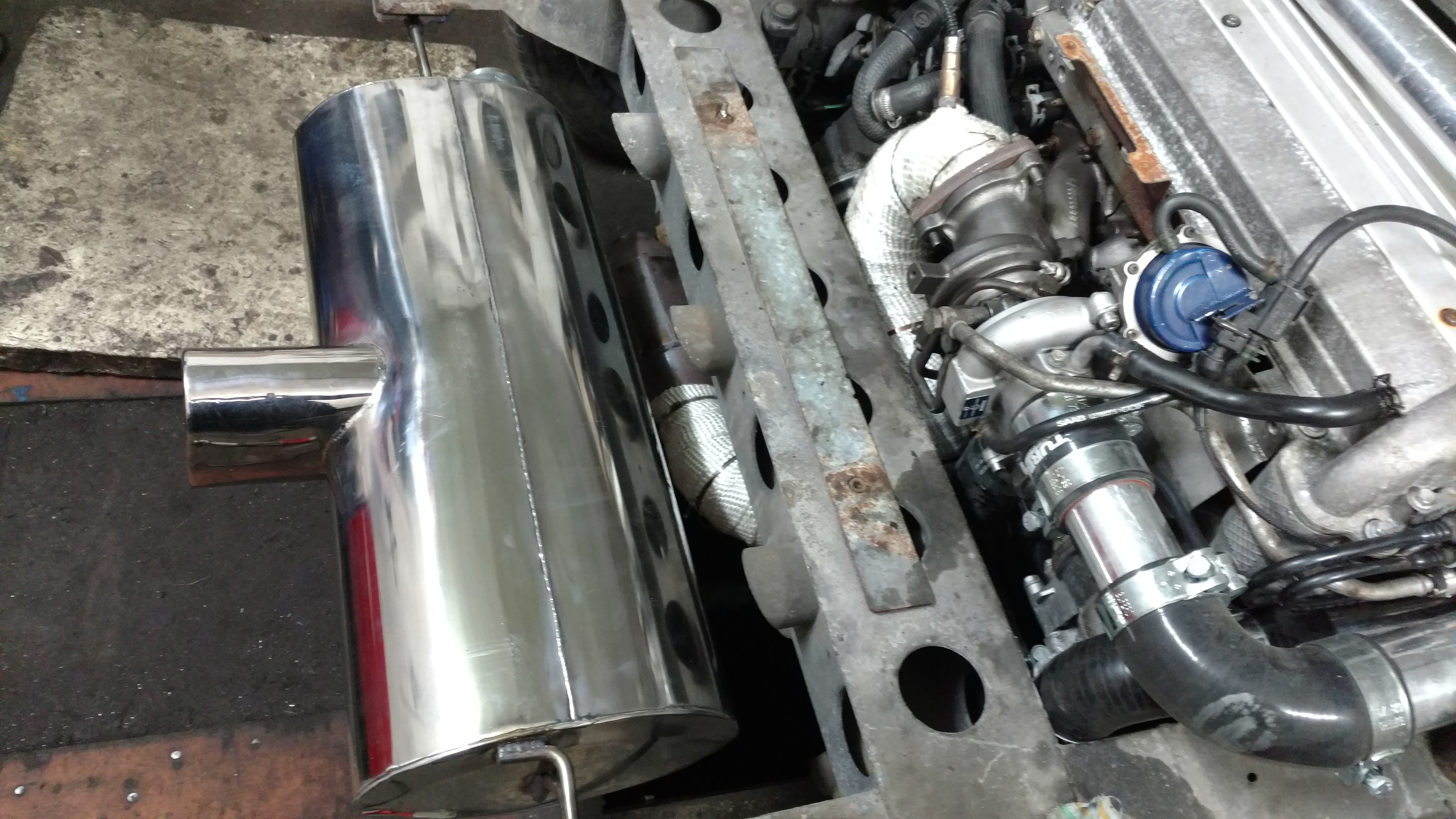

Posted 29 March 2018 - 02:52 PM

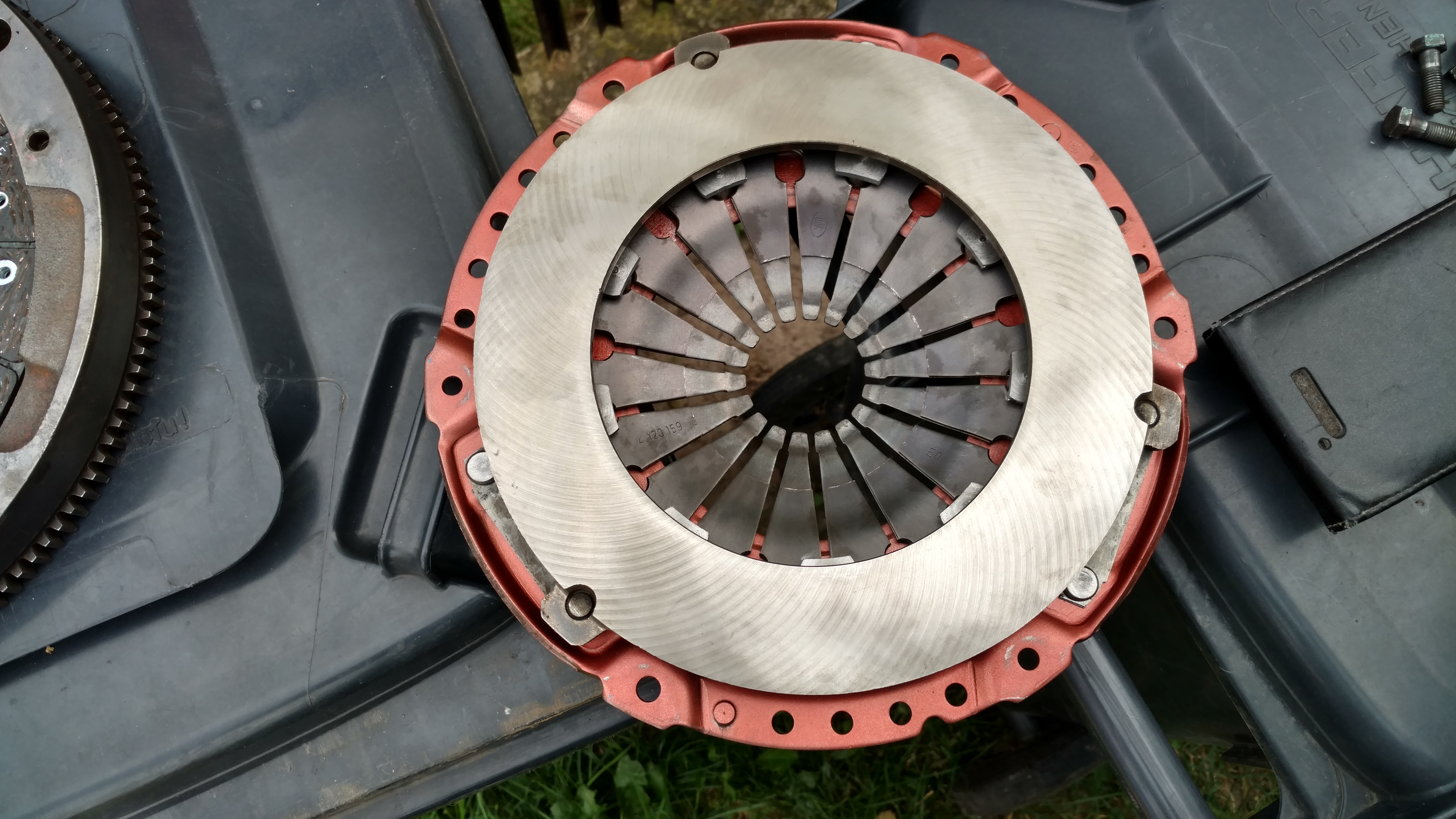

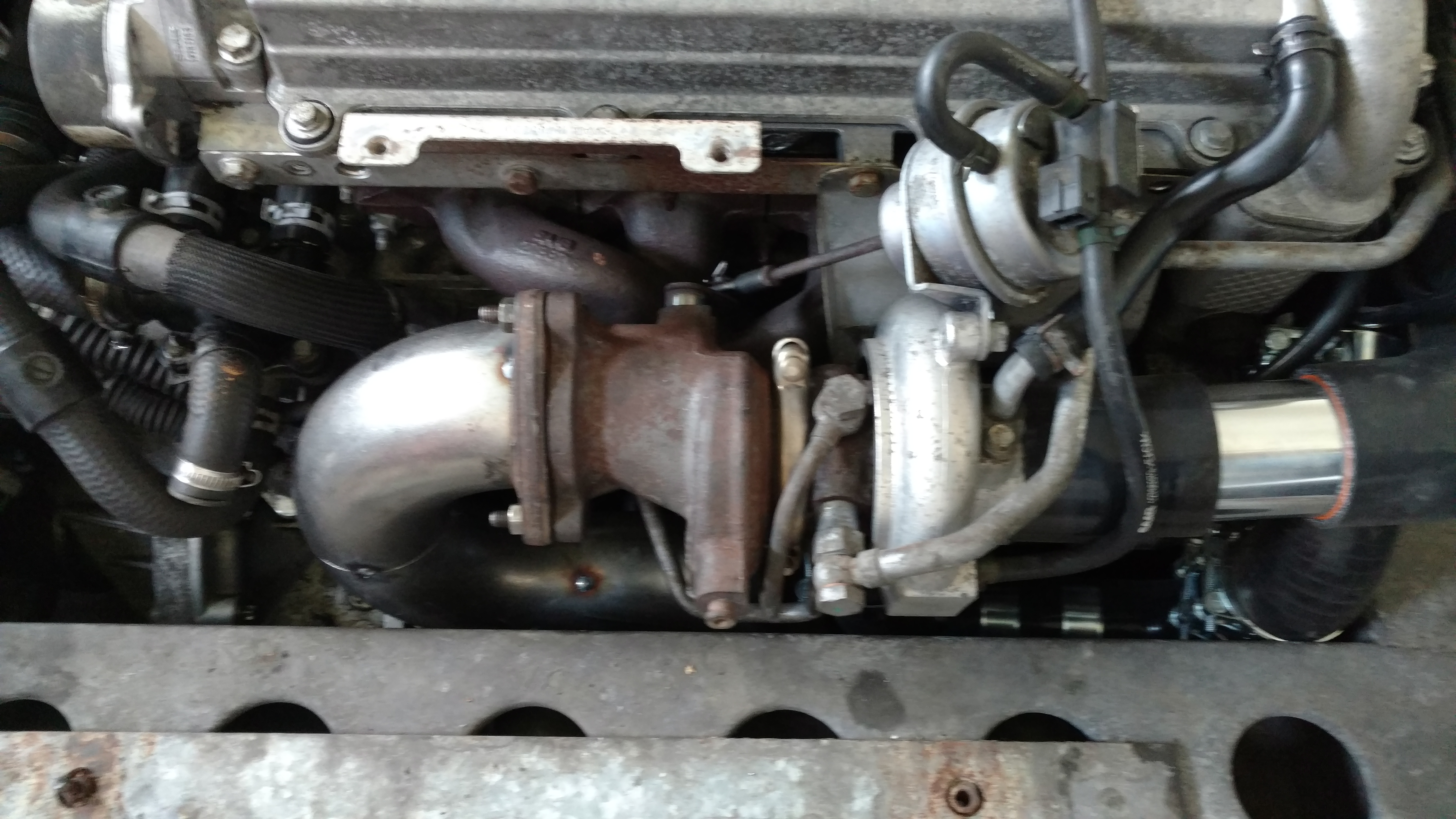

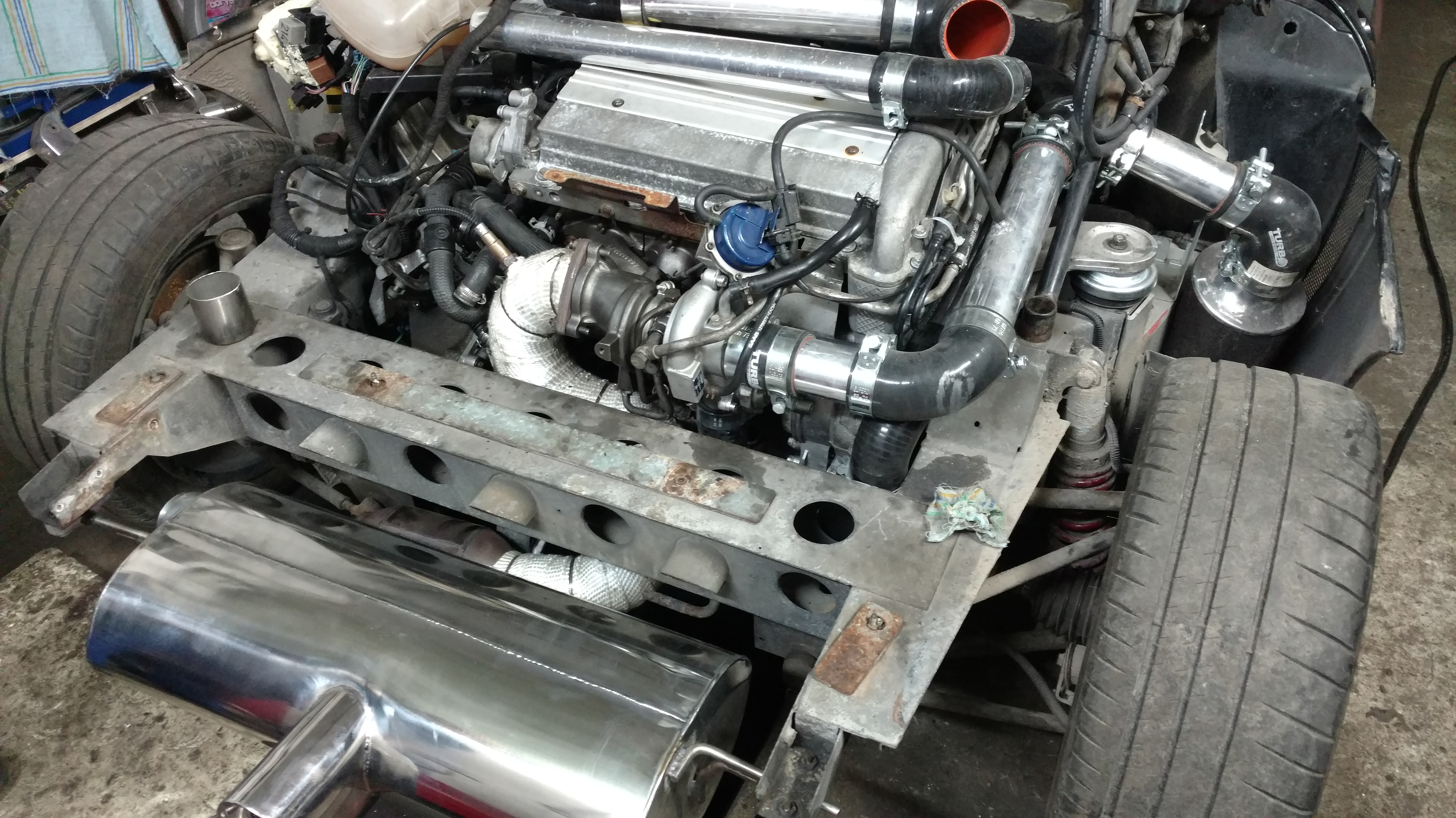

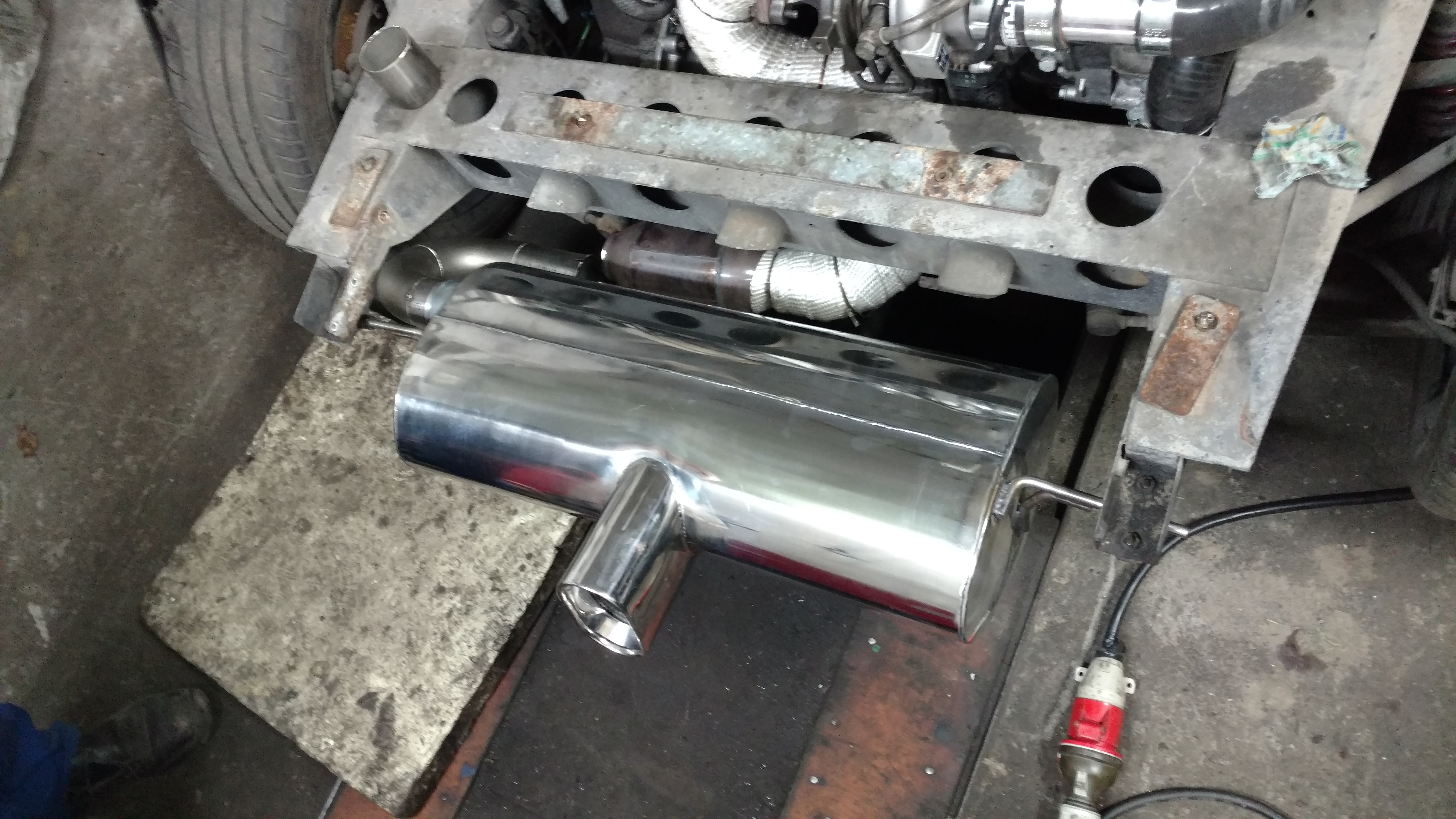

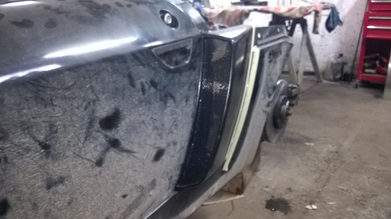

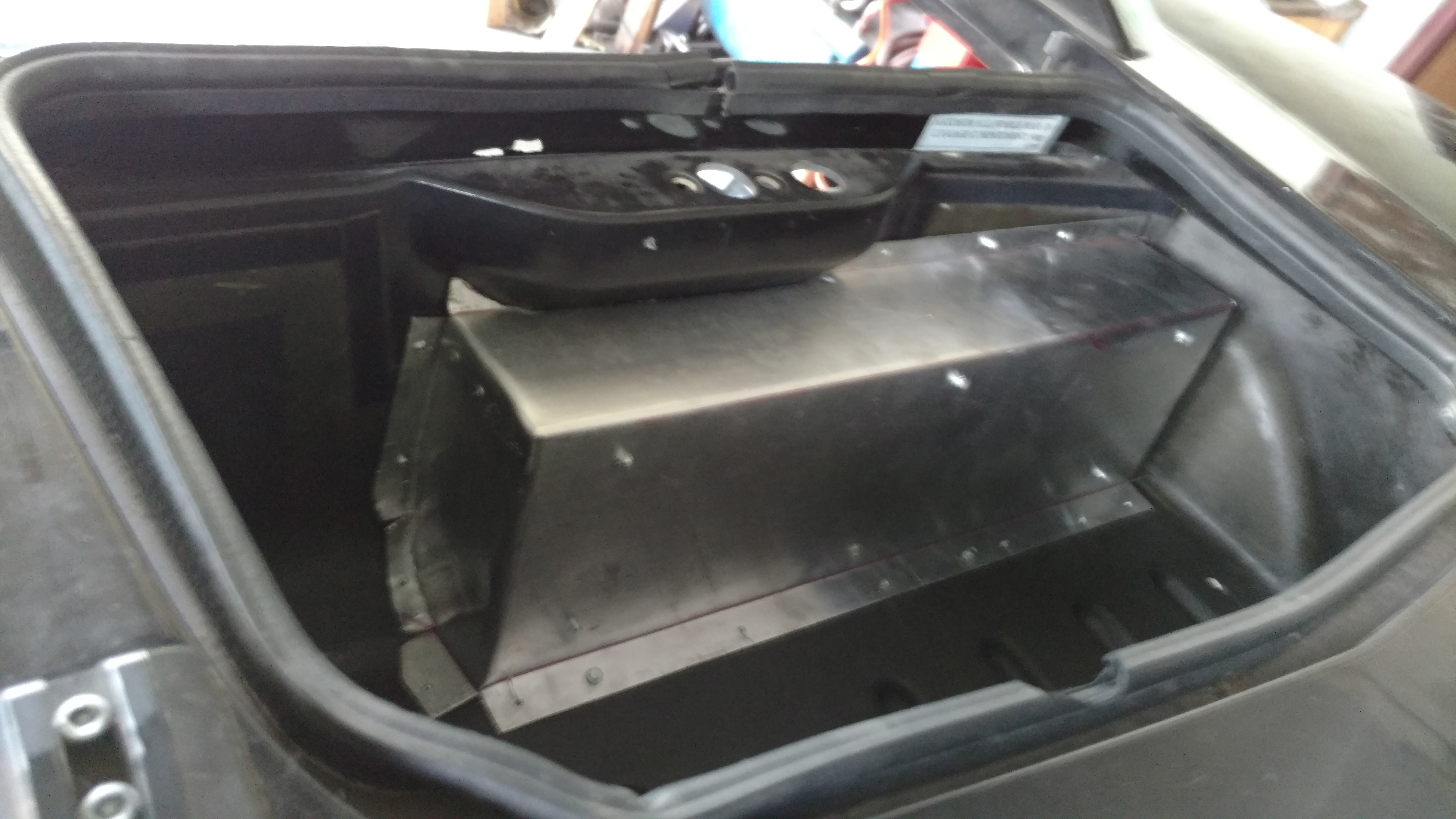

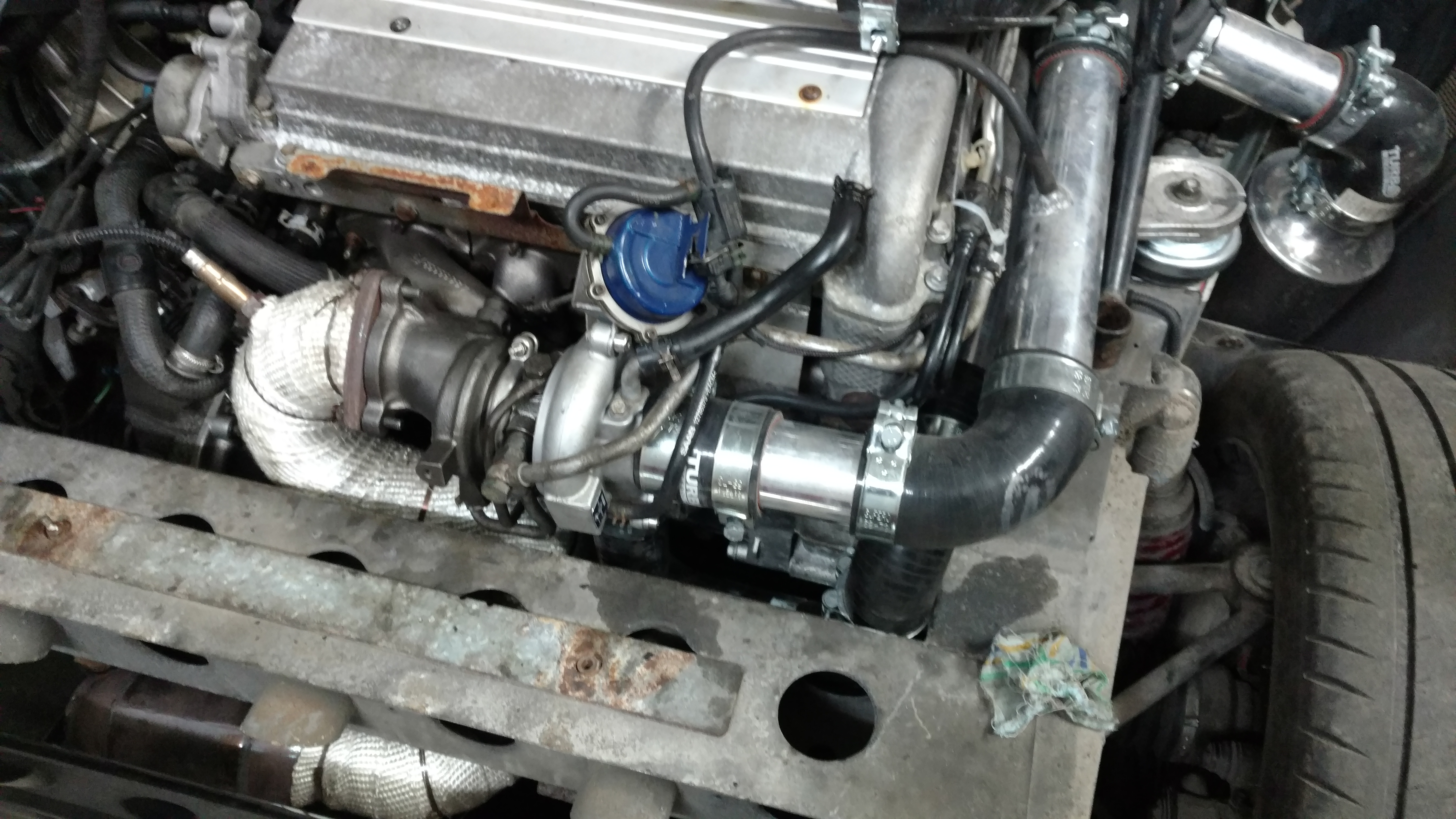

Ok i've bought ferodo ds1.11 to rear. And mounting turbo ears to better cooling intercooler. http://www.mazdaspee...54901&mode=view I've exchanged the gearbox selector links for new ones. Now IT is great to change the gear. Clik clik.

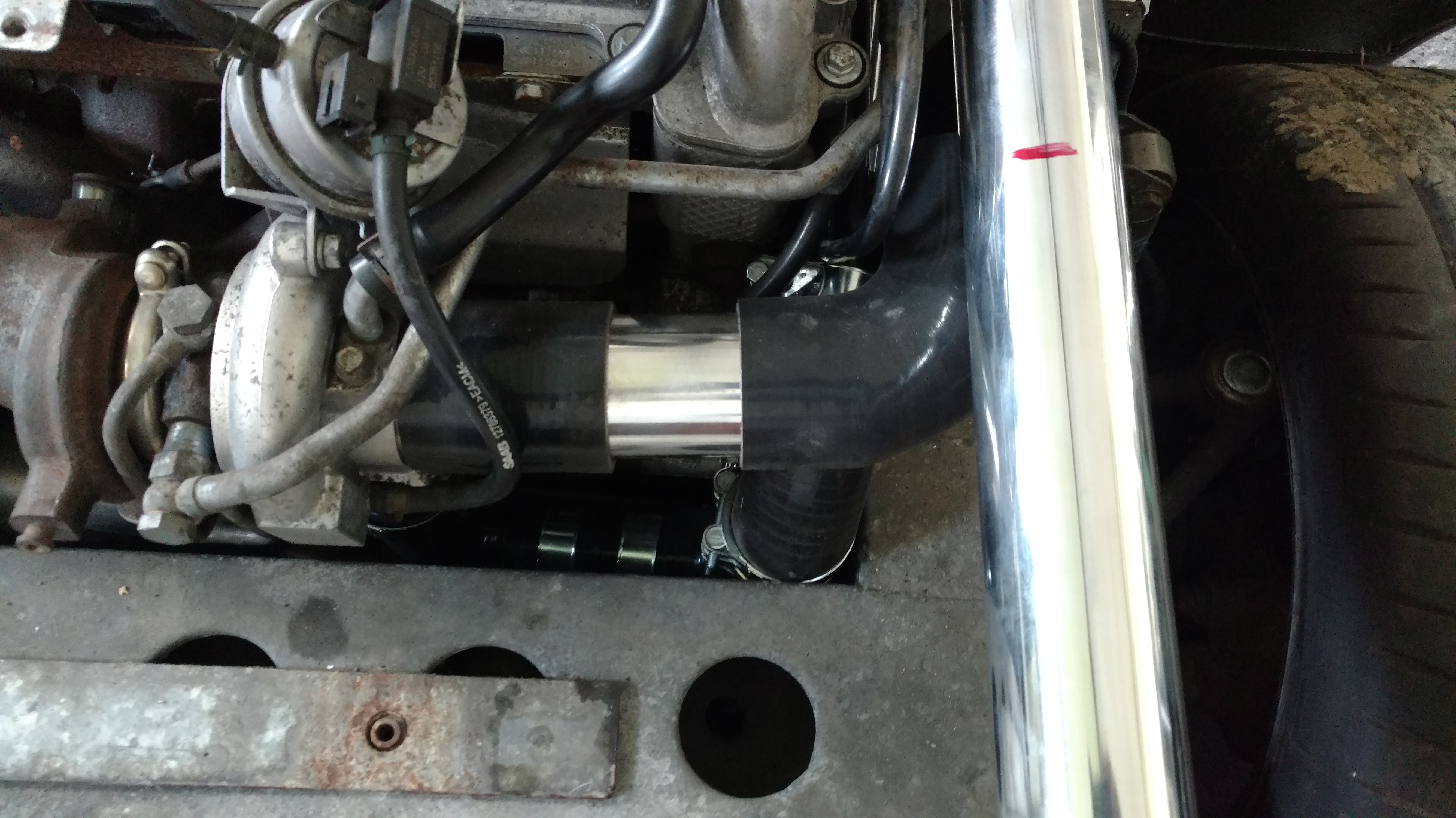

#18 Exmantaa
  • 3,982 posts
Posted 16 April 2018 - 10:22 AM

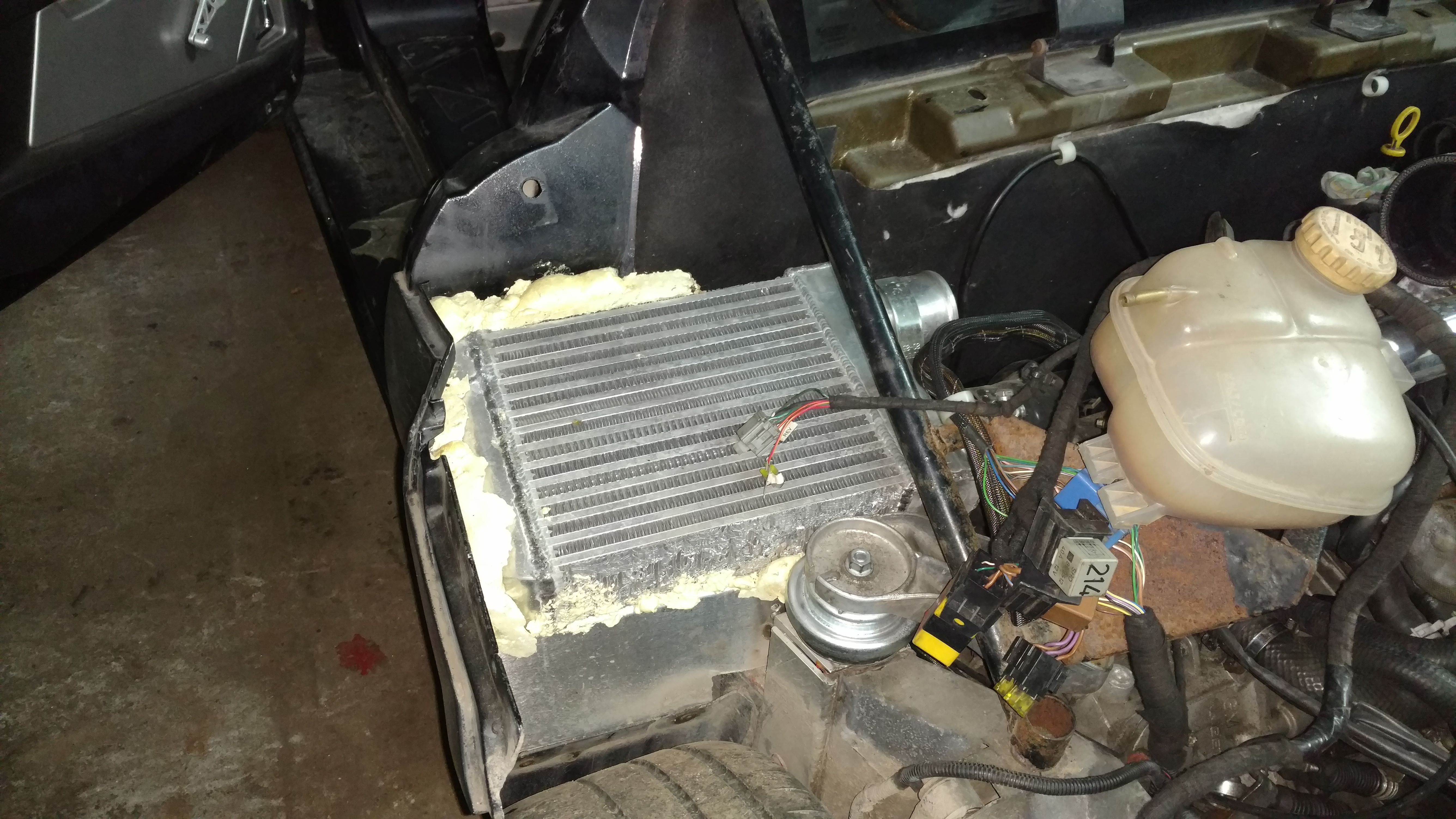

All looking nice, only that Intercooler seems a bit tiny?
Ow, and routing your gearbox cables so close to the turbo is asking for trouble. Re-route or use VERY good heat-shielding. :sleep:

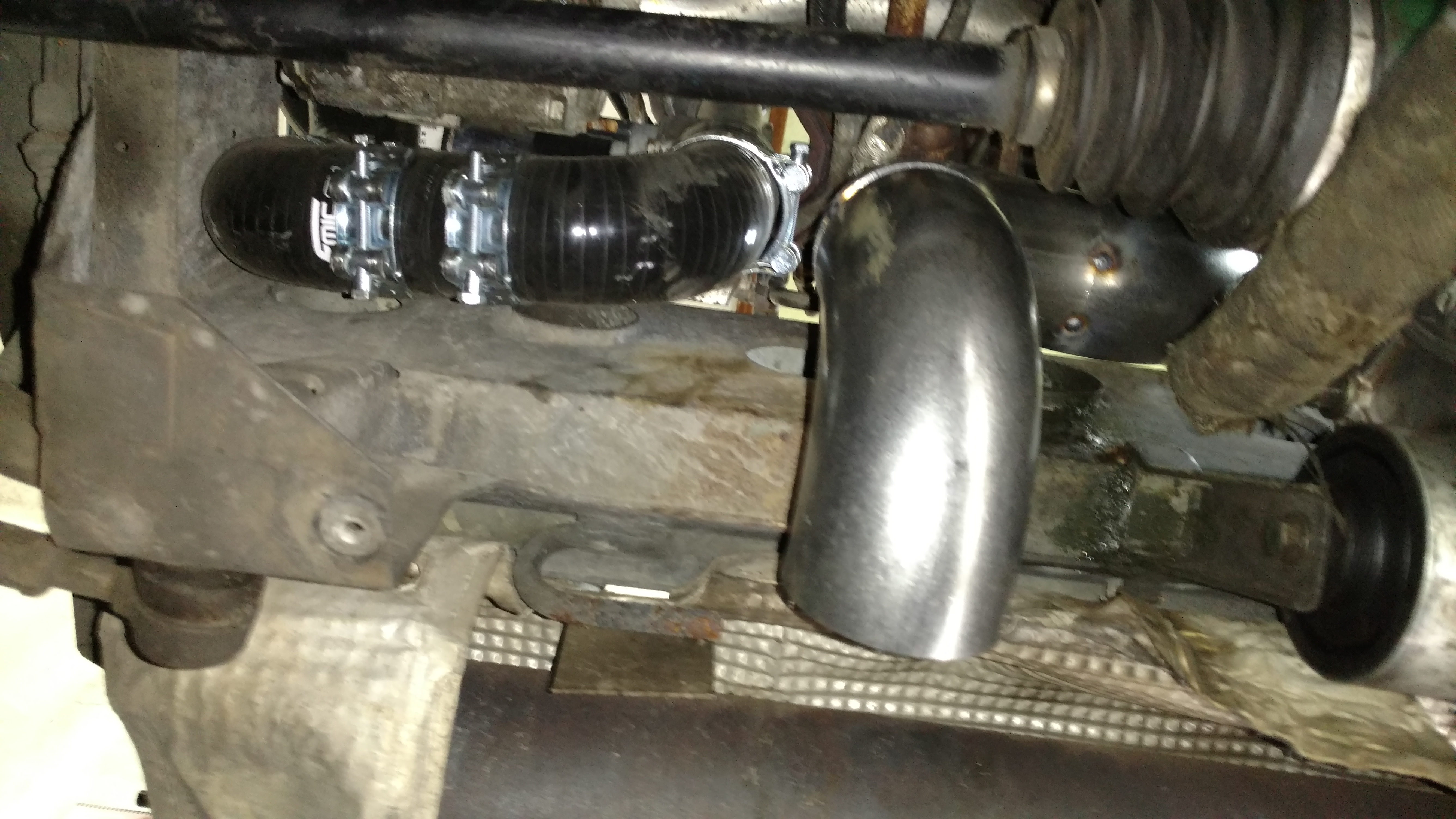

#19 piwo
piwo
  • 184 posts
Posted 19 April 2018 - 04:51 AM
Exmantaa are you to talking to me or to sepro?
i have small intercooler and it's a problem. anather is that iat sensor shows temperature aluminium  intake pipe not air intake (shows still 50 degrees when the engine will warm up). And i can say that after last track day [color=rgb(40,40,40);font-family:helvetica, arial, sans-serif;]gearbox cables died. [/color]
[color=rgb(40,40,40);font-family:helvetica, arial, sans-serif;]anather problem is that connetcing rods bearing died.[/color]
every thing is in progress.
http://www.mazdaspee...56251&mode=view
i can say that the only thing that works last track day it was pads ds2500 in front and ds1.11 in rear. it give me vary good balans when braking (no locking of the front wheels)
https://www.youtube.com/watch?v=8BosWtyAIj0&feature=youtu.be
Edited by piwo, 19 April 2018 - 04:55 AM.
