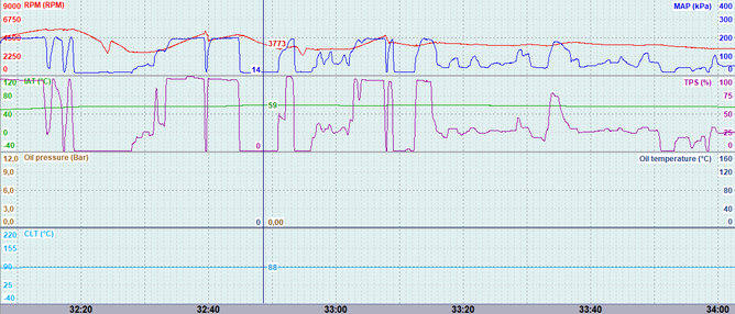

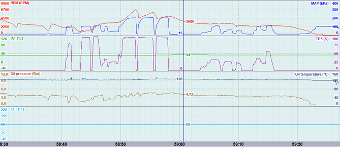

and  comparison
 IAT with air intercooler (300mm x 400mm) (20° C outside)

 IAT with water intercooler (mercedes 600s, pierburg cwa50 pump) (25° C outside)
https://www.mazdaspe...p?id=164863&t=1

looking at those graphs , what is the maximum range of the map sensor?
#27 piwo
piwo
  • 182 posts
Posted 24 September 2018 - 02:59 PM
400kpa or 3 bar boost.
