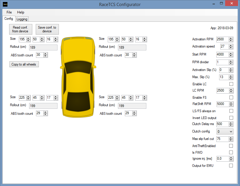

Do you have a calibration file to share for the Speedster / VX Piwo? ;)
#6 piwo
piwo
  • 104 posts
Posted 14 March 2018 - 09:28 AM
Yes i do.
http://www.mazdaspee...54012&mode=view

Useful in case I go for it.
Any reason your tooth count is different front / rear (29 / 30)?
#8 piwo
piwo
  • 104 posts
Posted 14 March 2018 - 11:17 AM
In the old software  it was possible to set the operating threshold from 5%. It was this difference to set the threshold at 2% (1 tooth  it was 3.3% higher speed of the rear wheels). In current software, you can set the action threshold from 1.5% so we set [color=rgb(40,40,40);font-family:helvetica, arial, sans-serif;]front / rear (30 / 30)[/color].
