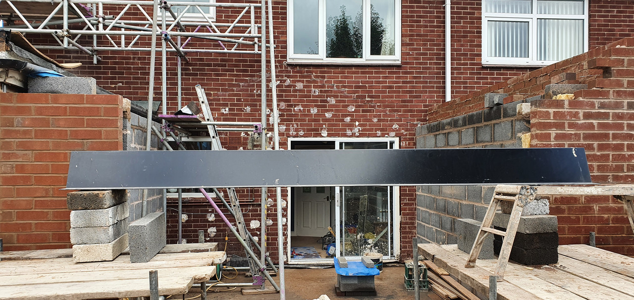

Put the padstones in for the lintal. Its a heavy duty one as they sold the one we had wanted so gave us that one at a loss.
Stuck it in the next day and bricked it up.

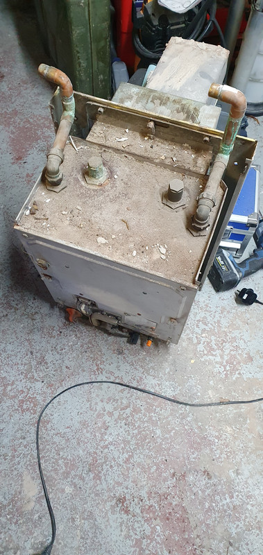

It was at this point I bit the bullet and took out the boiler, I could still get hot water from the emergen heater in the tank but no heating from now on.
I capped of the gas pipe. A new 22mm gas pipe would be run to the new boiler position in the utility (old one was in the garage).
It was a Baxi fitted in 1990. I moved in in 2012, lit the pilot light and haven't touched it since.

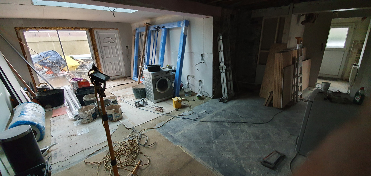

Took the ceiling down in the kitchen. That was messy.
Then took all the tiles up.
#29 Zoobeef
Posted 02 February 2021 - 03:25 PM
Then I decided to take the doors out and fit them (and that old garage back door i removed) into the bifold hole.
Then took the wall down in the kitchen.
