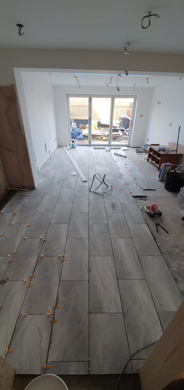

I then thought I'd give tiling a go. We bought 75m2 of tiles for the kitchen and dining room. And 42m2 for the bathrooms.
Started with the main bathroom. Tiled the walls, then the floor.
Seems to be ok.
The floor is a similar pattern but darker.
The main bathroom is not at the stage where it just needs the shower screen putting in and some silicone round the window.
So next I thought I'd do the kitchen floor.
Mocked up length and width
Used a fricking "laser" to get a straight line and got started.
Took it all the way to the end of where the darker floor is on here.

Looks great.  How did you find taking up the kitchen floor tiles?  I ask because its on my list.  You should see my kitchen :sick:
Piece Of p*ss with an SDS drill with a spade/tile attachment.
Then ran it over the floor to take up the old adhesive.
Screenshot-20210202-185629-Video-Player.
