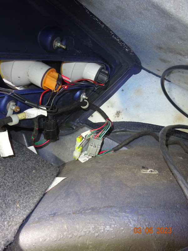

 The other problem i have is that the fog light does not appear to work but the fog light button does turn on the reversing light that occupies the same position in the other rear light cluster. I am not sure if it was working correctly before i took the car off the road but as it has an MOT it presumably was. I have not touched any wiring at the back lights but did notice an electrical connecter with just two thin cables at each end that was not plugged in when i had the rear nearside wheelarch liner off so i reconnected it. I will try the reversing lights today to see if that lights up a reversing lamp and the fog lamp and then disconnect the block behind the wheelarch to see if that makes any difference. Despite the setbacks i am still enjoying working on the car and getting to know it and am looking forward to a bit of cutting and grinding to enlarge the fuel pump non-access  :rolleyes:   panel.

The reversing lights and fog lights are separate circuits so sounds like someone has plugged them in the wrong way round.

Thanks for replying hairy. Yes you are right on the money. I have just come back from the lock-up and putting the car in reverse causes the fog light to come on. Where should i be looking to find the relevant connectors to swap them over i.e should i be looking in the boot for the wiring there or is it behind the dashboard or elsewhere?

Follow the reverse light switch wiring back from the sensor on the gearbox?

Posted 30 April 2025 - 06:41 PM
                                                                                          Dave C
Yes, in the boot by the left tail light.

pic
https://i.postimg.cc...Yj/DSC06690.jpg

Thanks for the picture stevieturbo and to everybody else for your help - it is now sorted. Sure enough the two were transposed . The feeds were clearly labelled FOG and REV but the other side only had an L and an R on them - presumably someone thought that meant left and right despite the cables clearly being different colour codes.
