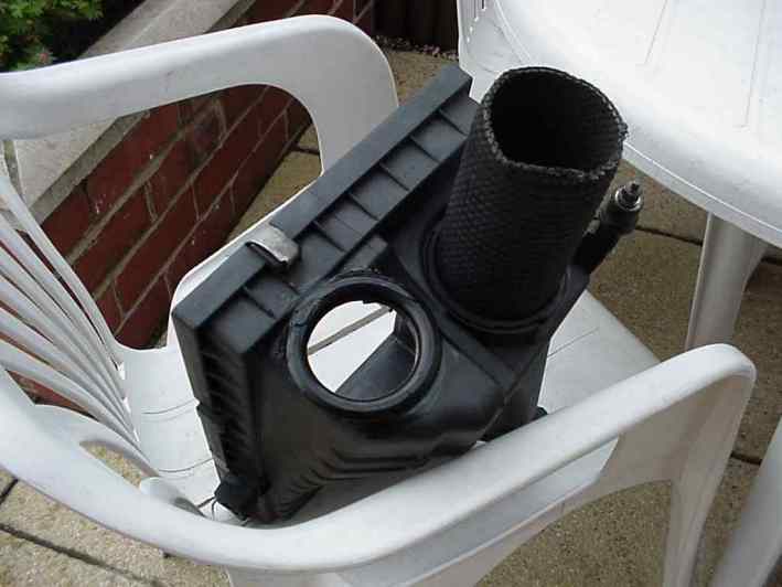

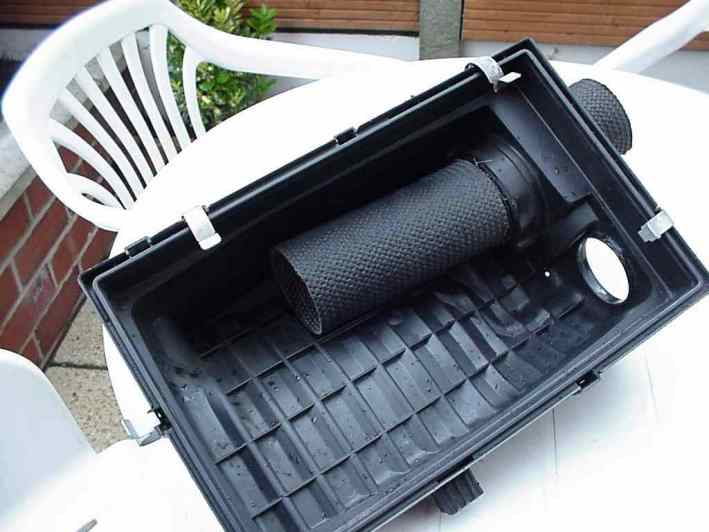

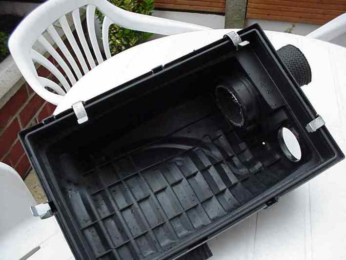

Airbox mod done to my N/A... ive not had a good look at a VXT to see how the air boxes duffer....
First pic showing new hole with trumpet (bought from Maplins @ 58p 52mm diameter) The trumpet is cut down so more or less flush with the inside of the box. It also shows how far the O.E. pipe comes into the box...
This picture just shows how much pipe ive cut off....
Finally this is showing the trumpet fitted from the outside, plebty of flat area to drill the hole..
Since ive done the mod, it has nice subtle induction noise now... and feels a little better to drive... I used Courtenays replacement panel filter.... thaks to Jon at Courtenays for telling me how to do Imnotworthy chinky chinky
