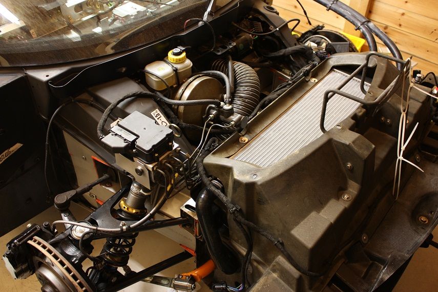

In the list of annoying things to do to VXs the replacement of the left hand rad hose rates pretty high. I didn't even really need to change it, but i thought i'd match the other side, 'while i was there' :rolleyes:
I ought to admit i knew exactly what was going to happen. The aluminium pipes that carry the coolant from the rear to front only protrude about an inch and a half at best. And of course when you come to install the new pipe, the majority of the aluminium one disapears since it isn't held with very much. Anyway after some fun and games it eventually went on with about the minimum i was comfortable with.
Having said all that. pretty pathetic progress really. lots of things getting in the way of vx playing at the moment. But it'll be ready for the road in a couple of weeks time
#1089 hairy
hairy
    Moonlander
  • 6,069 posts
Posted 17 February 2013 - 09:10 PM
What is that 3 x cable tie arrangement at the front for?
#1090 techieboy
Posted 17 February 2013 - 09:12 PM
Stopping the hinge flapping back down on top of the rad and damaging it, I guess.
#1091 JG
  • 13,617 posts
Posted 17 February 2013 - 09:17 PM
Ya, gets replaced with a cardboard protector at a later stage. But in order to protect the rad after installation into the rad surround, the hinge has to be secured. I leave it until the clam is ready to go on.
Have a helper push the pipe back from the rear of the car. The coolant hose on the back may now have 'kinked' as you pushed it back. The pipes in the chassis beam are not held in place by anything. They are just pushed through some foam blocks and can move (as you experienced ;) )
A trick I sometimes use is to first push the pipe forward from the engine side in the chassis beam and then fit a cable-tie on the pipe close to the grommet at the front.
Now, if you're careful and use some lube, you can get the hose on the front without pushing the pipe back, then cut the cable tie and tighten the jubilee clip on the hose.

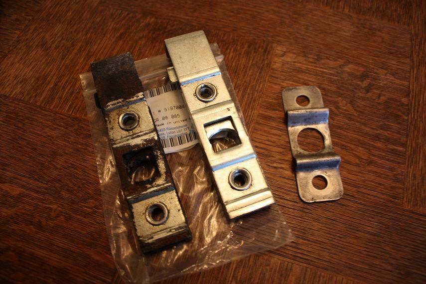

shinny new catch has arrived :D (50 fucking quid :beat:)
But i was secretly hoping it might come with the top part of the catch (pictured to the left). Mine has cleaned up ok, sat in Gunk for a week, but i'd really prefer a new one.
can't find any reference to it on the TIS/Part diagrams. Anyone any ideas?
#1098 CocoPops
Posted 22 February 2013 - 05:16 PM
£50?!? £50?!? OMG!!! Are you mad? :lol: (No need to answer).
#1099 JG
  • 13,617 posts
Posted 22 February 2013 - 05:20 PM
:lol: should have checked other sources: https://www.deroure....SC=0&PBID=34661 seems that i've answered my own question :beat:
