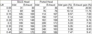

Ok just for giggles I've done a comparison of 3 cylinder heads: Ecotec (ours), 350 Chevy (responds very well to head porting) and VW Golf 1.6 (hardly responds to head porting).#
Lift in inches, flow in cubic feet per min.
Ecotec:
Chevy:
Golf:
so the Ecotec would seem to be somewhere in the middle.
One thing to bear in mind I suppose is that the ported figures for the Ecotec came from a website where a company is trying to sell they're product, so will be the best figures they ever acheived (maybe with a bit added on for luck).
The other figures I've nicked from a book on engine tuning, so are probably more realistic :D
