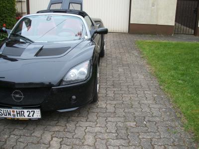

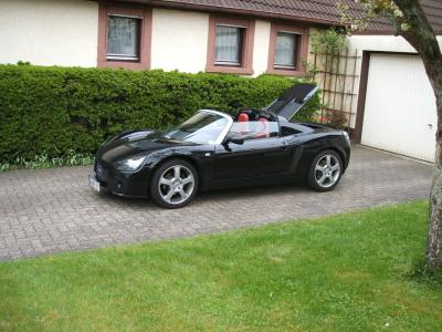

The common opinion in the german Forum is to expand the frontaxle in opposite to the rear. The most valuable combination with TÜV-Approval is 30mm front and 10mm rear.
I have choosen 16mm only front for keeping the unsprung masses as less as it could be.
The gain is tremendous :groupjump: Seconds near to minutes less on the homecircuit :D
Bought by SCC
Posted Image But be careful. The behaviour of the car will be changed :o less or until to nothing understeering anymore :D This let you take the corners more powerful and of course mauch quicker :)
But the rear will come in a shorter time... the time for the response when the rear will come is also less. So you will get a more active car as it is today and this is more risky to the stocklayout. Nothing for Beginners!
You can´t get any more difference for less money, but you have been warned!
Regards
