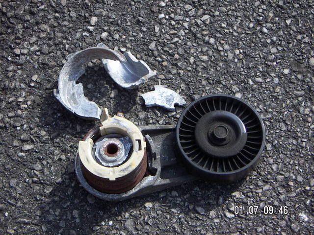

I had this problem on my NA and it turned out that the tensioner arm had seized due to getting wet, as per the expansion tank it's not designed to be exposed.* To check you can either try to get your hand down the dirvers side of the engine and try to push the arm down against the spring and see if it moves. Or you need to take the drivers wheel off and get to it that way, i had the undertray off at the time so not sure if you need this off or not to get to is TIS has details of removing the Aux drive belt v easy and the arm is simply held on by 1 very long bolt. Putting the belt back on however is nowhere near as easy as getting it off. * i'll post a pic later it exploded when i took it off.

Sorry, took a while to find it, one broken tensioner
