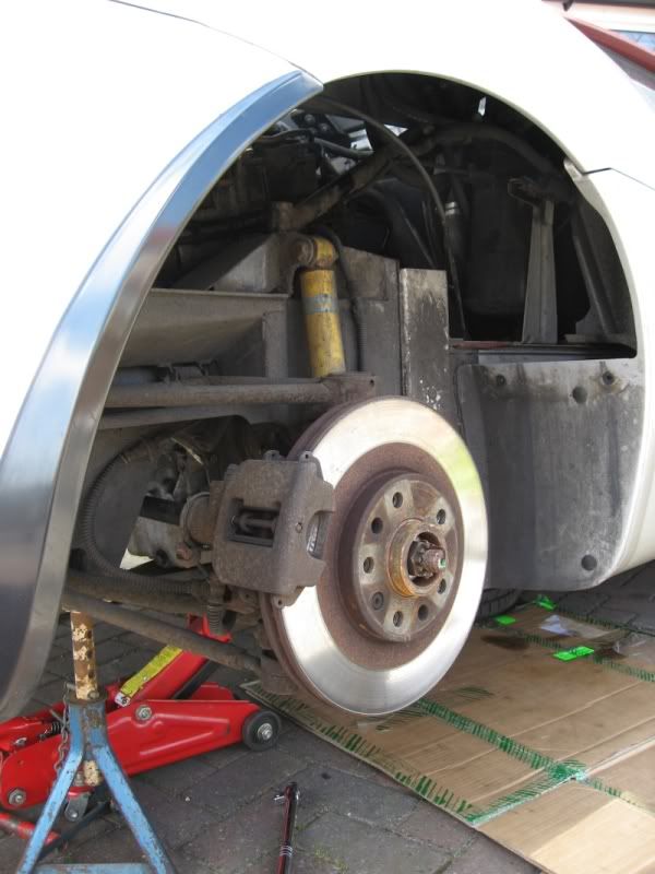

I found this thread whilst investigating how to change the alternator on my NA so I thought I'd update it on how I did mine for the benefit of future searchers...in the end it was pretty easy:
1. Jack car up on drivers side
2. Remove rear wheel, undertray and wheel arch liner
3. Carefully support the engine with a trolley jack (put a block of wood between it and the sump)
4. Remove the drivers side engine mount bracket and the rubber mount itself
5. Undo the electrical connectors to the alternator

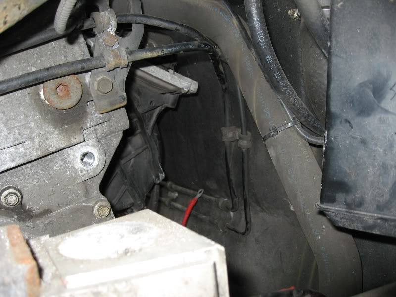

6. Undo the four bolts holding the alternator to the engine and manouver it out of the gap created by the removal of the engine mount
7. Reassembly is the reverse of removal.
Pics:
The space created by the engine mount removal, alternators already been taken out:

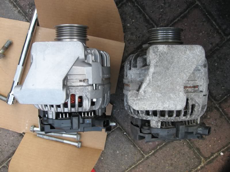

On the left the 100A unit, the other is a slightly wider 120A unit:

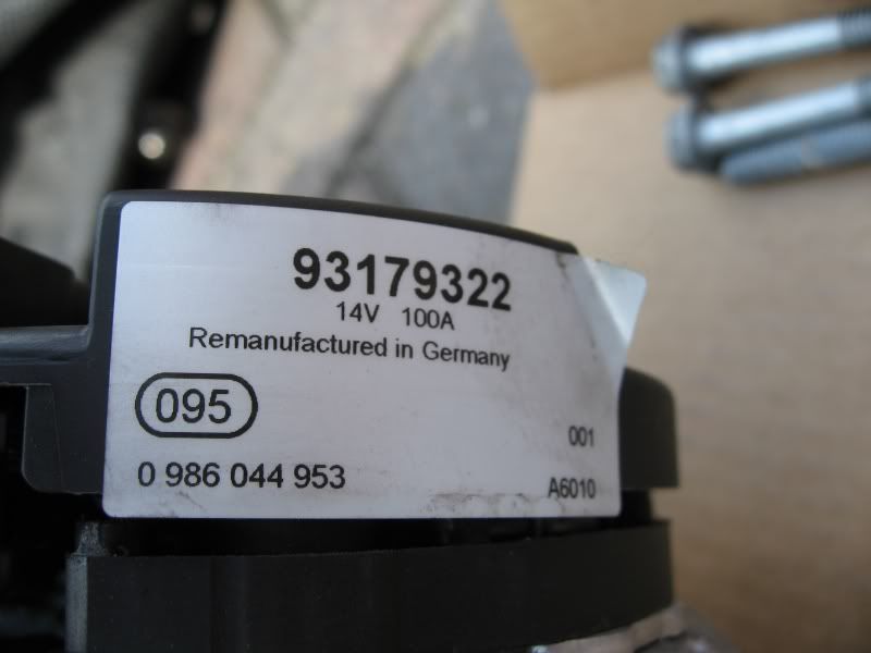

100A part number (got mine from Autovaux, very helpful they were too):
