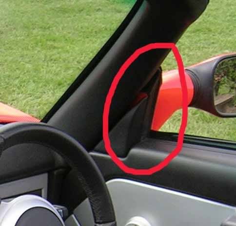

#5 mandarinvx
Posted 10 May 2007 - 01:02 AM
Do you mean this part:
If so then either your local dealer or a salvage yard is prob the best way forward thumbsup
Edit: If that is the part you need it looks like this may be the part number thumbsup
