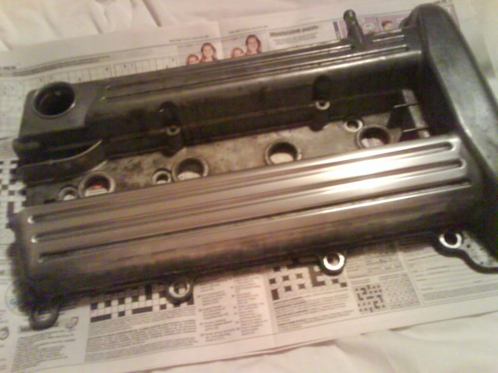

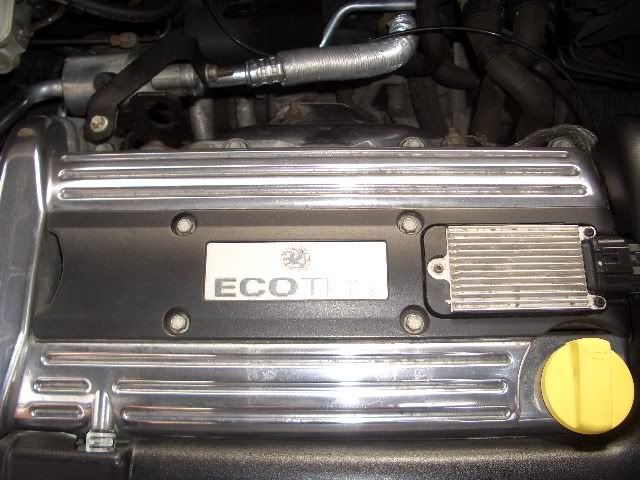

I've had enough of the oxidation all over my rocker/cam cover, so I'd like to polish it to achieve something like this:
But how do I do it?
I've found loads of polishes on ebay but I'm not sure which one to use - both Autoglym and Meguires do cleaner/polishers but I dont know if they will be strong enough to remove the oxidation, or there's also some tubes by AutoSol and AutoChrome
Can anyone recommend one for the job?
What do I use, do I have to use fine wet and dry first, and is the polish applied with a cloth or will I need to use wire wool/scourer pad?

I did that t my 182, but it was a bit harder as it had a rough surfice. I used sand paper working down the grades and then wet and dry. Then just used autoglym metal polish. It was nice and shiny by the time i sold it.

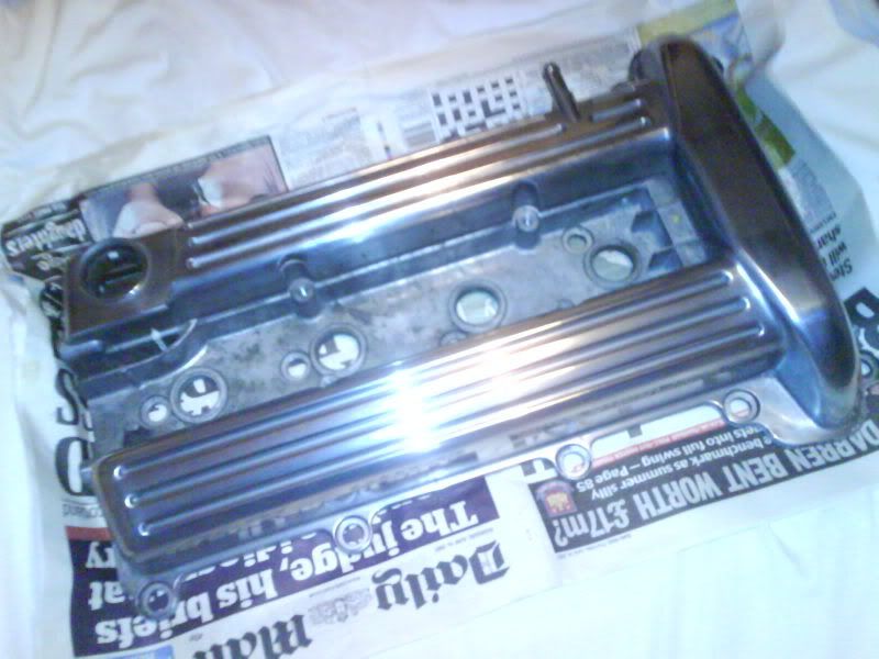

my 182 was a rough alloy casting:
progress:
finished:

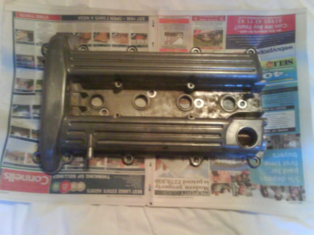

Picked it up tonight looking like this:
Very clean already to be fair
Had a quick go at polishing - at first I tried Solvol, but there's too much grime, also noticed quite a few small 'dinks' and a few scratches so broke out the wet'n'dry.

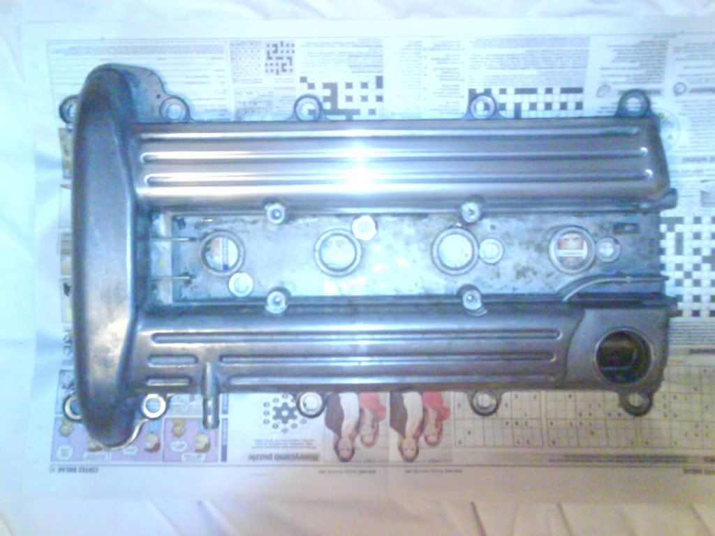

Used 180 at first to get rid of any marks, then 240, then 400, then 1200 and finished with a polish:
Looking much better me thinks :)
Okay so it took about 1/2 hour just for that small bit, so looks like I've got my work cut out for the rest of the evenings this week!
