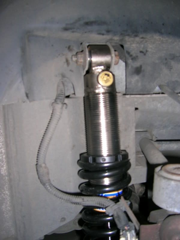

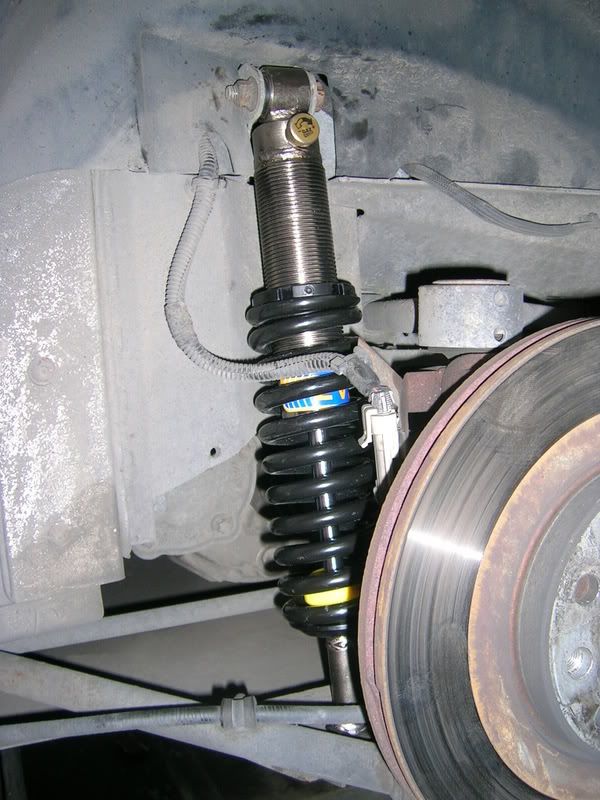

Made the trip down to Basildon yesterday to get the shocks fitted,
Really great bunch of guys down there - had a full tour of their facilities (very impressive) - they make almost all components for their shocks themselves in their machine shop - not many companies like that left in the UK!
Here's a piccy of one of the rear shocks:

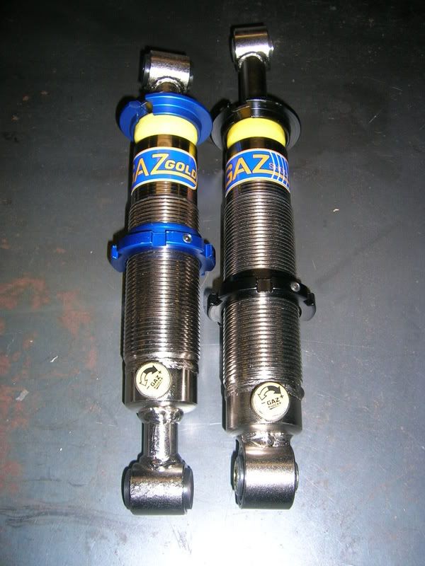

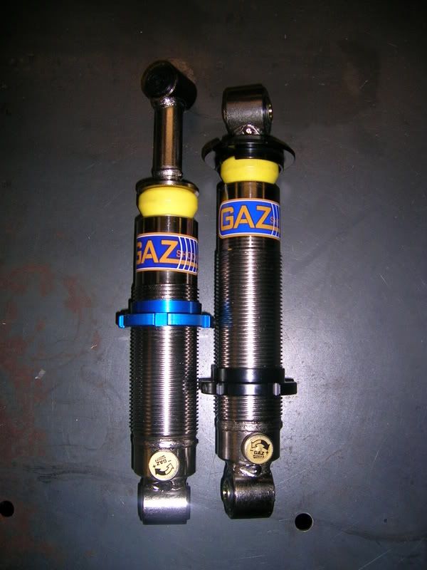

And just for comparison, a few shots of the VX220 shock sat next to an Elise s2 one - the Elise body is much longer (the VX shock is the one with black anodised spring seats)

It's great - I'd say it was better than before comfort wise - tho the shocks I took off were 6 years old (but they'll look like new with a good clean-up) Did 200 miles home but all motorway, did manage to get 15 mins playtime in Waitrose car park and the cornering seemed much more precise. I'll have to have a good play with it yet tho - and try adjusting the rebound settings on each corner. Lowered by around 25mm at the front and around 15mm at the rear so looks much nicer too! :)

I have 300lb 8" length on the front, and 375lb 8" length on the rear, so not far above standard settings - but I can now adjust the rebound too :)

You'd have to ask him to be honest - the reason he showed me the difference was because I kept houding him by email saying that he could use the S2 shocks for the VX and just change the springs, with him obviously saying it wasn't as easy as that - so he thought he'd show me why :)
