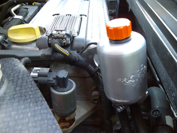

This is now fitted..

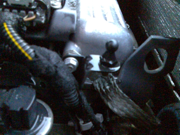

It turns out i have a bracket fitted to my car which usually is only meant for vectra / zafira... Mark at Courtenay pointed this out after he eventually got this pic.. He's never seen one on a VX220 before!
If you look in the middle'ish of the photo, you can see something which resembles a pawn from a chess set...this sits on a bracket used to secure the fancy plastic engine covers they have on these days.. To the left of the pawn is a stud with a nut on, this is one of 2 fixings holding this bracket in place (the other fixing is a bolt..) i removed the nut and bolt and snipped any cable ties then pulled the bracket clear.. With all that removed you can see how the breather bottle now sits... ive put a little thread lock on the stud just to make sure it doesnt rattle loose and used a couple of cable ties to keep the wireing loom etc away from the EGR
Im happy with it sitting here but before anyone asks there is plenty of clearance once the boot lid s closed..
My only gripe now is, the lid stands out like a sore thumb!! lol!! so will probably spray this black!
Cheers
Nick
