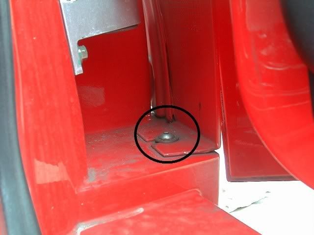

Have removed front clam to enable fitting of a new radiator.
But had a nightmare with the bolts shown below:
(picture courtest of Steve Crisp's excellent guide)
One bolt had been rounded off by someone else (TMS??) and i had to grind the head off - now left with the stud stuck fast in the captive nut.
The other side turned about 2 revolutions and the siezed, i forced it too much and the captive nut is no longer captive and spins around.
Can i get the the inside of the fibreglass side sill to remove old captive nuts and glue in new ones??????
At least i got the clam off. I thought that these two bolts would be the easiest.

Welcome to my world. Courtenay's spent 6 hours grinding off various bolts on my car last week in order to remove the front clam. I think you can get access to the underside of it by removing the black plastic sill cover and sticking your hand down into the recess. Looked like a major pain in the arse job and was glad I wasn't doing it as it took their full arsenal of tools to get the little blighters off.
Yes... they are held in with a sealant type glue.
I've put mine back together with a bolt up through the old captive nut, and a nut / washer in the gap in front of the door. I glued the old captive nut back where it came from. If I need to, I can put a spanner on the bolt head in the sill to hold it to undo the nut.
Oh, and I replaced all the nuts and bolts with stainless ones so should I ever have to do it again, hopefully it should be much easier to get the clam off.

Old thread revival :groupjump: So after messing about with loads of other bits on the car, I'm back to the siezed bolts on front clam, the two offenders are yes you guessed it, above and below the door hinge. Door is off for access, bolt heads are ground off, cill is removed. can get hand access to bottom bolt, yes the bonded nut is spinning. Question is can I punch the bolt/nut through from above? If not, how do you get the fecker out? Bolt head above the hinge is ground off, about 6mm of thread to play with. From what i can tell the rear of the bolt is impossible to gain access, what is the best way of removing this. I'm an engineer BTW [hangs head in shame] :tumble: for TT

Yes you can just punch it through then fish it out of the cill, or more likely peel it off the remaining bit of glue, I've replaced mine with rawl nuts.

Managed to file a couple of flats on edges, got a good purchase with some mole grips, won't budge with plenty of twist. I'm tempted to grind it flat (although limited room is a PITA) and either drill and tap it a couple of mm smaller, or carefully redrill it 7mm and attempt to rethread 8mm?
