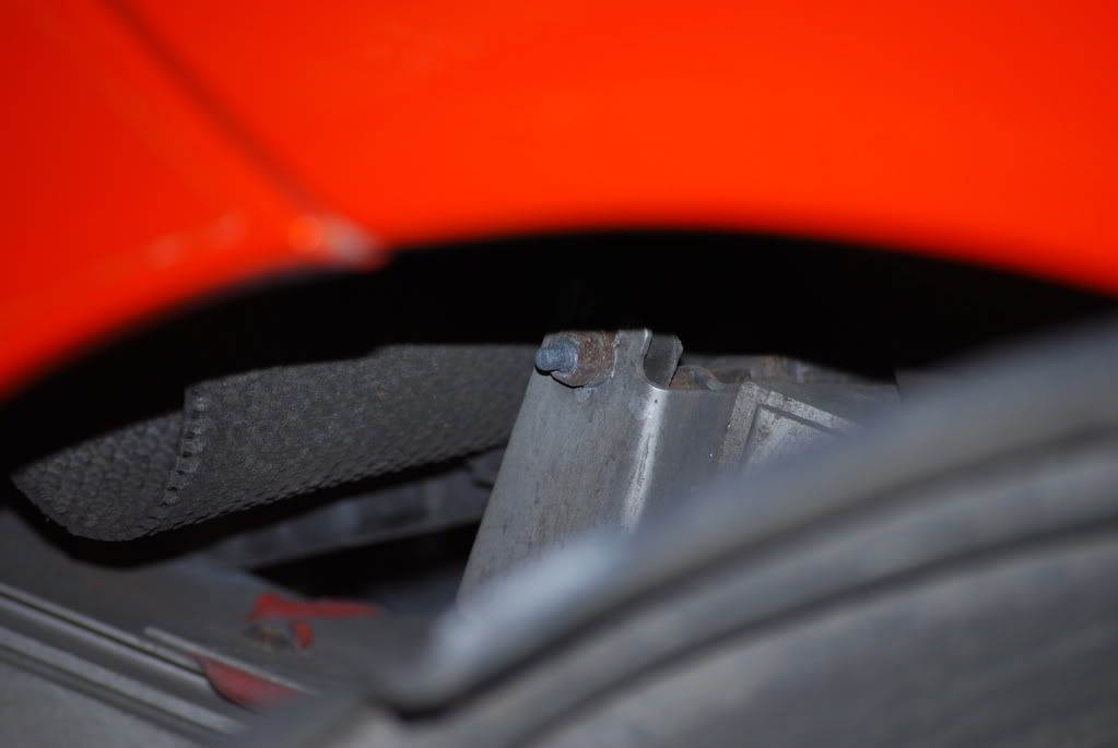

The mounting points for the airbox are on the two rear lower corners. One can be accessed through the engine bay; the other is best accessed through the rear wheel arch, and is the one that tends to break, this mount is shown in the pic below:

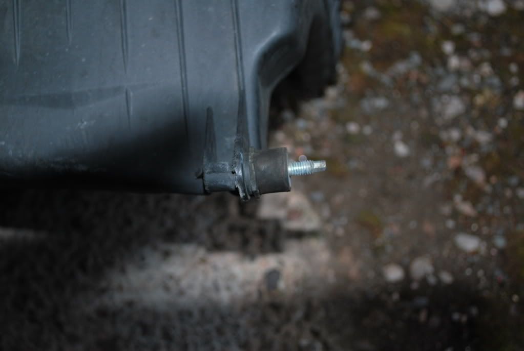

This pic shows the intact mount (without the nut) ie what it should look like

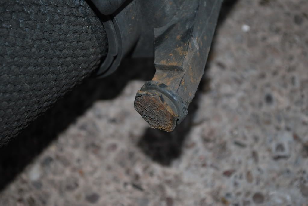

And this pic shows the broken mount, where the rubber has sheared off, letting the airbox 'knock' up and down

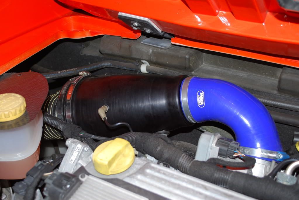

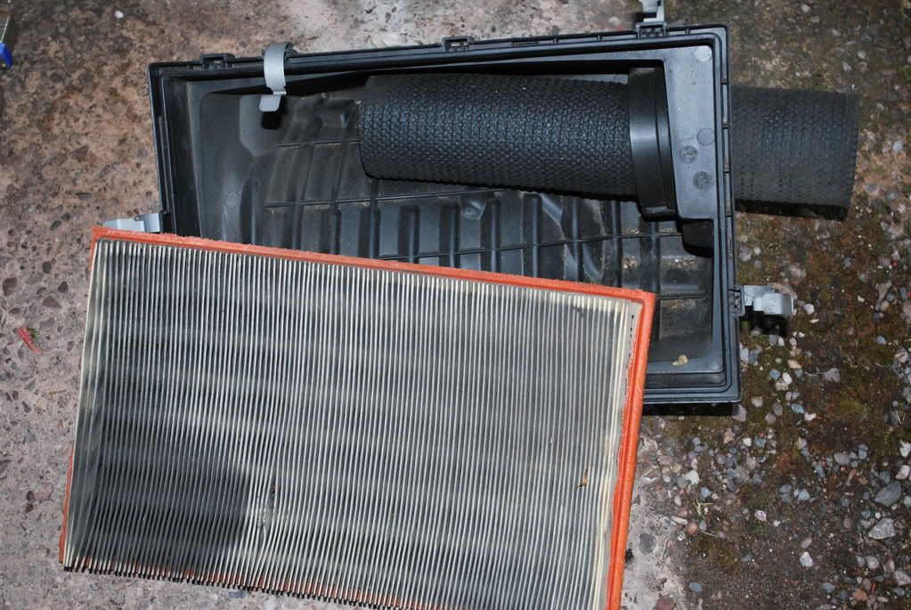

The pic below shows how little of the filter element is used due to the stupidly long pipe Vaux chose to use on the intake :rolleyes:
And this is the new system, unbelievably loud!
