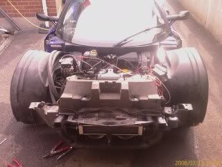

I bought Duncans TMS Charge Cooler kit when he changed it out for the Pro-Alloy kit. (no debate over which is best plz)
I fitted it over the weekend, which was much fun :huh: I wasn't expecting the hoses to be like something that should be hanging off the back of a fire engine and there's quite a bit of my skin left in the car after getting them into the sills, but its all done now..

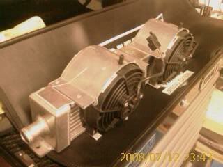

The only thing I changed was adding a couple of spal fans (from an Aprilia) which are very effective and the charge cooler is very cold to the touch at all times when they are on, there is also a beneficial cooling effect on the main radiator thumbsup
There is not too much info on here on fitting the TMS kit so I have a couple of questions.
Is it necessary or beneficial to move the air temp sensor from the top of the intercooler to after the CC unit?
The motor on the water pump runs quite hot, is this normal?
I am running TMS St2 with a VXR turbo, so the CC should at least maintain the power I would expect from that. Do I need any additional mods (apart from a remap) to take it up a stage?

The small fans on the CC rad are switched from the dash (preventing heat soak was the thinking behind fitting them) and I'll fabricate something better to support the header tank and pump.
