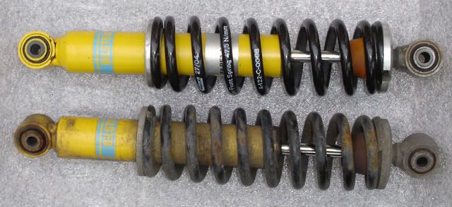

The front measurement I am fine with as the standard VXR has a 367mm measurement so I expected a small lift. Suspension looks very similar:
The rear, however, was a real shock. 3cm on top of the standard gap is really noticeable. The only positive thing you can say is it introduces a rake to the car. Trouble is, that's like saying a BMW X6 is a coupe .... I put it down to the way different rear springs:

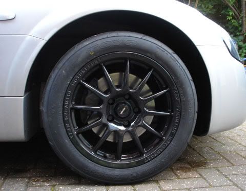

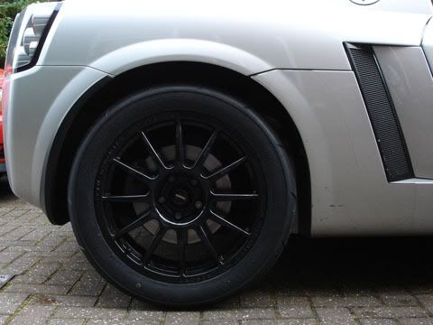

OK ... I need to get you the measurements but I just snapped these before I put it away. Couldn't get far enough away for both wheels at once ;) I'm sure the rear is not as high as cars on Exige suspension and that's why I'm thinking you need Exige stuff for an NA and VXR stuff for a Turbo.
As I mentioned, it's the rear that is really bugging as I was mentally prepared for the front!

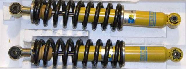

However, look at this comparison. First pic is Exige suspension as fitted to toreide's car. The second is the VXR stuff on mine.
You'll notice that they look the same except the VXR stuff has 3 grooves in the damper mounting and the Exige has just 1. Perhaps this is because Vauxhall simply re-machined the Exige stuff to fit? If the spring platform of my VXR damper could be moved to where the Exige one is, they'd look the same. My rear ride height would then fall (as I understand it) and I really would then have 'Exige' suspension!
How can I do this? Do I simply buy a spring compressor and then it will all become obvious?? Edit: and if so, is this what I need to buy?
