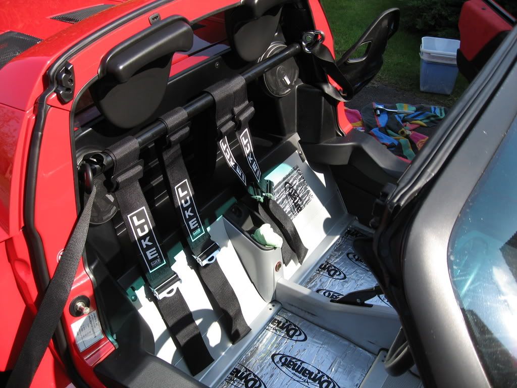

Can a bolt in bar be used as a bar for wrap around harnesses? Or will there be any issues with that set up?

Il have some lightweight race seats by the end of the week, so will have the cut outs etc... From the digging around ive done it looks like wrap arounds are the better option. Ive just been offered a bolt in bar at a good price and so wondered if there would be any issue using the bolt in bar with wrap arounds? Would the bar be weaker not using 'eyes'? Would the threaded part of the bar get in the way? Hope it makes sense :rolleyes:

sorry, theres 2 types of harness bar. A bolt in bar where the harnesses are bolted in, and wrap around harnesses where the harnasses wrap around the bar.

I was running the bar with wrap around harness'. In fact the wrap arounds take upless space than the bolt ins.

The bar fits below the "pads". It bolts directly onto the seatbelt mounting points. Looky here:
