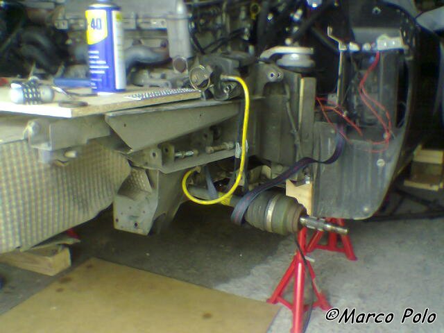

To raise the rear of the car, personally I do the following :
- raise one side of the car (right side for example)
- put a thick piece of wood under the right wheel
- lower the car and move jack to the other side
- raise left side
- remove left wheel
- put a stand axle under the left rear jack point (subframe), with a piece of wood to protect*
- move the jack to the right
- raise car
- remove right wheel
- put a stand axle under the right rear jack point (subframe), with a piece of wood to protect*
*or under the extremity of the chassis (if the underbody/diffuser are removed)
If I want to raise the car very high, I repeat the jacking operation (left/right) to increase axle high
Basically I avoid a have a too big difference in height between left and right...
If I need to work "hard" under the car, I add 2 axles under both central jacking points (so 4 axles all in all)
