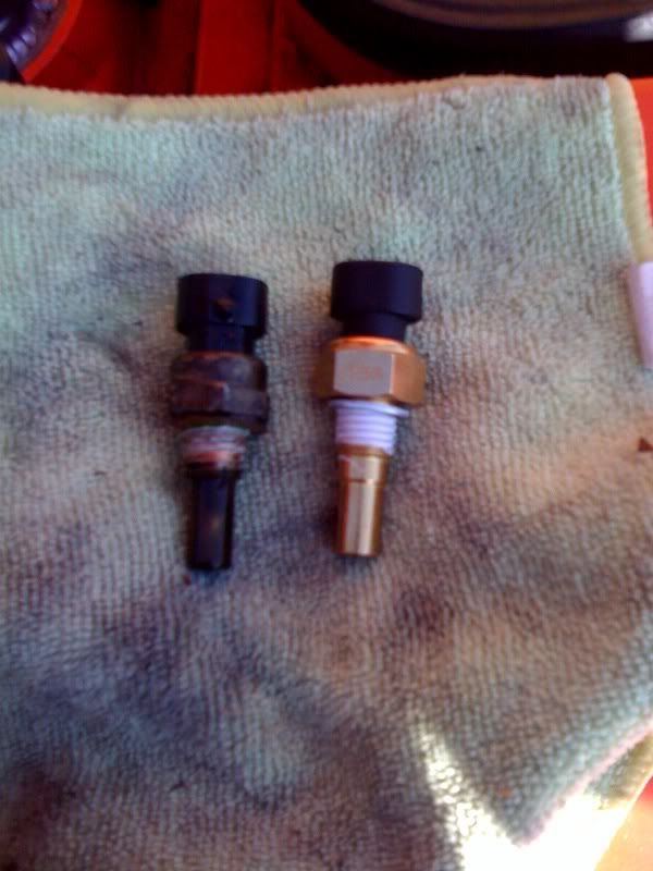

then thought i would change the temperature sensor

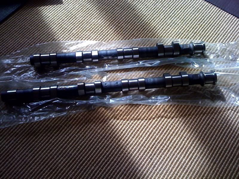

then i thought i would also treat my car to a little present, some nice new shiny supercharger comp cams

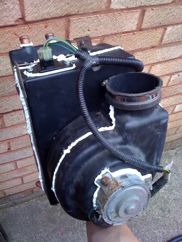

here is a new fully sealed heater :) (i was lazy and bought a 2nd one to seal it and then swap them round!)

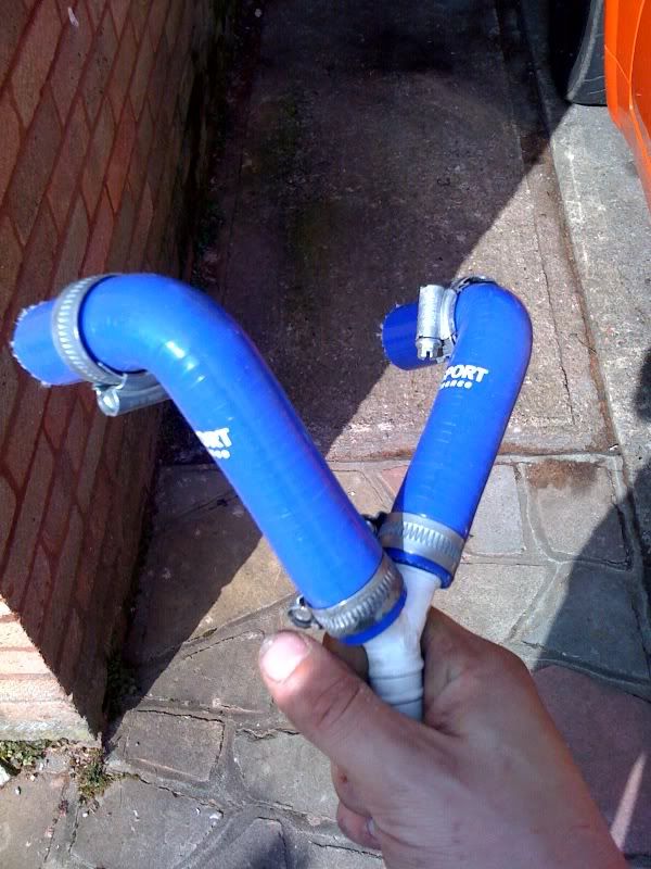

then off to the scrapyard i went for some funky shaped pipes that i wanted. my water system is a little different to everyone elses... i am using my heater pipes as charge cooler pipes to save on a few kgs of weight ( poof ) and have decided to plumb my heater into my charge cooler system, this allows an extra 0.5L of water in the charge cooler system plus a 2nd radiator (twin chargecooler ;) )
this is the pipe that i came back with and it is utterly perfect for the job! goes from the heater matrix to the charge cooler and i couldnt be happier with it :D
then to connect the pipe up from the ali heater pipe to matrix
