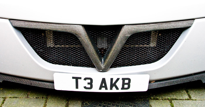

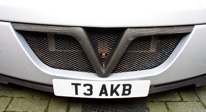

like this.. Attached File  grill.jpg   134.91KB   4 downloads

Good thinking about the brush. I'd considered spraying mine but didn't want to get the chargecooler radiator covered in paint. Any special kind of hammerite? How long does it last?

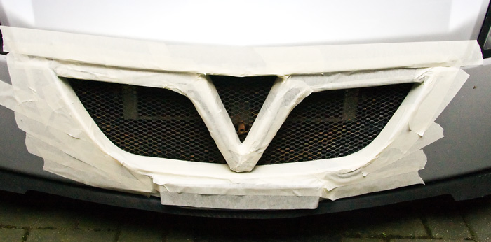

Small paint brush and just masked the inside of the clam vent with masking tape
