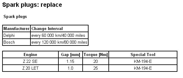

Found nothing in searches Anyone know what they should be on NA? thanks :D

20 N-m / 15 lb ft not always 100% accurate btw just use your head ;)

It also depends on your plugs, for example if you have Denso plugs such as the IK/VK 20/22's whicch have the squishy stainless steel gasket then this table sholud be useful.
CLICKY
