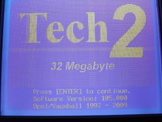

My abs light is on.....again. :rolleyes:
I've been thinking about a tech2 to properly diagnose it but boy are they expensive. I spotted these
http://cgi.ebay.co.u...iag...:1|294:50
Has anyone used one? Does it do full tech 2 diagnostics or is it just an obd code reader?
Thanks
#2 slindborg
Posted 24 June 2009 - 07:32 PM
chances are its the dodgy hungarian part version of tech 2 which amazingly dosent work.... I even tried it with a proper KWP2000 interface I had where I used to wok. for the small cost, its worth a gamble, but I really doubt its much more than a simple OBD-II reader

SPX Reduced Pricing for Tech 2 with effect from 1st December 2007. The Tech 2 Kit, SPX Part No. 7001083-32 has been reduced from £1708.90 to £1524.30. The Tech 2 Reduced Content Kit, 7001090-EU, has been reduced from £1425 to £1282.15 The above prices are exclusive of VAT. The Tech 2 Reduced Content Kit is aimed towards Vauxhall/Opel Authorised Repairers who require one or more additional Tech 2 units but do not wish to purchase multiples of all the accessories. The Reduced Content version contains the following items and is supplied with transportation packaging: - Hand-held Tech2 diagnostic tester - DLC cable 3000095 - 32 MB memory card 3000118 - SAE 16/19-pin adapter 3000098

Tempting as a tech2 interface is at over £1000 :o , I think I'll stick with my OP-COM interface that cost me £40 that has all the functionality of the tech 2 thumbsup

I know that the VXR220 can only be done with a Lotus tool, but all other VX's are done with Tech 2.
