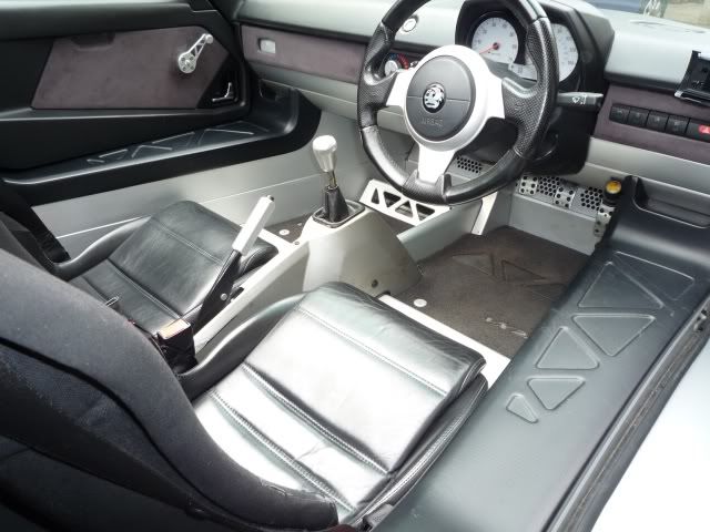

Posted 29 June 2009 - 07:31 AM
Something thin like a wire coathanger, earth wire from some 3 core or thin allen keys will do. Do one side at a time, use the stiff wire (or whatever) to ease the unit out then use finger nails and yank the rest of the way.
Better than spunking money in Halfords if you only remove the unit once.
I used those little mini screwdrivers. Take off the faceplate, and then the plastic trip piece.
Yeah, mine not going back in either. Thankfully I have a set of no radio dash plates. thumbsup
