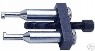

Lifting this thread, I've had a hard time removing the steering wheel boss and finally have found the solution. It felt like I would warp the steering wheel before the boss would come off the last time I did this. Hitting the nut as suggested in this thread is a BAD idea, this might shear the plastic internal parts of the collapsible steering column.
This tool is what you want, BEFORE you try to remove the steering wheel boss. It's made for the task and fits perfectly!
eBay link Laser Vauxhall steering wheel removal tool

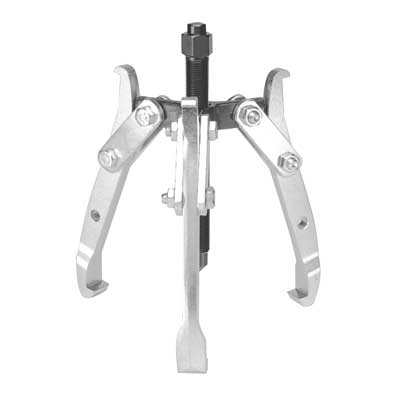

#14 Zoobeef
Posted 27 July 2010 - 02:30 PM
I'd always use a puller on a steering wheel from the off. Sweated enough times hanging off one to then have to go and get the puller anyways haha
