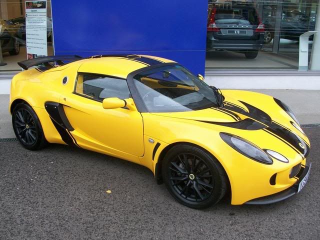

  • 9,157 posts
Posted 21 August 2009 - 03:19 PM
#10 Alex L

Posted 21 August 2009 - 03:23 PM
That Europa is parked next to my new toy at Lipscomb Lotus...can't wait to pick it up tomorrow.
#11 peteepots
peteepots
  • 25 posts
Posted 21 August 2009 - 03:27 PM
Cheers SteveA. I see what you mean now. I do like the look of the Europa!
