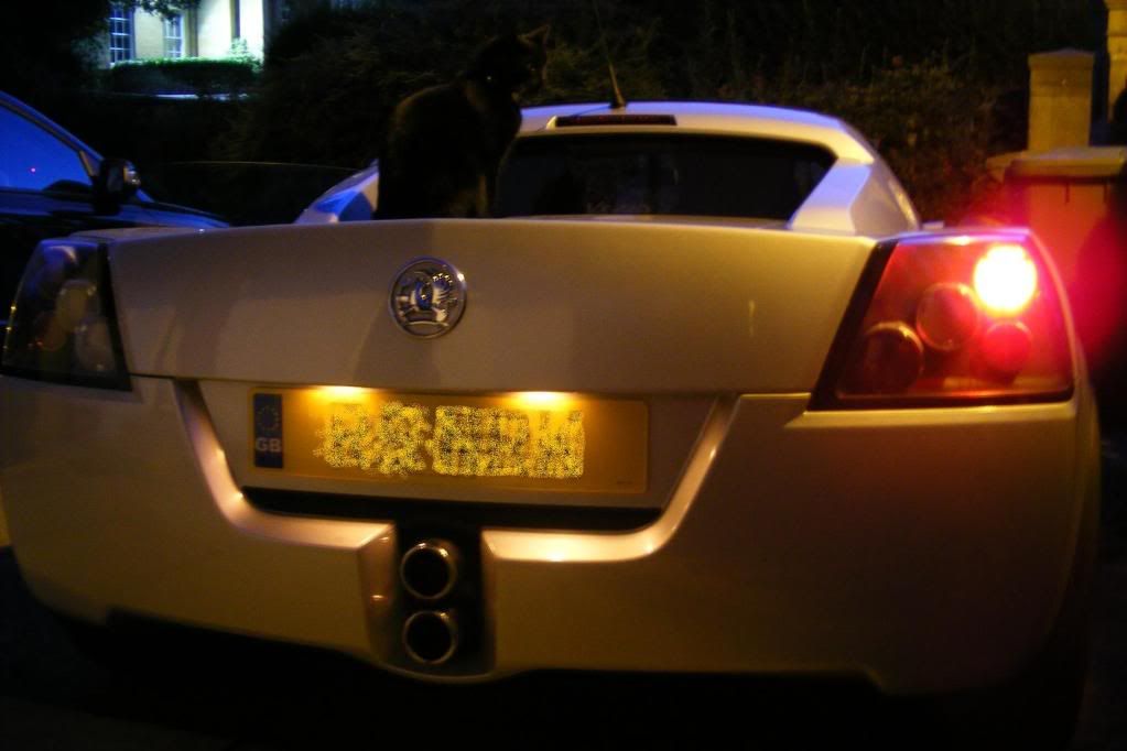

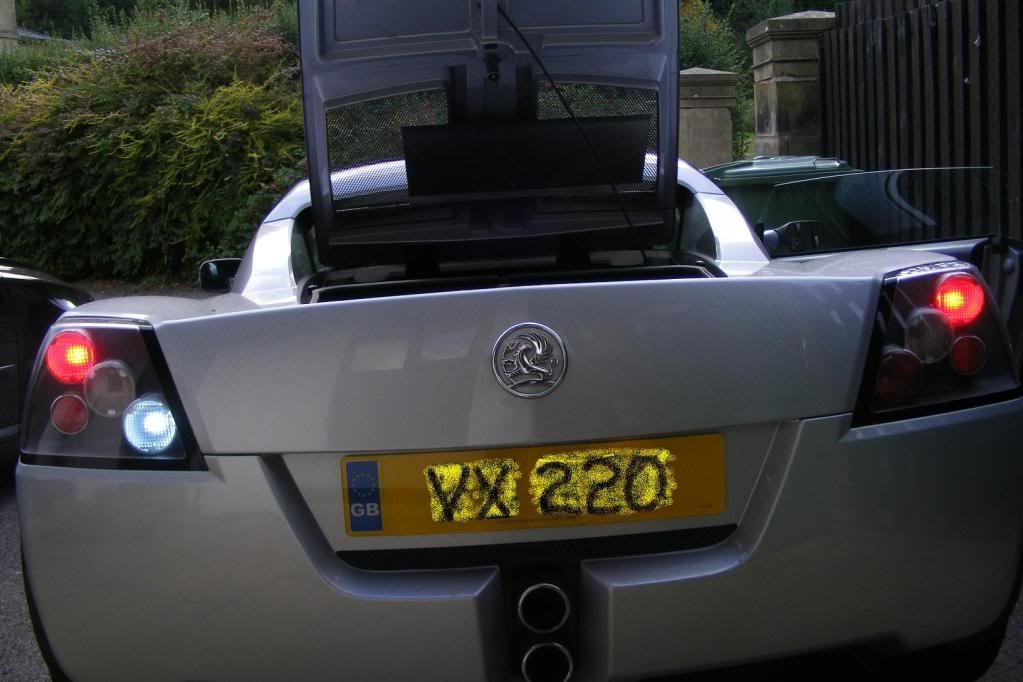

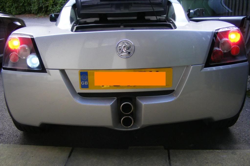

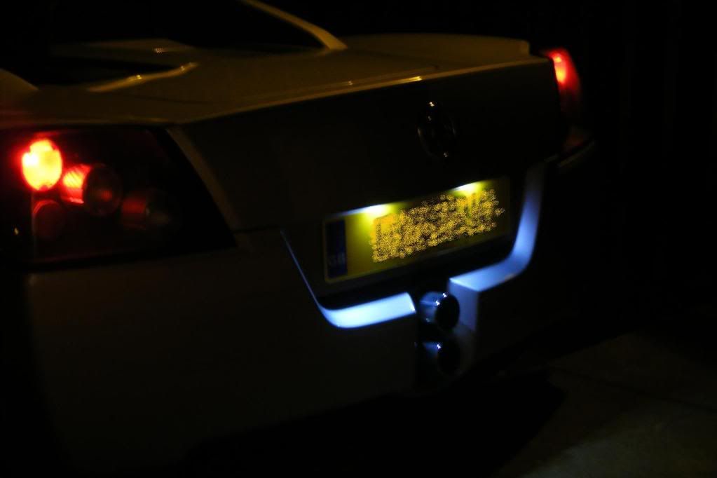

Well here is what I ended up with, photography skills are useless but you get a slight idea of the difference. And I probably should have taken the pictures in similar light :beat:
Old bulbs:
New LED
The stop/rears were these, with hindsight I would have gone for the multi type with some LEDs pointing sideways onto the reflective dome. but they are very bright and more distinction between brakes on and off than the old bulbs.
But I must add I sent them back because they fell apart in my hands.
Festoon internal and No plate bulbs were these:
The end result is that I quite like them, with hindsight only the white bulbs are really worth changing, coloured ones seem very similar.

Thats the bit I am most impressed with, link to the ones I got off ebay below, though I suspect theres many more places to get them.
http://cgi.ebay.co.u...e=STRK:MEWNX:IT
If anything they are a little short I would get next size up around 40mm.
At first I thought they did not work but turns out they're polarity sensitive.
