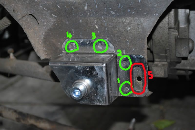

I had a look at fitting the Spitfire kit today,
First off, I'm presuming this is in the right place (nearside)
The kit is supplied with 4 bolts for each side to attach the braket (is this correct?) So I'm presuming I don't add a bolt to the hole that is already there through the slot, shown as number 5 in the pic?

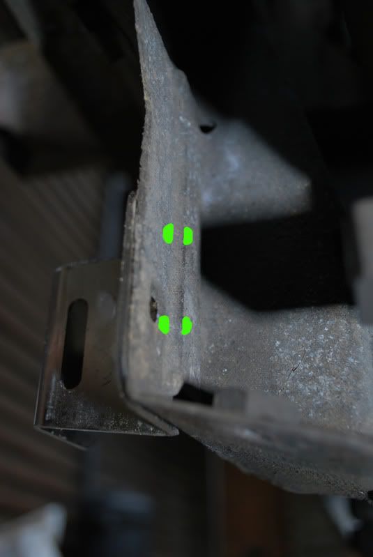

The thing is, holes 1 and 2 line up smack bang centre with a part of the subframe where the support plate/leg brace is welded on, meaning if I drill through at this point it will be right where the metal is stepped - I've tried to take a pic showing what I mean:
This will mean that the washers will only be clamped on half of their surface - is this right? (It may well be the way its designed, but thought I'd best check :unsure:)
As hard as I tried jacking the hub side connection in different positions the ball joint just keeps spinning, so it looks like mr Dremel will be putting in an appearance for that part :D
#2 vocky
Posted 27 September 2009 - 07:14 PM
yes thats about right, the washers will take up the step ok, not perfect but :rolleyes:

Yep, it's only 1 and 2 that come close to the crease in the metal, of course if you have the brace kit them those 2 bolts/holes are not needed.
