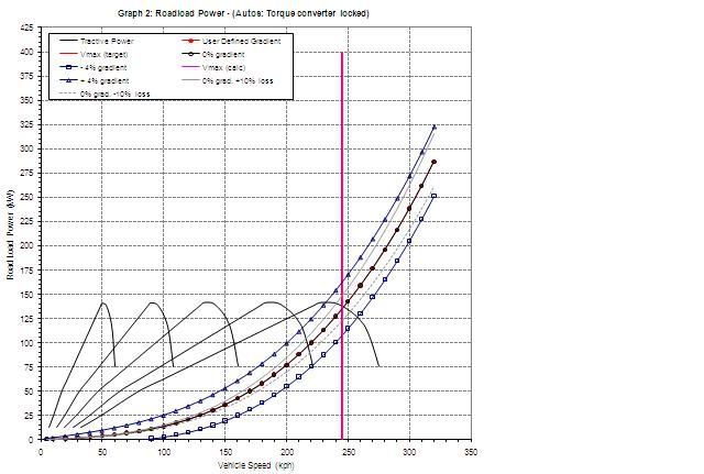

A plot of Roadload Power, as I had a bit of time, based on standard VX220T ...

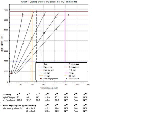

And Gearing

Hasn't the turbo got a 3.63 fdr :unsure: I thought it was the NA that had a 3.95. Putting in the 3.95 to the Turbo would increase the 0-60mph time due to the extra shift of 2-3 to around 4.9sec from 4.7sec, but does reduce the 50-70mph in gear times by around 0.5sec. Vmax stays around the same. Going longer to 4.1fdr only really improves mid range acceleration at the expense of Vmax (~145mph@6500rpm :blink: ). Going 5.1fdr gives a Vmax of around 120mph. 1-2nd gear shift would be at ~40kph, 2-3rd ~70kph. A bit low to me, but each to their own...

As you say though, you would need some serious power to reach 200mph, check out my previously posted roadload curve...
