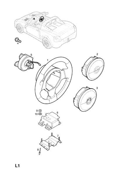

I need to remove number 5, in the below pic. Anyone know how to?
