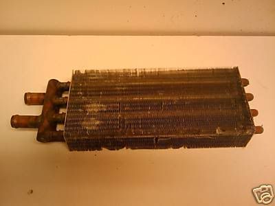

VX heater matrix
#8 Mangham54
Posted 13 January 2010 - 10:42 PM
I am no talking about the rust here, but that looks so shoddy it is untrue!
