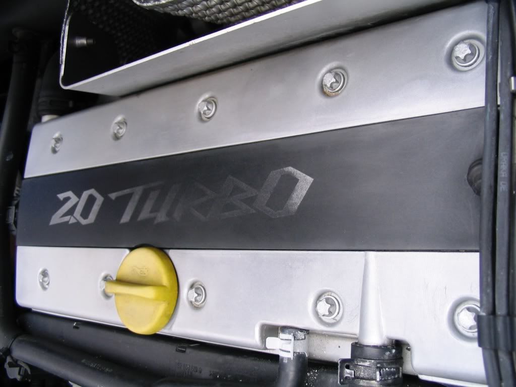

Hi, My rocker head cover screws on my turbo are going rusty, and it looks crap thru the engine grills. Anyone replaced these? If possible, a part number would be appreciated, or linky to ebay alternatives Much obliged

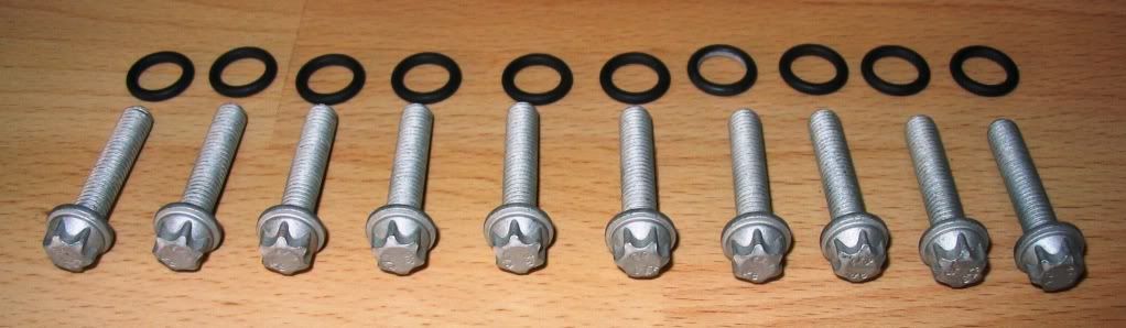

The part number is 11098761 and can be found here: http://www.speedster...sket/index.html Price is less then £1 each :)
#3 Zoobeef
Posted 21 April 2010 - 06:53 PM
There torx M6x30 part no. 11098761 Also lists o rings on each one, part no. 90528438 you prob dont need them but they maybe cheap. You need 10. Its on my to do list to so let me know a price if you get some. Also if you do one at a time you wont disturb the rocker gasket

Bolts (11098761) are 46p inc. VAT each
O rings (90528438) are 2.59 inc. VAT for 10
So grand total of £7.19
From Autovaux
10 Bolts and 10 O Rings - All in inc. VAT = £4.70

Picked them up from AutoVaux at the weekend. Normally between my neighbour and myself, we have a good selection of tools. But no joy on these bolts. I guess I need a torx socket? But I don't want to buy a set, as I've never used torx sockets in my like. Torx keys yes. 1. So what size do I need? 2. What torque to I need to tighten them to? Obviously not 15nM !! 3. And where can I get one? Ta muchly.

Here's the problem:
Here's the solution:
Thanks to Zoobeef. 5/16th" socket is absolutely ideal. The bolts were easy to get out, hardly torqued at all. I did WD40 them the day before though. On replacement, I just nipped them up and then quarter turn. There were no o-rings on the rusty bolts I took out.
I cleaned the rocker cover up with white spirit, and then used brasso and a small suede (wire) brush, to scrub the rusty hole surrounds up.
On fitting the new bolts and o-rings, this is what happens to the o-rings:
So that's why there were non fitted! Don't buy them. Save yourself a quid.
