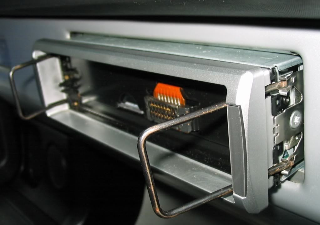

The radio has sprung clips holding it into the dash which you need to depress to withdraw the radio.
Remove the front panel of the radio first ie the bit that drops down for you to insert Cds
To remove the radio I made a couple of removal tools out of wire coat hanger material. Simply cut 2 x 8 inch lengths and bend them into u-shaped hoops. Insert them in the holes which are in the top and bottom left and right edge of the radio. Push them in gently until they are fully home. Then gently apply a little outward pressure to each wire hoop to depress the spring clips. If you have done this right the radio should slide out by pulling on the hoops.

Here's a piccy of the radio being removed. Hope this helps.
Edit: Doh! Too late.

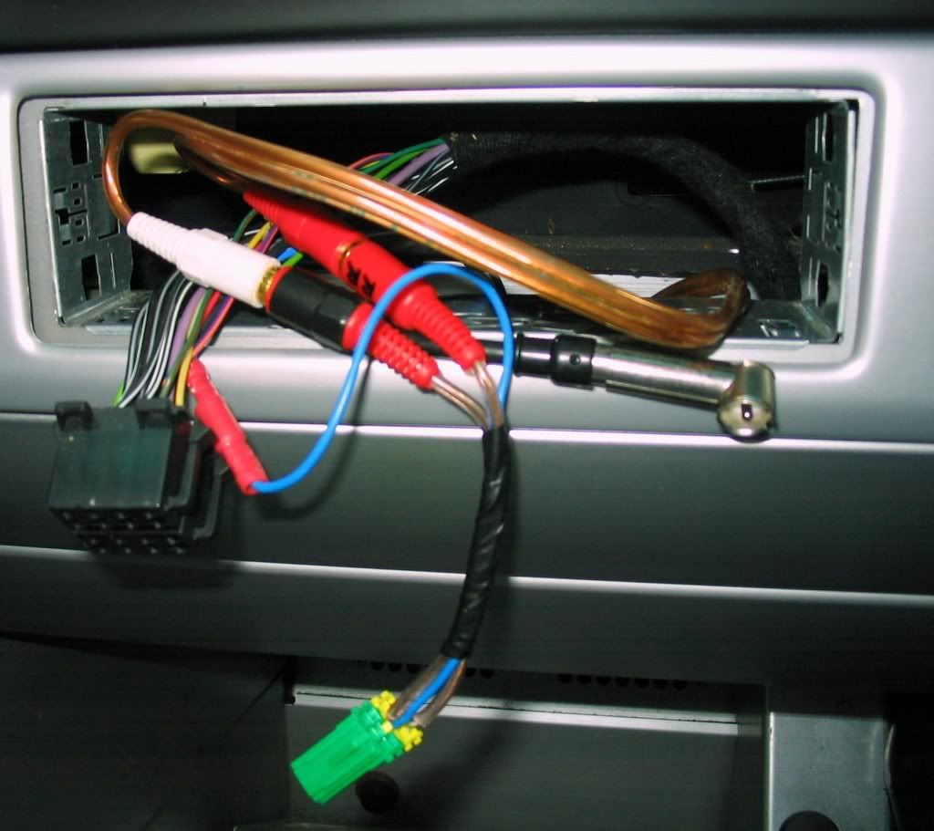

Ok. So the lug on the cog finally broke off completely. Thought I'd give it a bodge before I started ordering bits from Blaupunkt mainly because I'm a tight Yorkshireman. Here goes:
Took the head unit out:
This is what's behind it. I have a pioneer subwoofer fitted:
