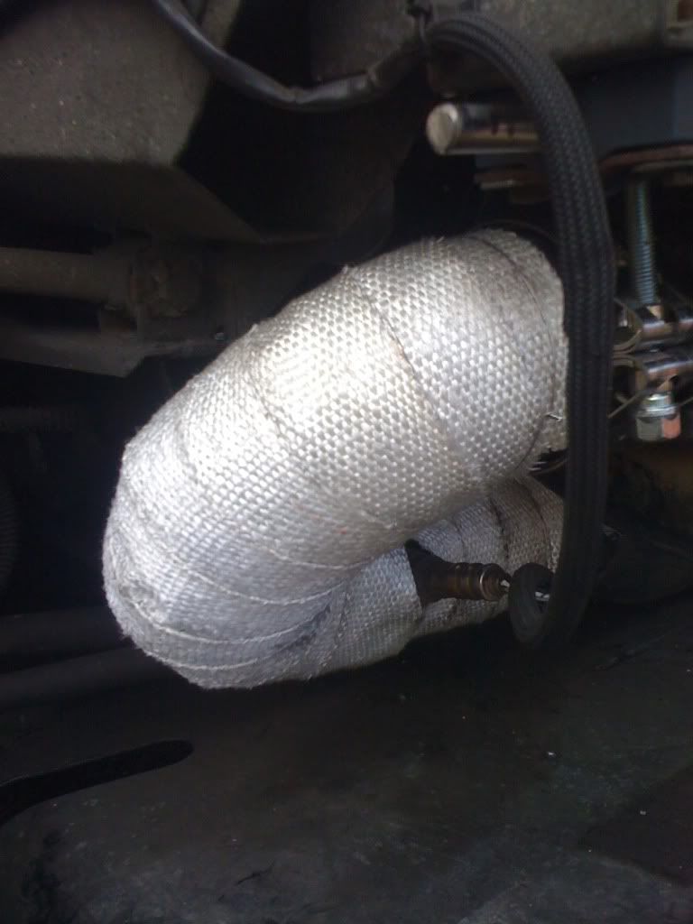

In the quest to find a rattle discovered that the u-bend heat shield just before the back box (the one you can see through the rear passenger side wheel well) had pretty much disintegrated. Chopped it out and did a search for potential heat problems but the general consensus appeared to be that it was safe to run without a replacement. Am I right in thinking that aftermarket exhausts don't have one? Anyway that was about a month ago now, just noticed some rippling on the rear clam at about the level of the u-bend. Also the rear suspension is squeaking a bit more than usual (probably!) Is heat wrap an option or should I source a new/second hand shield? Cheers, Dave thumbsup Ps It’s a turbo, innit.

yes you can run without it although it is best to run with one as it will heat up your tyre/brakes etc
did mine yesterday

I got some cool it Thermo Tec wrap that I will be putting on, quite expensive but proven. I have used some cheap stuff I got from ebay in the past but it was crap. You pays your money...
Also since fitting the piper manifold I haven't run with a heat shield on my car (20k+ miles). Been checking the rear clam for signs of heat but seems fine.
The whole exhaust system will be wrapped when the rear clam is taken off and some nimbus sheet and 3m heat reflective tape will used.

When you handle the stuff make sure you; DO wear gloves DO wear something with long sleeves DON'T rub your eyes DON'T do it in your living room unless everything (EVERYTHING) in a 2 metre radius is covered in a dust sheet Cut the stuff to manageable lengths first and untwist it so it's easier to wrap Get the stuff wet either in a bucket or using a plant water sprayer Secure using lock wire rather than expensive metal cable ties 1" wide stuff is easier to apply to bends than 2" but if you are just doing the u-bend then it won't make much difference, manifolds are tricky though And, especially true if you wrap the manifold; When you first start the car make sure the roof is on and the doors and windows are closed as glass fibres go everywhere It will smoke for quite a while and it will smell

I used the FEI stuff. Very good but be carefull how much you wet it. You can wash out some of the "stuff" that makes it good. I bought some white heatwrap from fleabay and I tested it first. Glad I did as it melted!! You have been warned.

I used 2 rolls of 1"x50 feet to do manifold, downpipe and u-bend.
