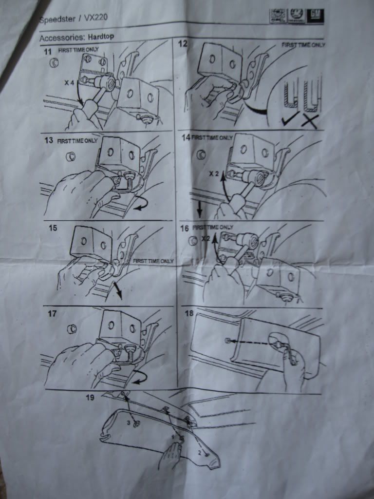

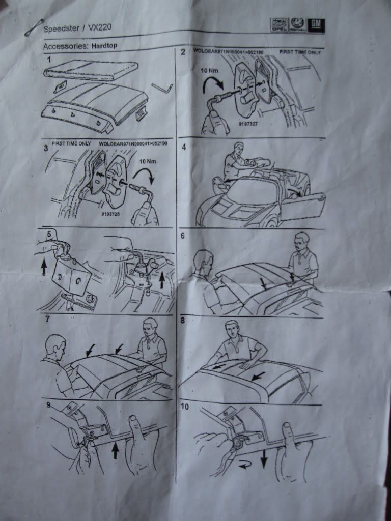

Posted 12 June 2010 - 09:51 AM
This is what i had with my H T chinky chinky

Posted 12 June 2010 - 09:57 AM
Makes mine look even more pikey :lol:
No need to send pdf will print these out, cheers thumbsup

Posted 12 June 2010 - 12:58 PM
Those pics / diagrams make the fitting of the hard top look far more complicated than it actually is! Posted Image
