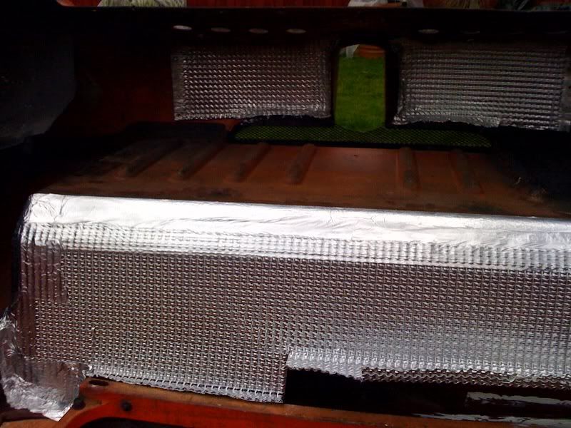

Posted 14 June 2010 - 03:18 PM
I lined the underside of my boot with aluminiumised 3m backed fibreglass - there are some pics in my project thread :) keeps it really cool now thumbsup but I still have the exhaust shield in place although to be honest I think youd be better off looking for a secondhand proper exhaust heat shielding

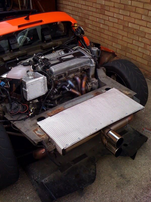

#4 The Batman
Posted 14 June 2010 - 05:43 PM
this is what i have done :)

Joe, is the exhaust shield/cover nimbus over an ally sheet? I like what you've done there as I'm not too keen to enclose the exhaust again after modifying the rear arch liners to get better airflow into this area.
I took my car to be MOT'd today after lying idle for the best part of 2 years and the clam was pretty hot around the tailpipes, after a 25 minute drive. Shielding on the inside of clam and a heatshielded panel over the exhaust looks a good compromise between maintaining airflow and shielding the fibreglass from direct heat sources.
PS My car breezed through the MOT, even with rusty brakes, 2 year old petrol and it hasn't been serviced for over 3 years. Got to love these cars :)
Nope, tis not over an alloy sheet, it is supported at the back and sides by the subframe and across the back by an ally bar.
