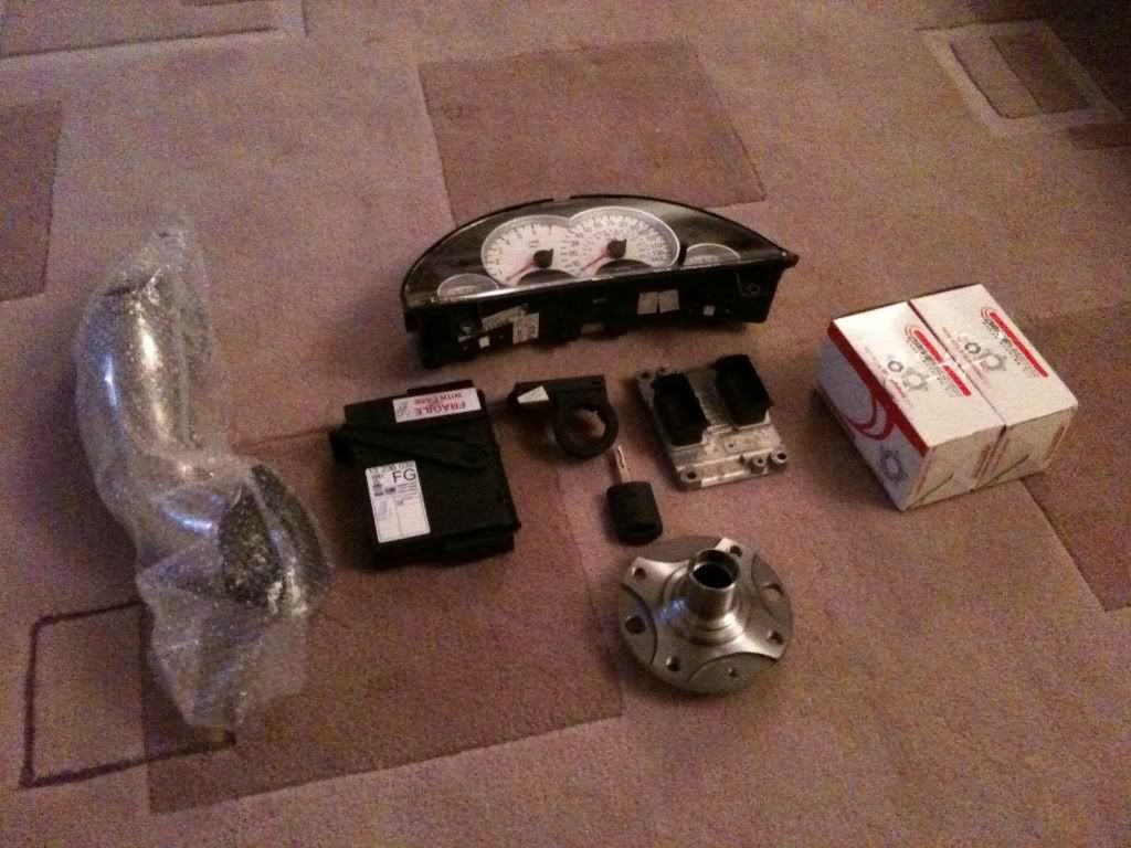

Before I'd even bought an engine I started gathering bits up for the conversion...ECU set up, conversion hubs, new wheel bearings and a pre-cat pipe

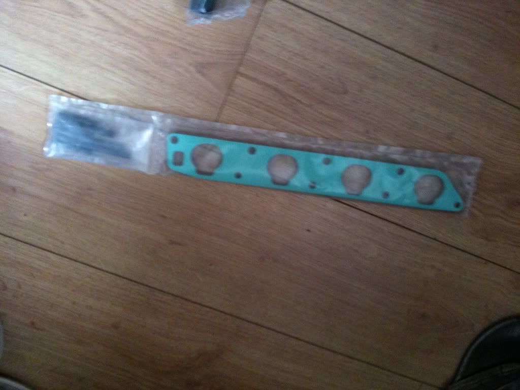

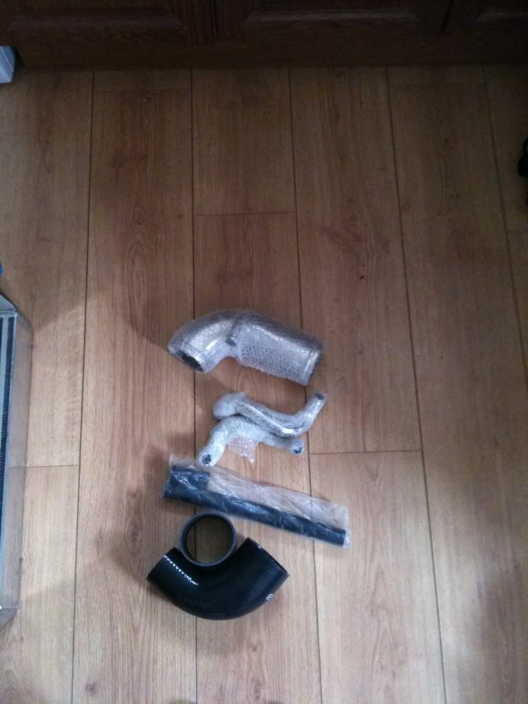

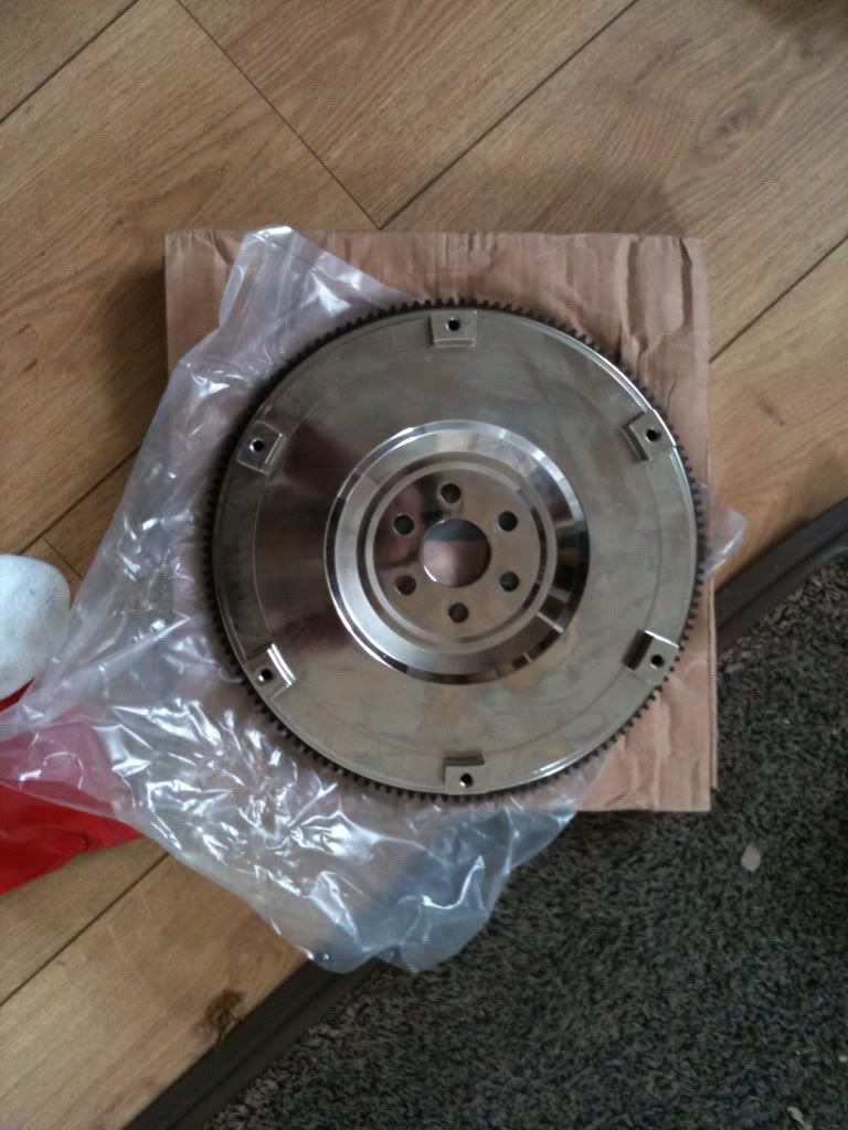

Then bought a front mount intercooler kit with enlarged top hat and 63mm boost pipes. Also got a thermal inlet gasket, crossover removal kit and a lightened billet flywheel.

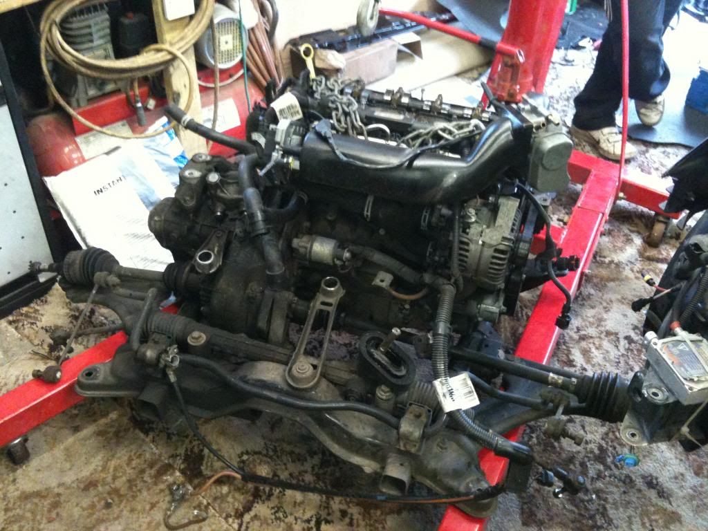

Started removing bits from the 1.8

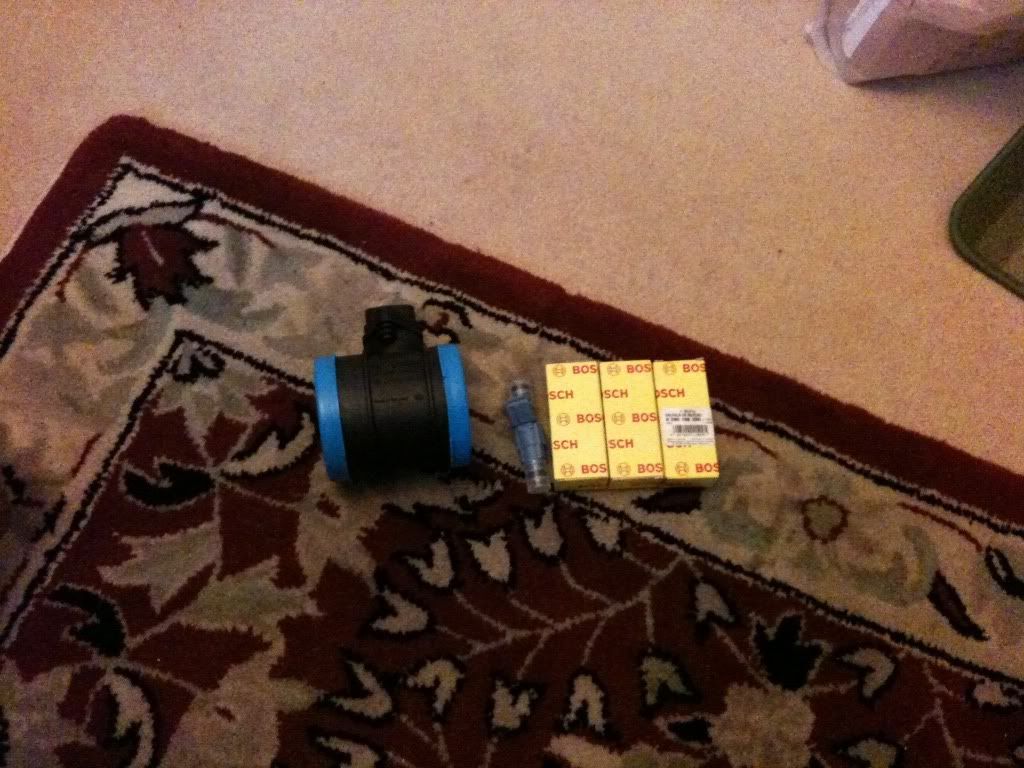

Then came across some brand Astra VXR injectors and a brand new 80mm afm for bargain prices

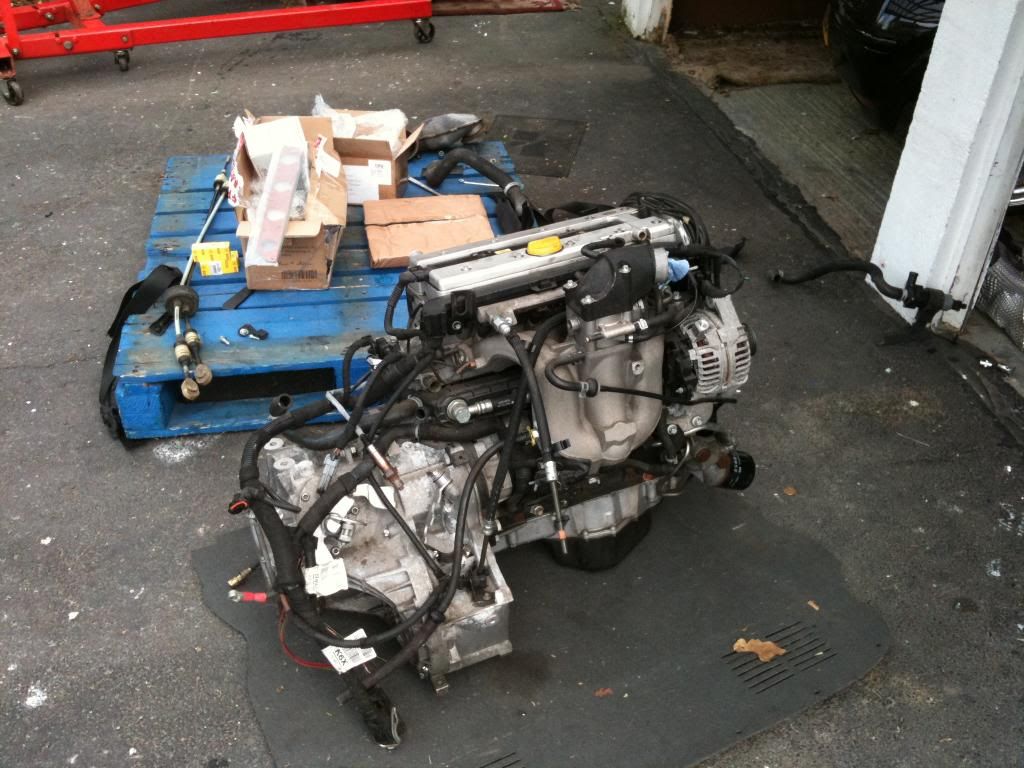

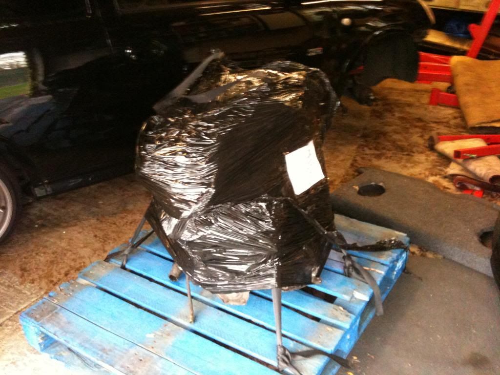

So then this turned up...wonder what it is ;)
My new engine from a VX220 Turbo with only 7500 miles!
Then the fun stuff began!

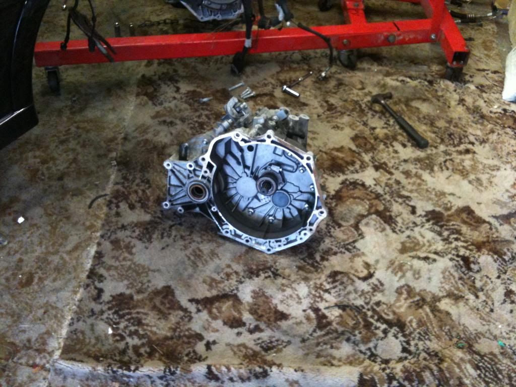

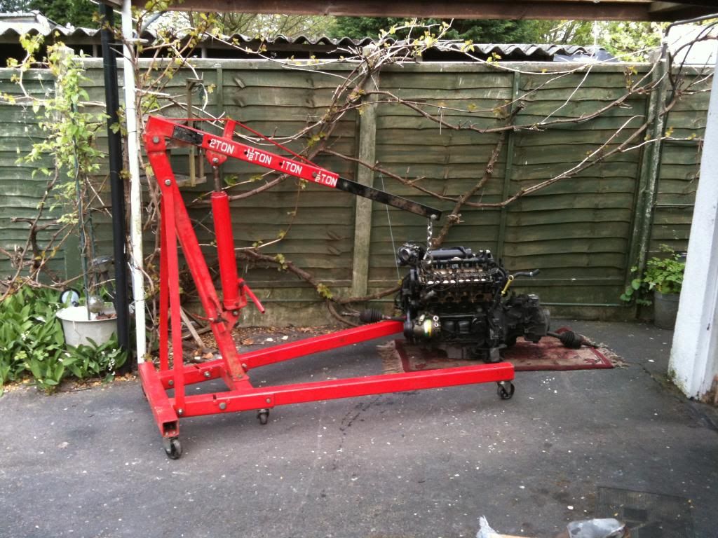

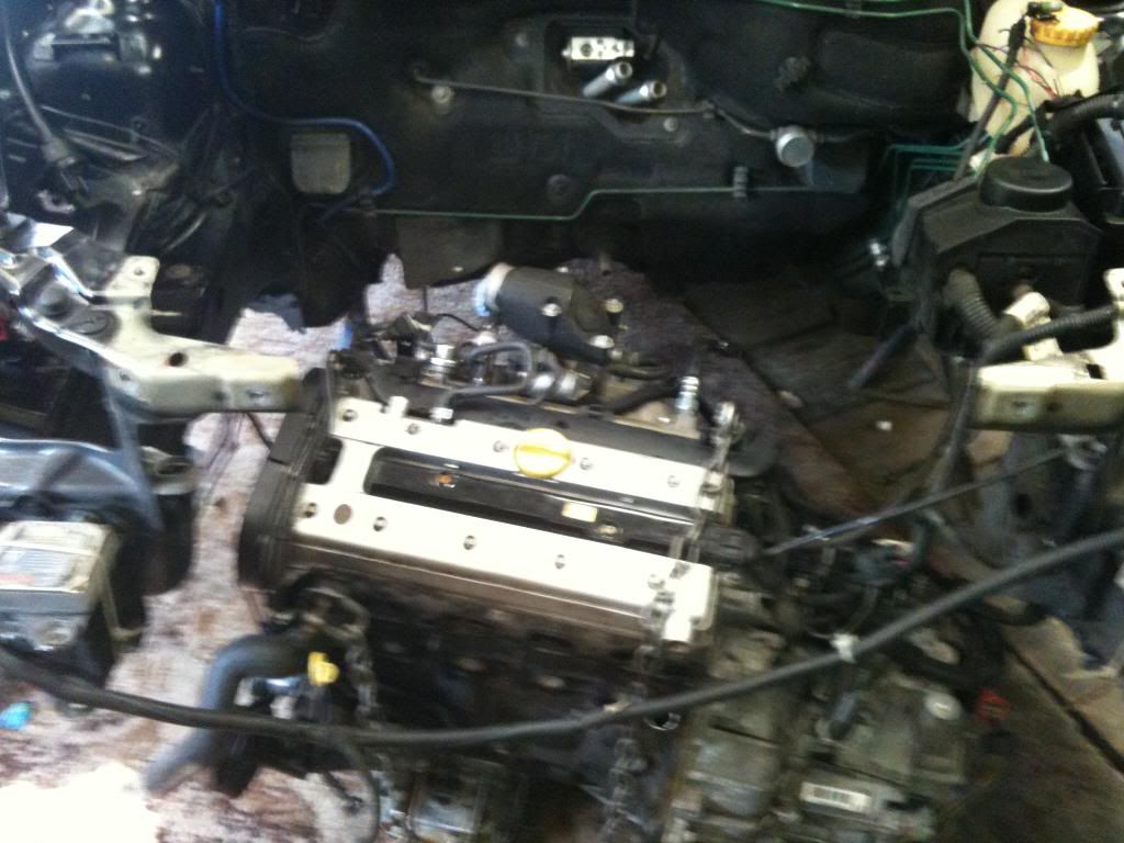

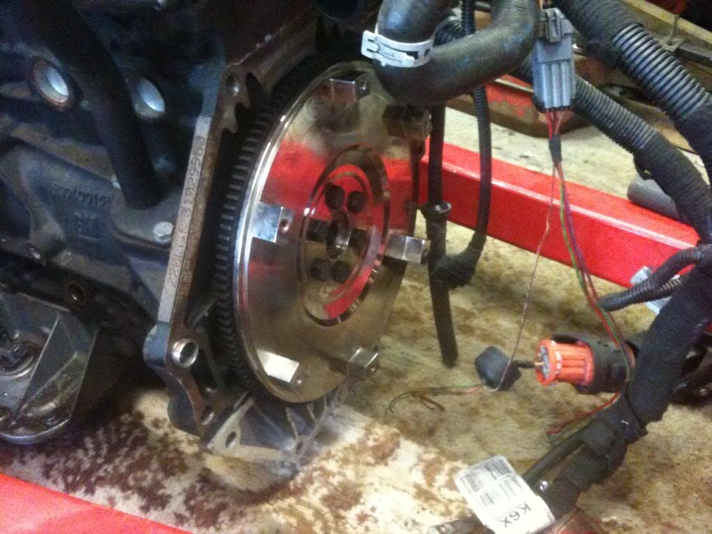

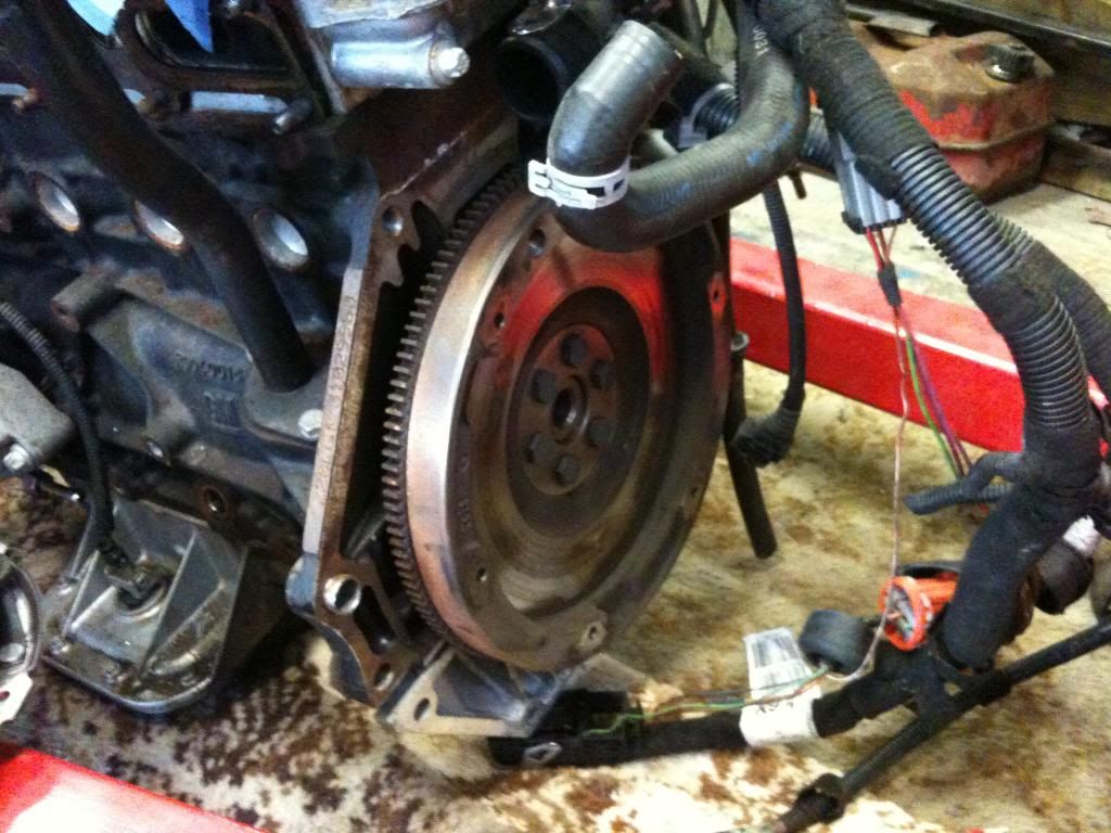

Gearbox off and fitting new flywheel
Nearly ready to go in

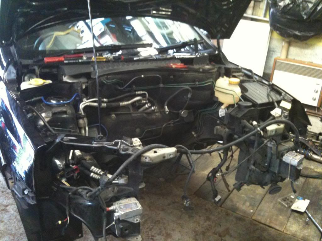

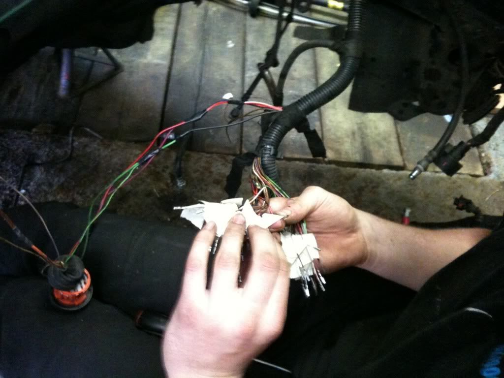

Wiring :o

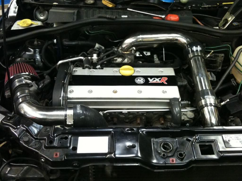

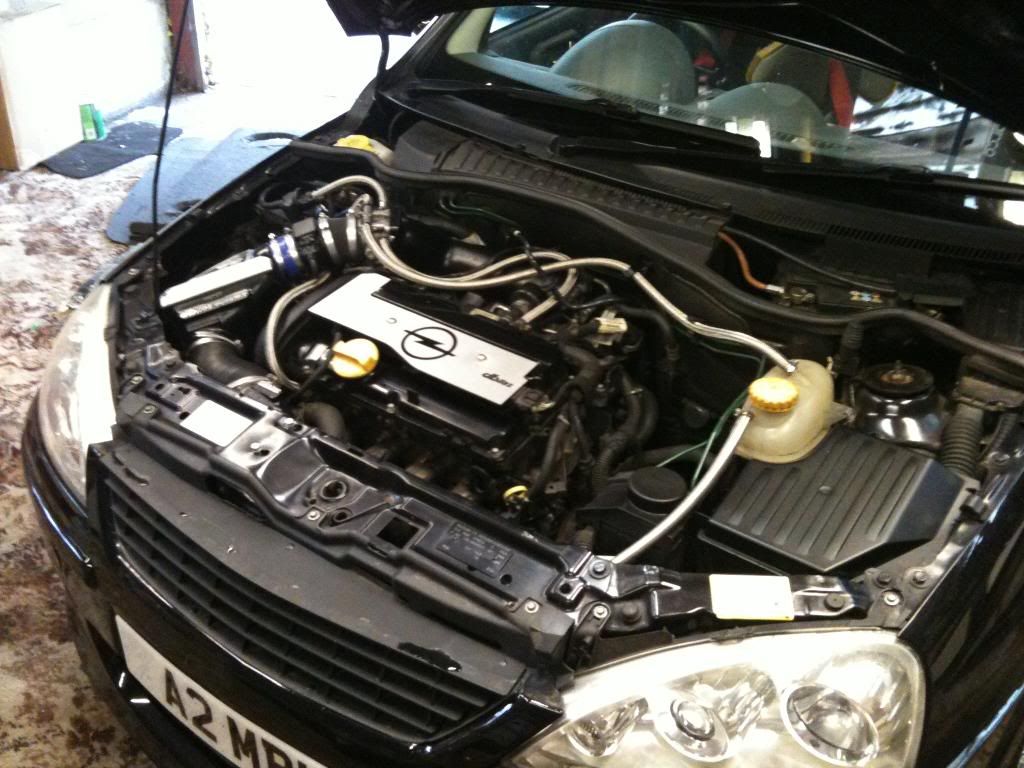

All mounted up with some boost pipes fitted

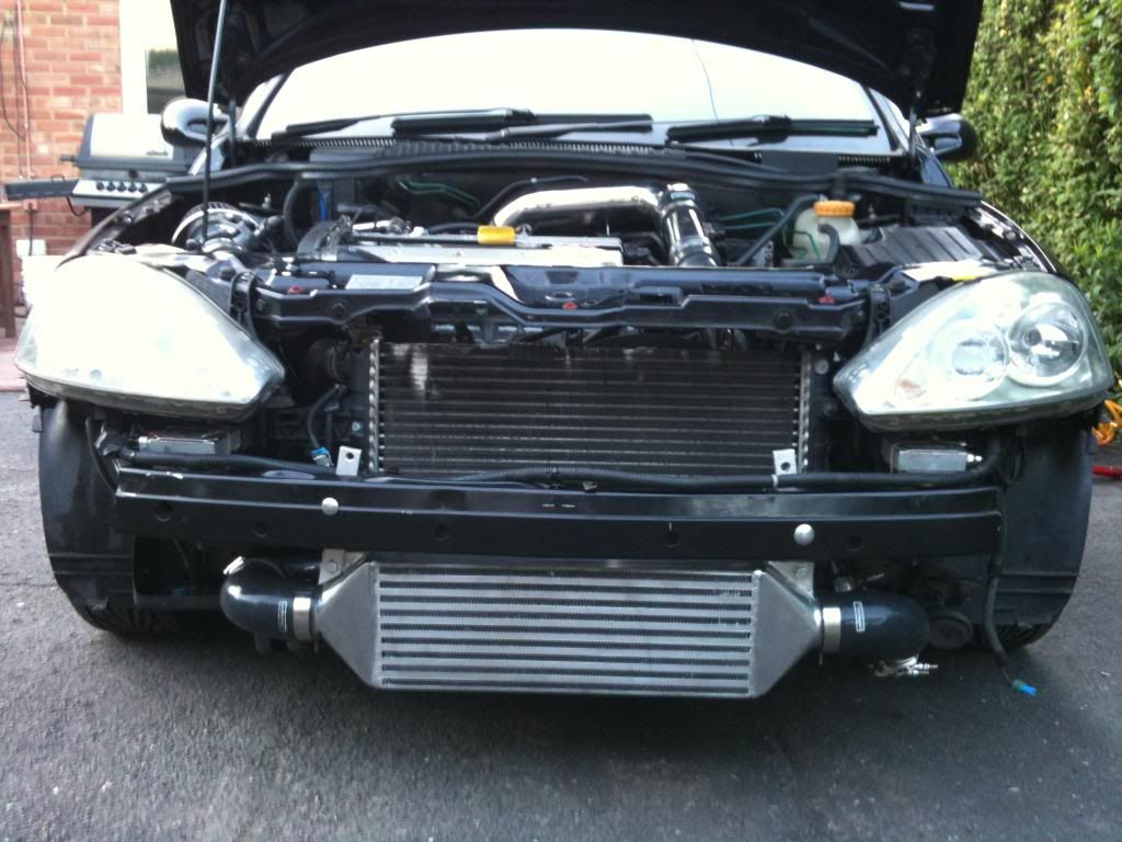

Intercooler mounted
Random pic of engine

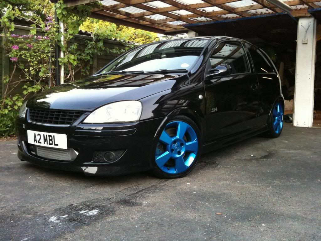

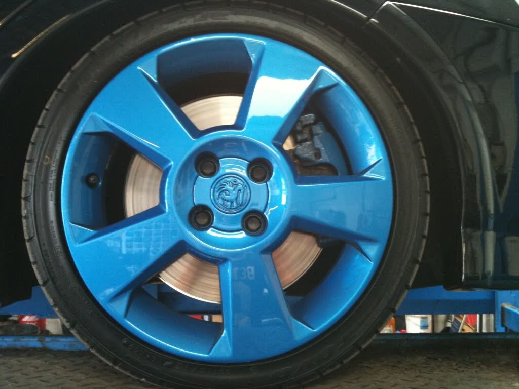

The car itself all back together with the freshly refurbed wheels in Arden blue

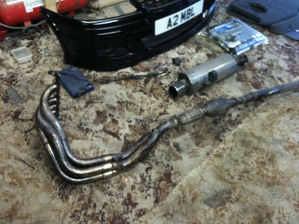

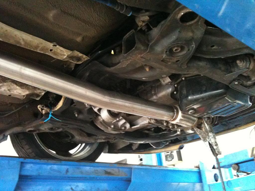

Getting an exhaust made up, no cats and one silencer!

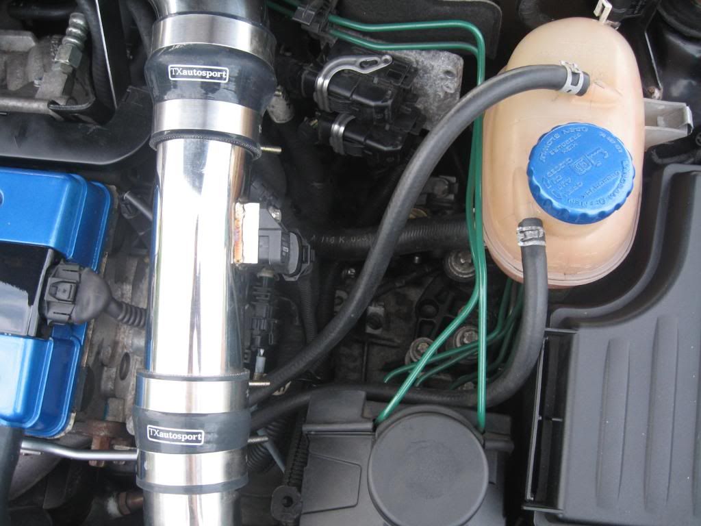

Fitted a collins -31 cosworth actuator, also has the rocker cover painted arden blue

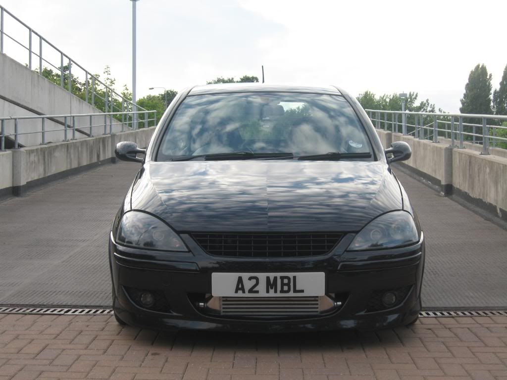

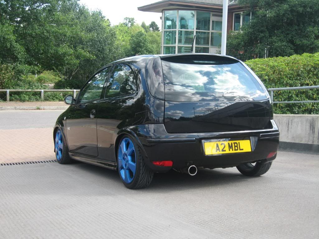

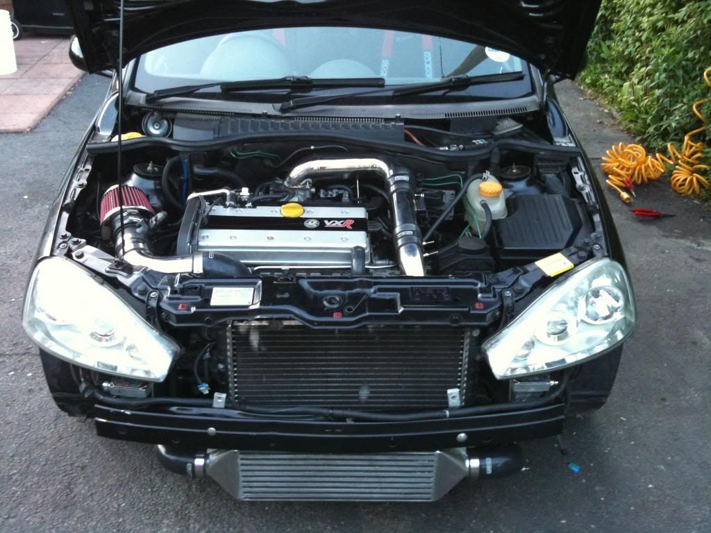

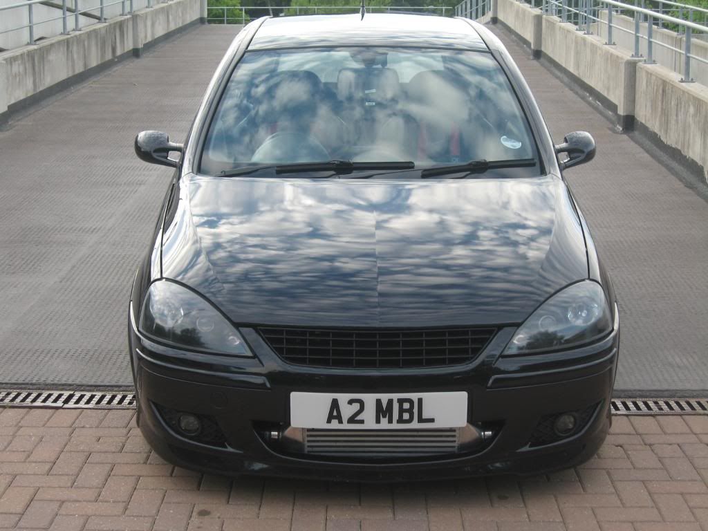

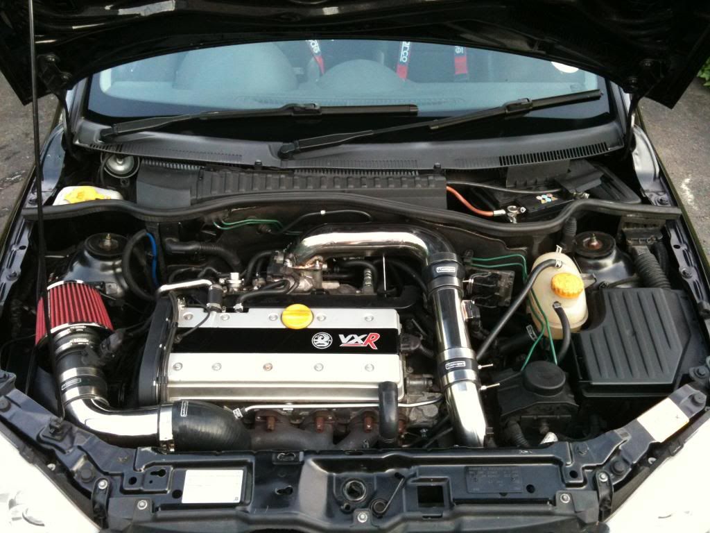

And how she stands today!
It's been mapped to EDS Phase 3.5, in addition to the bits I've said about above it also has an X20XEV inlet cam :) should be around 280bhp if not more

Great job. thumbsup Not keen on the wheel colour though.

got to be one of the tidiest corsas i have ever seen, would have kept the wheels silver though, just to make it look even more standard ;)

Fair play doing the conversion yourself ;) - as it is the LET not LEH engine did you remove the balancer shafts also? Def worth while on the vx if the engine is out especially. What diameter exhaust did you go for? Can be a restricting factor on the vx above 280ish bhp Not sold on the inlet cam swap fully myself but Regal love to sell it :P :D I think it would have looked better oe mirrors and wheel colour but that just my view :) My R5 turbo with 1.8 20V turbo vag engine / box transplant was running about 270bhp and even with a diff had a hard time - before the diff it was just a waste of power lol - def money well spent though Keep up the good work ;) DG

Looks great, but not sure about the blue wheels
DG
I was originally going to but Courtenay were having trouble getting the parts so I didn't bother
I wanted a 3 inch exhaust but everywhere I went refused to do it, so had to settle for 2.5 inch
The mirrors are OEM ;) SRi's come with them as standard...they're not crappy M3 mirrors!

Yeah didn't think many people would be :lol: makes it stand out from the crowd though :)

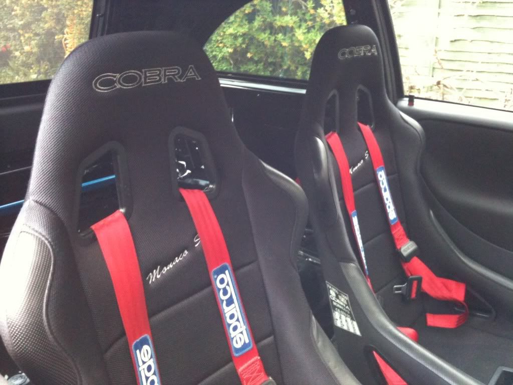

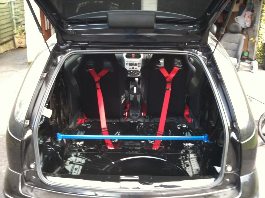

Get a cage, or dont use harnesses and bucket seats. Seriously.

What's wrong with harnesses and bucket seats without a cage? As long as they are mounted to strong points with weight spreading plates should be fine. Or is it just a visual thing?

Car rolls, roof comes in, you cant bend out of the way = bad id say
