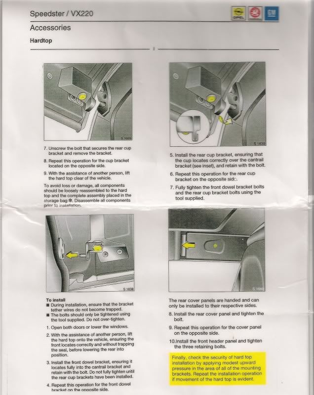

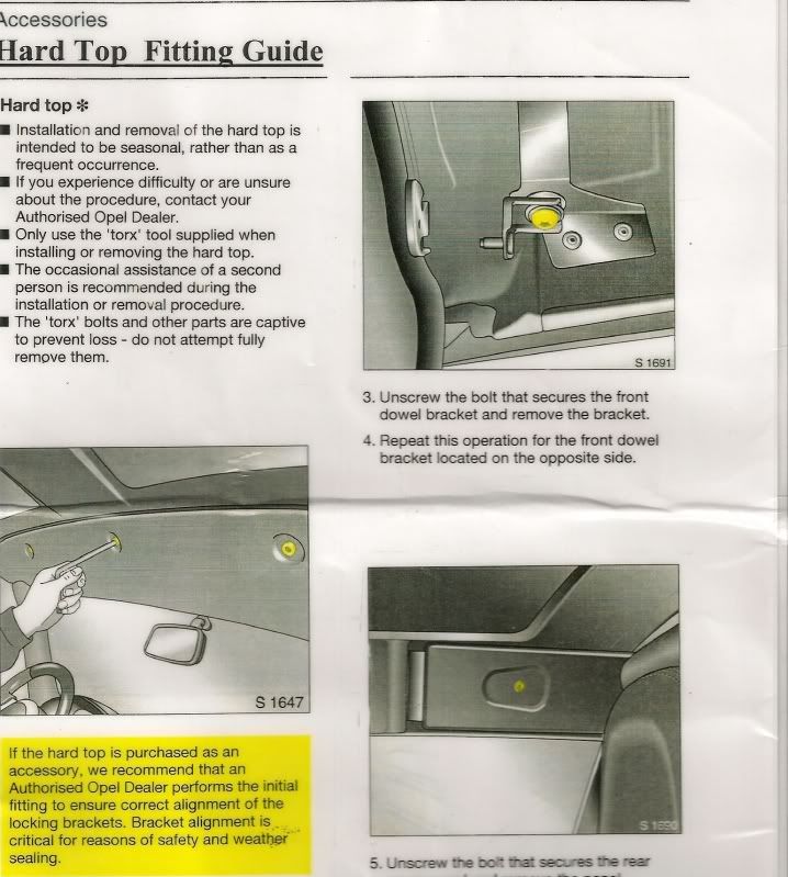

You can not really go wrong fitting it but this may help chinky chinky
