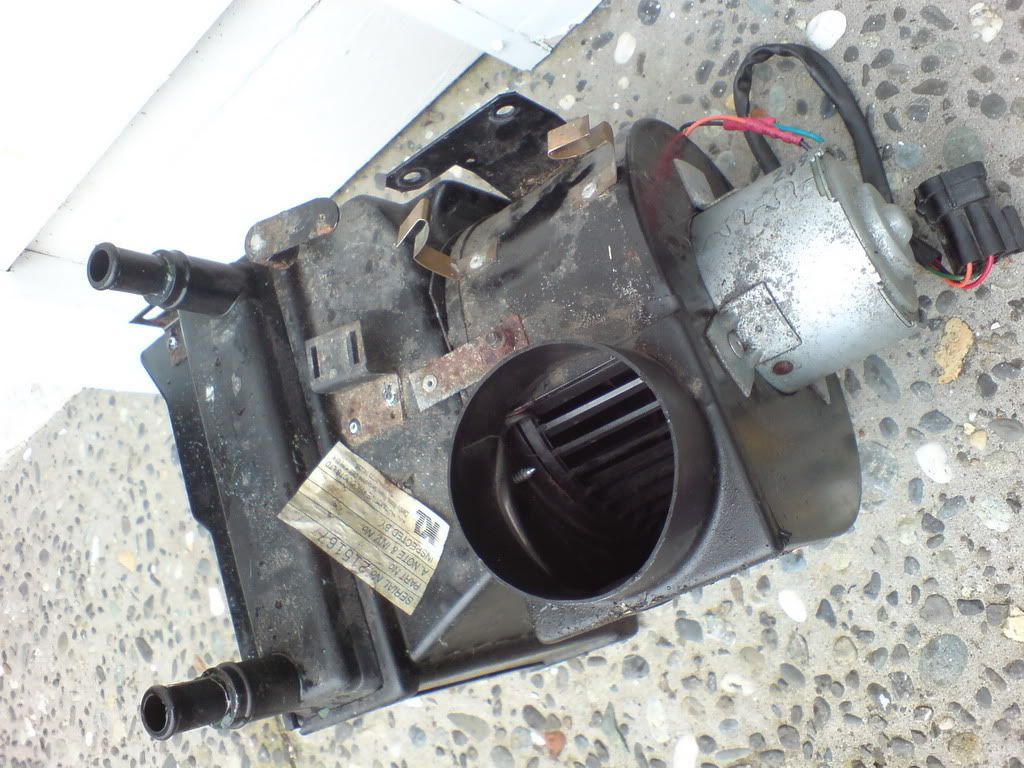

Before I seal up the heater box I thought I would see if there was maybe a better replacement to the fan so googled the model which took me to some obscure parts site here and here for none other than the....Land Rover Defender :blink:
The Lotus boys were having a good laugh the night they designed the bloody heater! (at the pub no doubt :D)

The heater unit in the VX is the same as the one in the early S2's (without A/C), but in both cars the unit itself actually originated from air-conditioned S1 Exiges and elises. The heater is the 'heater part' from the A/C unit in the Exige with the evaporator unit removed. Because on the S1 Elise and Exige the battery is also in the front, Lotus had to use a very small heater/AC unit in these cars and as a result it did not work very well for either heating or cooling. The original (non-A/C) S1 heater is quite a different beast. It can heat up the car without problems, but their design weak point is the fact that they have a metal housing which rusts/rots in the relatively exposed front compartiment of cars like the Elise. Current S2 Elises and Exiges use a completely different heater and A/C system that pretty much fills the entire front compartiment and in the case of the VX would only fit if you moved the battery to the back. An additional complication here is that Lotus switched to electrically operated air-flaps in the new unit and no longer a cable operated system, so it needs additional wiring and the control box to work. Oh.. And the new heater also needs modifications too as Lotus, in their infinite wisdom, fitted the resistor pack for the heater fan control at the underside of the unit so it sits in a puddle of water most of the time and fails quite quickly ;) Bye, Arno.

The matrix is actually fine..... With MK1 of my heaterbox rebuild it was actually far far far far far too hot :lol:
Its just the airflow routing through the matrix that is utter tripe and causes the issues.
I'll try to get mk2 made and trialed in someones car to see if thats any 'better' (in terms of being inefficent to the level that its better than std but not as hardcore as MK1)
