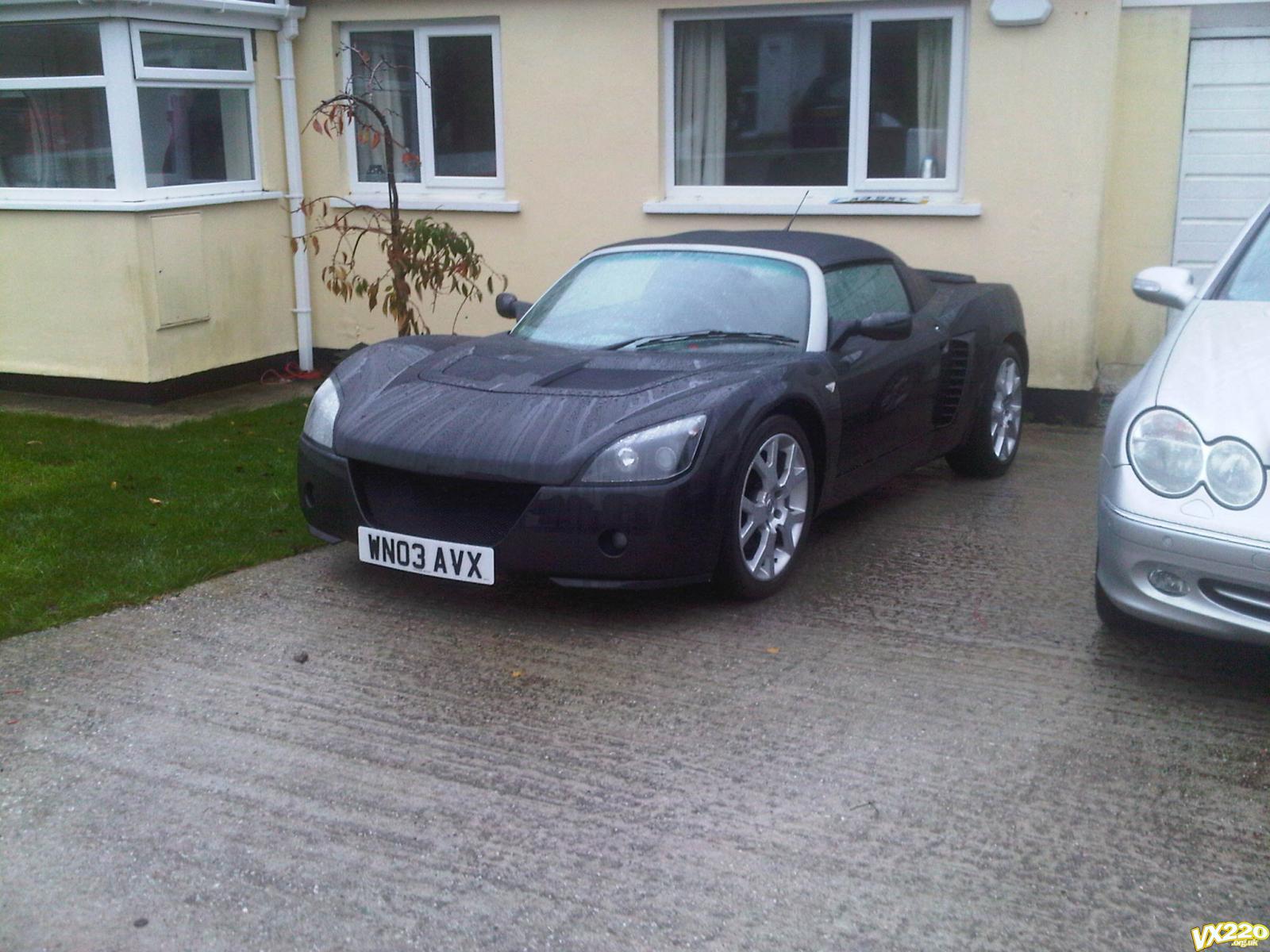

Im wary of going somewhere else as the garage i normally use always gives excellent results, below is my car painted and at home, couldnt get any better shots today as its been raining.
Just Need the V grill to finish.
Edited by moneyhunster, 14 November 2010 - 06:23 PM.

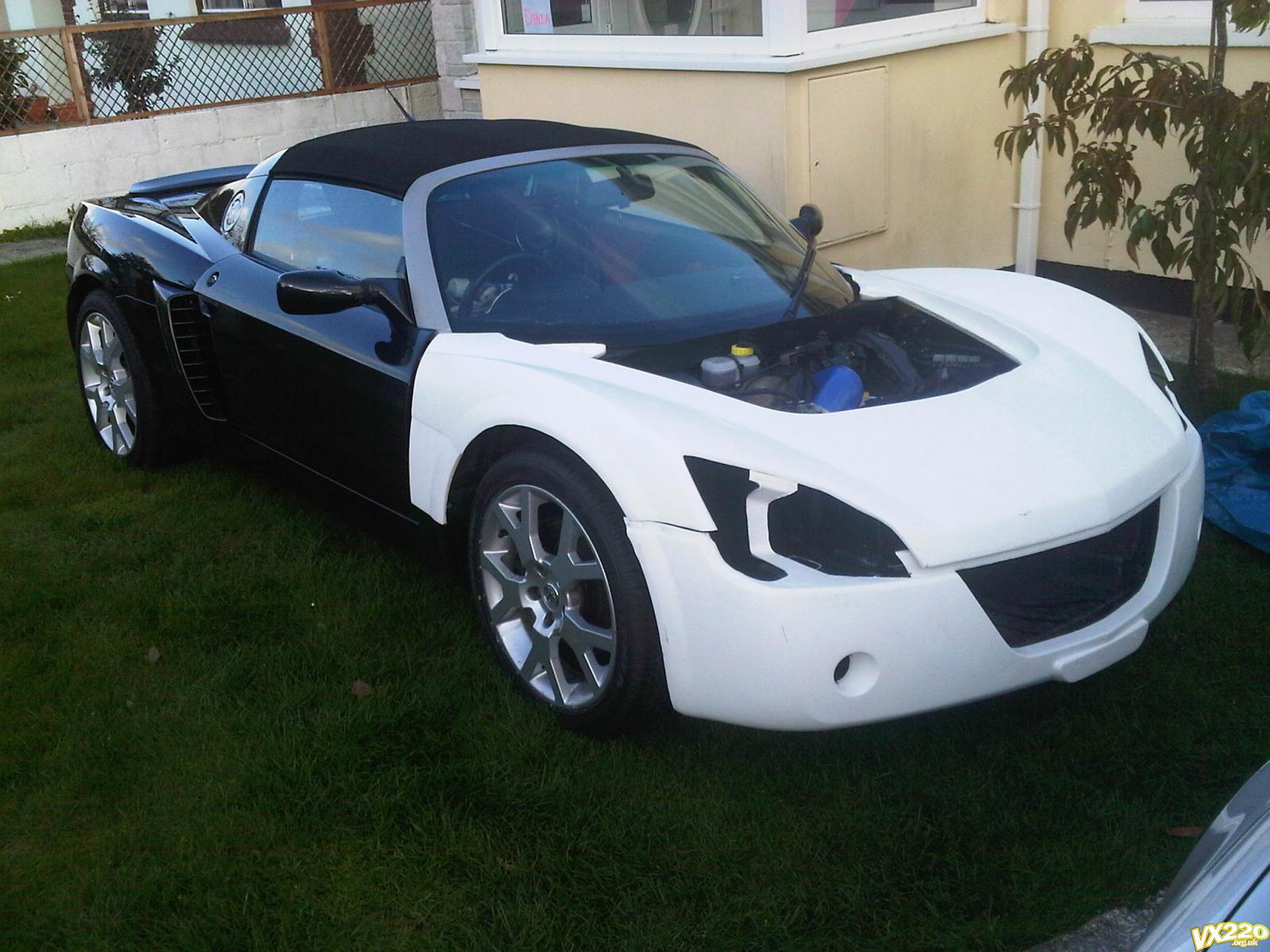

It was 60 hrs time they finished and About £900 to go from this
to the picture above. A lot of time was spent in the glueing together and aligning the bonnet.
I sent MVS an e-mail to see if he can arrange to get the clam up to paint stage by someone close to them, waiting for a reply.
