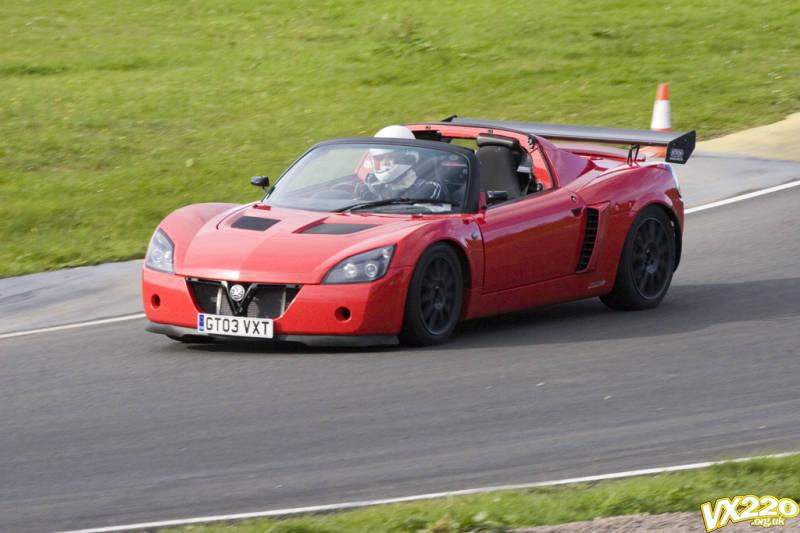

Couple of photos of wing fitted to my car. The height was set low as it was my first track outing with it fitted.

Posted 13 December 2010 - 04:09 PM
hi, many thanks, have you got a picture of the rear? (ooooerrrr :lol: )

That was my first track outing with the wing fitted, so I went pretty conservative on height and wing angle. The adjustable bracket allowed another 4-5 inches of height and an extra 3-4 degrees of angle. Plus I'd drilled several holes in the mounting plates to give me more flexibility on height adjustment. Even at the low settings the wing was giving me 5-10 mph more corner speed. Never got a chance to experiment with it properly but with he other modifications I had it looked as though I could easily knock 3 seconds off a lap at Knockhill, which is a big chunk of a 60 second lap.

How was it to fit? I'm guessing you went through to the subfame?

Yes, metal plates bolted to the subframe and slots cut in the clam for the wing mounts. The plates also doubled up to secure the rear clam as I had removed the boot section much like the latest mod Rapidos has posted in the user gallery section here.
If you are keeping the boot then Nicolae posted some photos of his wing supports last year here. A much neater solution and easier to revert to standard without too much fibreglass work.
